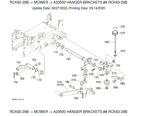

The mower raises and lowers with the 3 point hitch. Don't know if you were talking about the mower height adjustment knob or the or the lowering speed knob. See attached pic
If the 3pth goes up and down you will need to check the linkage for the mower deck to see why its not dropping.
