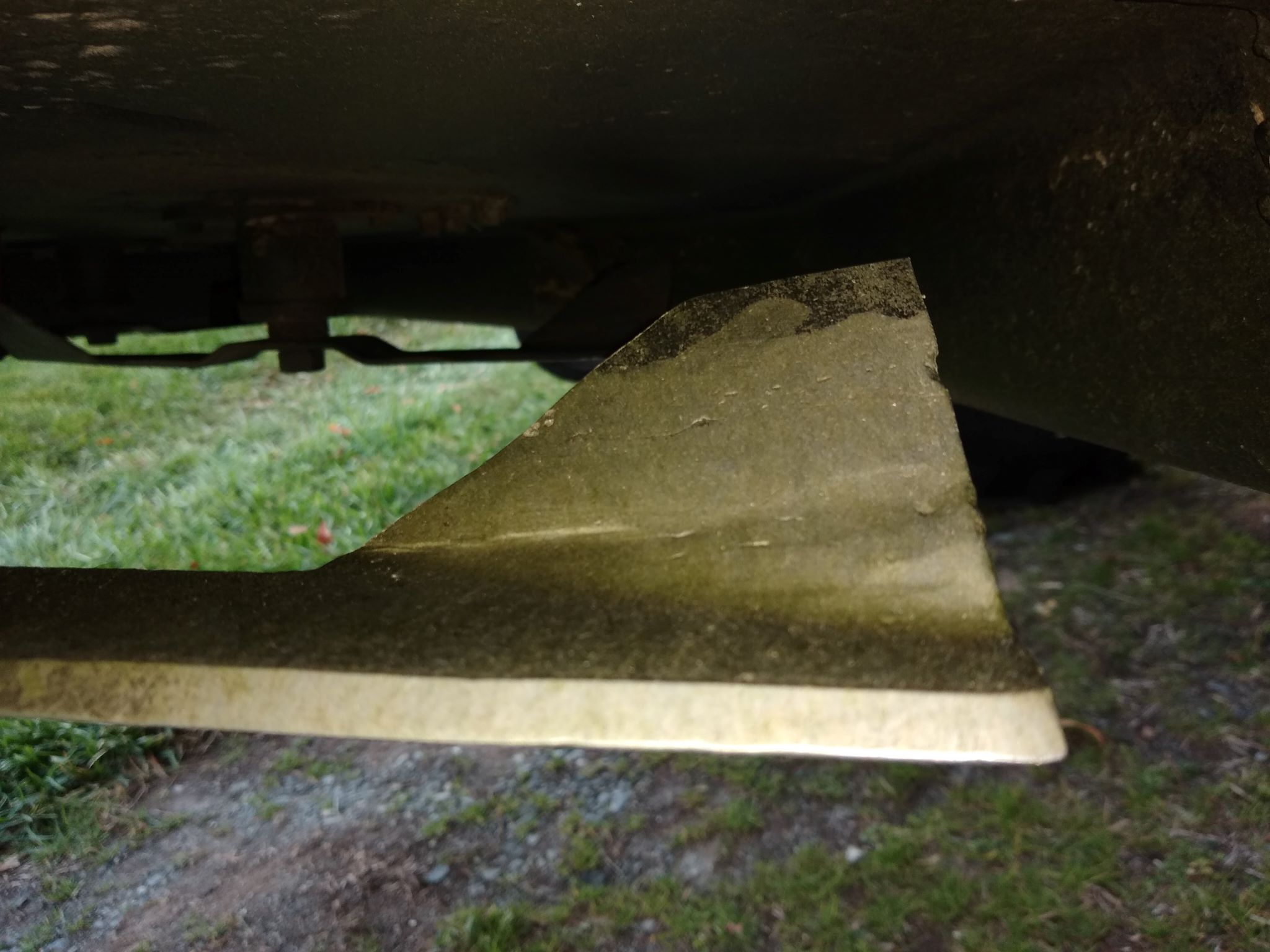

I made a set of blades with extensions on the flipped-up "wings" for my old 5' side discharge deck and they do better on leaves than anything else I've tried. Here are a couple pics from a few weeks ago when the first batch of leaves came down. These blades chop the leaves to the point that not much of a wind row forms. As the mower progresses away from the areas of heavier leaf deposit there's eventually nothing left to mow/'blow.

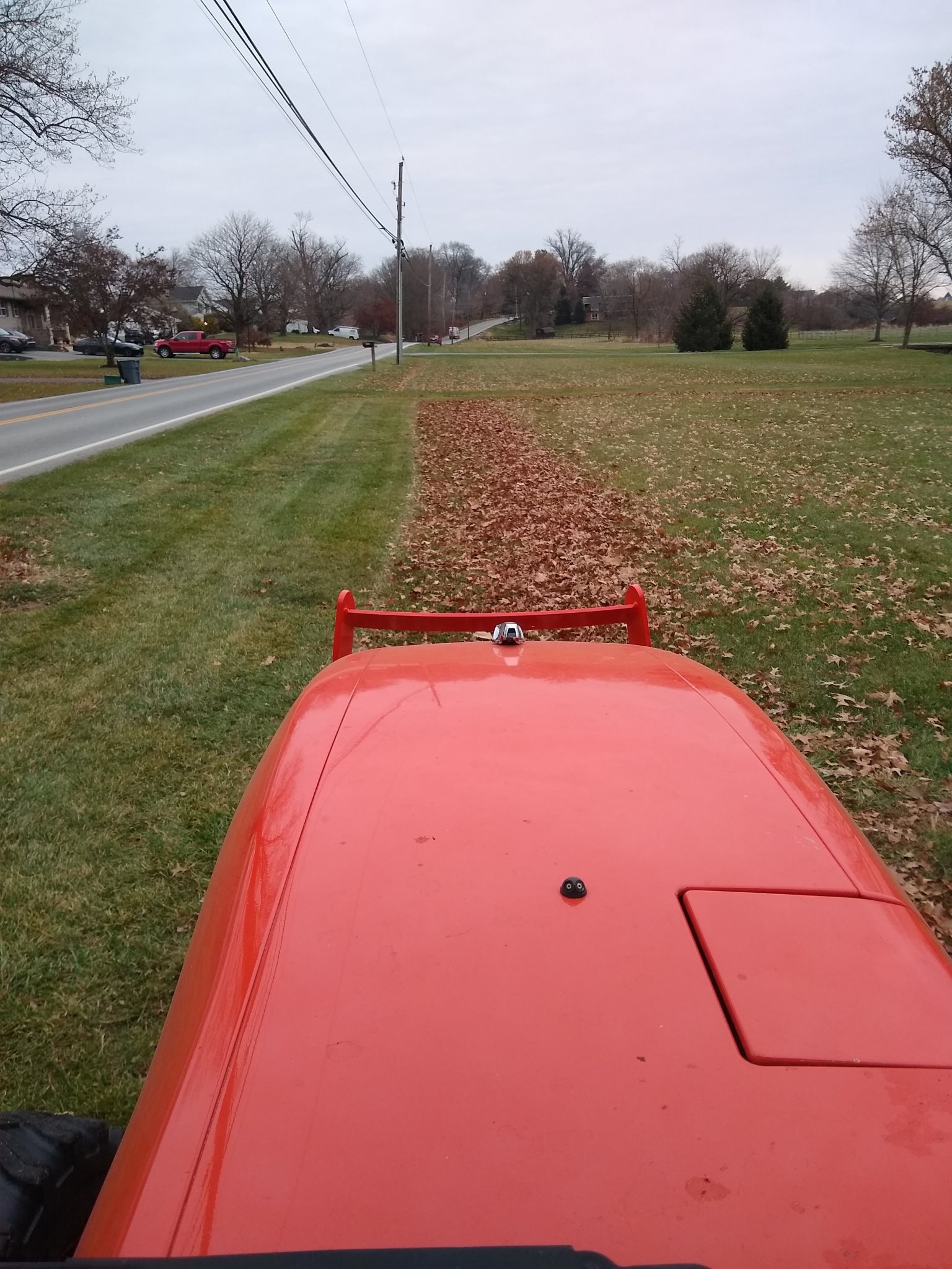

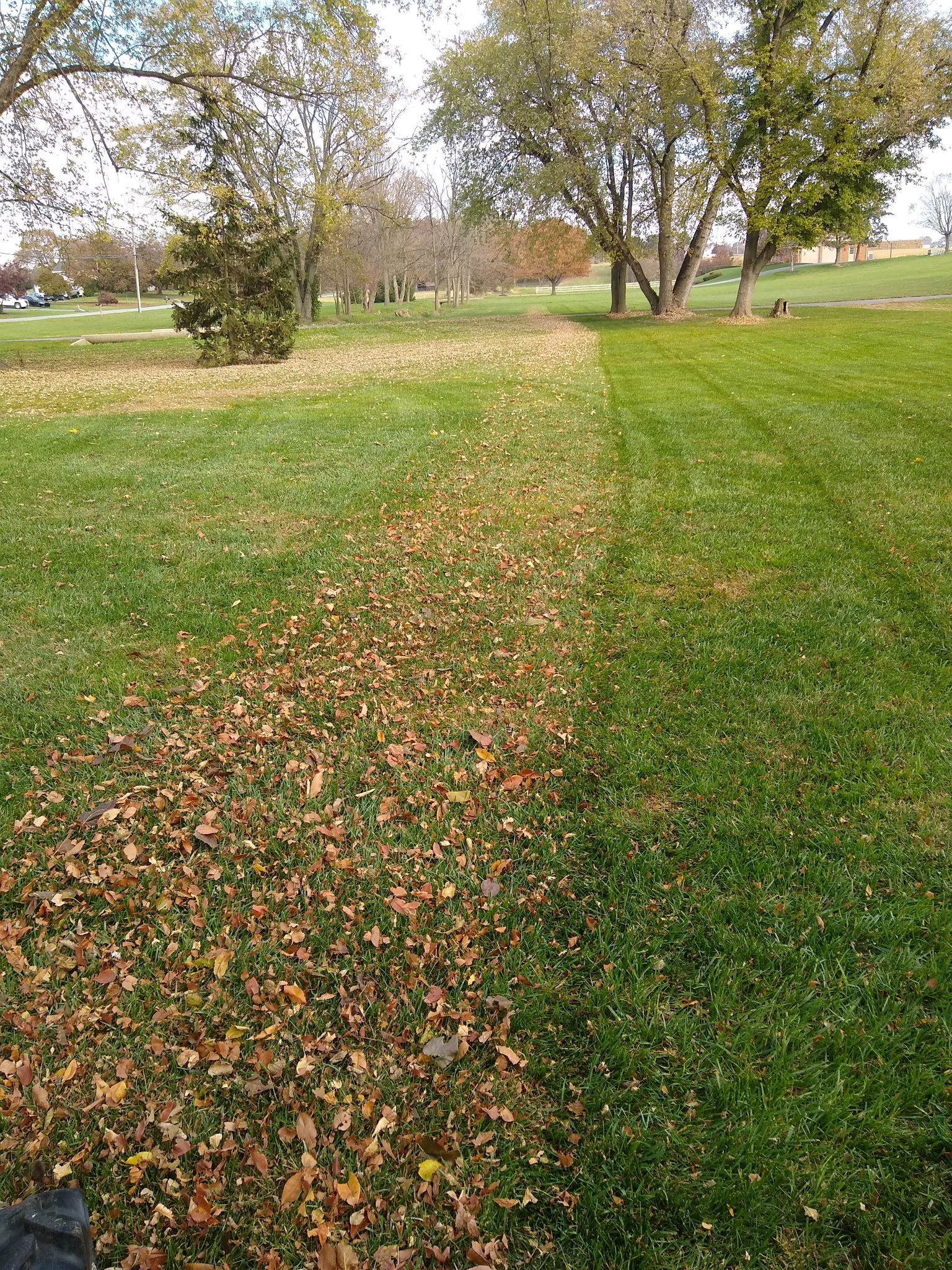

Here's a little better example of the blade performance. The post from Monday was using the little Ford 1210. Th weather turned sharply colder here, so I wussed out and put the Ford's 5' deck on the Kubota to take advantage of the cab. There was a brief learning curve because the Kubota always has the 7-1/2' deck for mowing. Sweet Pea questioned the setup right away - "Grandpadaddy, why that blue on the tractor?"
Anyway, this part of the yard is between the road and the creek. With the prevailing winds I get a lot of oak leaves from across the road with the heaviest deposits near the road. The first picture shows the wind row after a few passes.
The second shot show what's left of the leaves with only a few passes before the creek. This afternoon/evening I spent some quality time grinding up the rest of the leaves.
