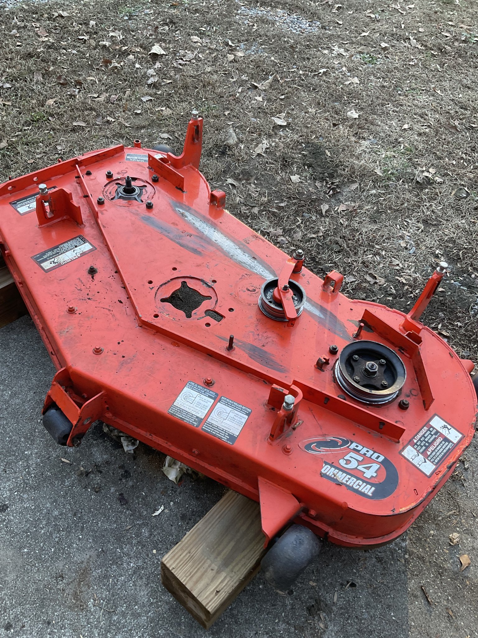

Update 14 Dec
I got the deck off today. Had a neighbor come over with his tractor. Anyway, I was not able to measure the distance from the cent spindle to the left and right ones. I did get the center spindle and pulley assembly out and clean the top and bottom of the deck tomorrow. Again, I didn’t see any obvious damage to the deck or center assembly. I Will update tomorrow or Saturday.
let me know if there’s anything I should look out for.
Thanks to all.

Update 19 Dec
The seal for the gearbox was leaking so I changed it out. I measured the spindle distances. Center spindle to left spindle is 18 1/4 inches. Center spindle to right spindle is 18 3/16. So, it’s definitely a little closer.
I see no signs of any damage to the deck or spindle assemblies.
One side of the right blade still hits the center blade. I’ve rotated the right blade and the other end clears the center blade. I also rotated the center blade and it still hits one side of the right blade. I switched the left and right spindle assembly again and the symptom is the same. I replaced the shaft and bearings in the right spindle - even though I didn’t see anything wrong. The blades still hit.
I give up. I’m taking the deck to the Kubota dealer tomorrow. I talked to them today and they said they’ve seen blades hit and it’s usually a bearing or the deck. I’ll let them check everything - who knows , maybe I missed something. They did say they have ground the edges of blades before. I could have done that, but I really wanted to figure out why they are hitting.
I’ll update this when I find out anything.

Your deck is bent, I see several a year. I just installed a completely new deck under a BX2360 three hours ago.
Remove the blades and lay a straight edge across the flange on the three spindles. That will prove it.
You were right. I had already taken the deck to the dealer before I got your email. I was surprised how fast they diagnosed and fixed it. They said the deck was bent “ever so slightly”. They shaved the center and right blade and all is good now. They only charged for 1/2 hour labor. I brought it home and remounted the deck and made a test run. It cuts fine.
I still don’t understand why both ends of the right blade don’t hit the center. I would think that if the deck is bent, but the spindle assembly isn’t, that the blades would hit on both sides when rotated.
I also don’t understand how I could have hit something that bent the deck, but did not bend/damage the blade, shaft, and/or the bottom flange/holder assembly.
Thanks for the reply and verifying the problem.
