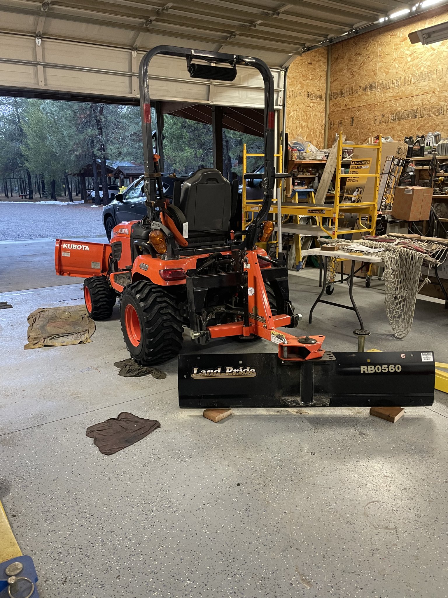

We just got about 20” of heavy wet snow, and it was just about raining slush, with high 30’s temps expected. This is terrible conditions for using the snow blower. It would definitely clog and blow shear pins regularly.
Using my little BX25D, with a front hydraulic blade and a rear QD blade at a 45 degree to scrape the road and clear off to the side. Keeping the front blade angled but about 2-3” on the ground, it pushes the majority of the snow off, the read blade only having a few inches to move, scrapes it easily, without clogging up.
Using one blade or the other, this heavy wet snow pushed the little BX around, but with both blades on the ground, it gives me a much longer foot print, and really plants the tractor to the road.
Most of the time in early season, it’s cold and dry snow, and I only use the blower. These are similar to March warming conditions with snow overnight and rain during the day.
Unfortunately you must clear the slop, or it freezes in ridges and makes future snow removal harder, and terrible road conditions. The double blade system work well in these conditions.

Glad it’s working for you. Been considering this option. Can you post a picture of your setup?

This snow dump was warm and wet. Absolutely no way to use the blower. It’s almost all gone now (still raining) and in the 40’s. I’ll get a pic of the 2 blade set up as soon as it’s light.
This is the first year I have had to start with 2 blades, it’s usually march warming that is like this.

Im not that familiar with front blades, being in a place where it never really snows, but it sticks out to me that ive never seen another front angle blade with as beefy a cutting edge as that. Am i just lacking context or is the kubota front blade actually unusual in that way?
The factory edge is steel (1/4" I believe), but they also offer a 1/2" poly option. I have found that an aftermarket 1" rubber edge works well for my gravel driveway, but I purchased a 1" urethane edge to try out this year (if it ever snows here).

There’s 1400’ of gravel down my driveway to the road. Normally I would have the snow blower on the front hydro shoe. I knew with the back and forth of snow and rain, the a few hours of wet little ice balls, it would not blow very easily with the snow blower. Once it jams up with ice, it blows out the top chute pin. Not the main auger pins. It just can’t lift and throw out the wet sticky stuff.
I believe by using two blades at once, to cut the snow load in half, the tractor doesn’t get pushed around like I do with only one blade on the ground.
The cutting edge on that BX looks more like 1/2-5/8” in the middle.. like what youd find on a box blade or rear angle blade. Thats what stood out to me.
