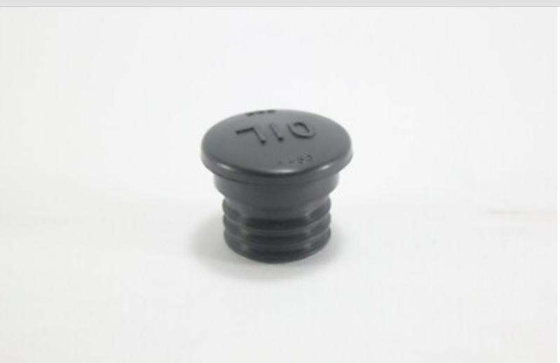

There’s a plug on the left side right by the dipstick. Pulls out, does not have threads. Kinda gotta use a flexible or bent funnel to get in there or the oil makes a mess.
Looks like this but probably does not say oil on it

Thanks. My daughter and son in law borrowed my machine, and they're an hour away. He checked the oil and noticed it was a lil low. I thought the cap said oil on it, but it doesnt. I tried to describe it to my SIL, but didn't wnat to take a chance putting oil where it didn't belong.
