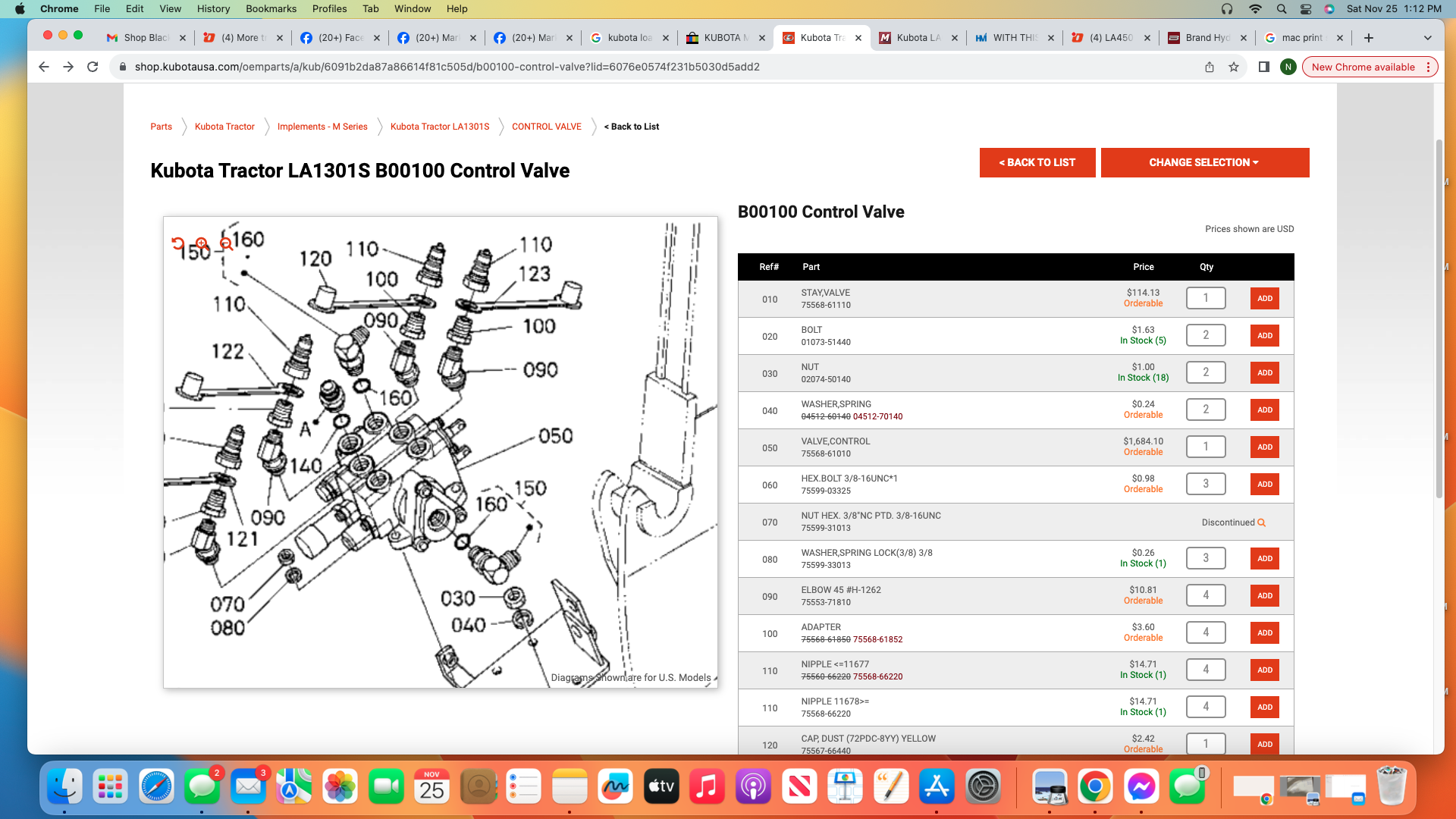

Sorry for being a little dense. It looks like poppits are under the connector for hoses.
Load checks are in the valve body between the service ports. I cant tell exactly where they are installed from that diagram but I am pretty sure thats the load check. What else could it be?

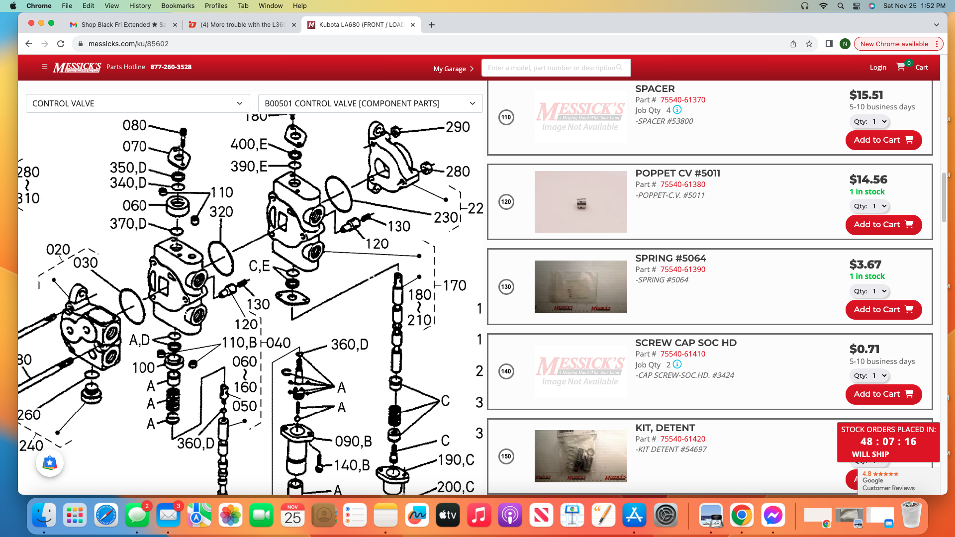

You have to split the sections like the pictures to get to the load check poppets, they are on the sides of the valves.
