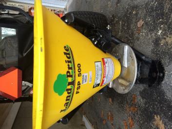

Hello all, thank you for your help and guidance. I am appealing to the orange tractor gurus for advice. I just moved into a house that has a 1400 foot asphalt driveway which I plan on snowblowing with my bx2670 and a bx2755hd snowblower. I upgraded from a bx1870 and I'm happy with the extra hp but have yet to see snow. I plan on salting/sanding the driveway so I picked up a land pride fsp500 slightly used from Craigslist. I tested the mix (6:1) sand/salt and the problem is that the salt/sand mix bridges at the throat and doesn't come out of the shutters onto the spin plate. The salt in the mix sucks moisture out of the air and is always kind of damp, even though I have it under cover. I'm looking to get some innovative ideas about mods to the spreader. I've ordered some additional trap door shutters and slide brackets for the bottom of the spreader along with a vibrator which I think I can mount to the hopper. I expect to get the mods next week. The agitator is spinning although the weight of the wet sand compacts it and it won't flow out. I'm wondering if you think I'm barking up the wrong tree trying to get this to work. I want to avoid a $2000 purchase of a wet sand spreader like a Herd. Your thoughts?

Thanks! My vibrator is on the way. After many interesting googles for vibrators I found an 80lb vibrator kit for a tailgate spreader. Mounting it on the cone hopper close to the bottom 1/3 I think will be the place for it. With a couple of metal plates to sandwich the plastic in between and trying not stress the radius of the plastic will be a bit of a trick. i don't want the vibrator to wear itself through the plastic hopper.

The 80lb vibrator kit from Russo works perfectly! I actually had to shut the flow to half and change the thrower angle. I'm thrilled that this is working.
Inside view... Am working without an agitator.. I installed a hitch pin just to move things around.

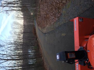

And the results. Yes... That's my brand new bx5455hd snow blower. Added an electric actuator from eBay for the deflector.
All in, $250 for the spreader from Craig'slist and $135 for the vibrator kit from Russo. A lot cheaper than a snowex or herd solution which run over $2,000.
