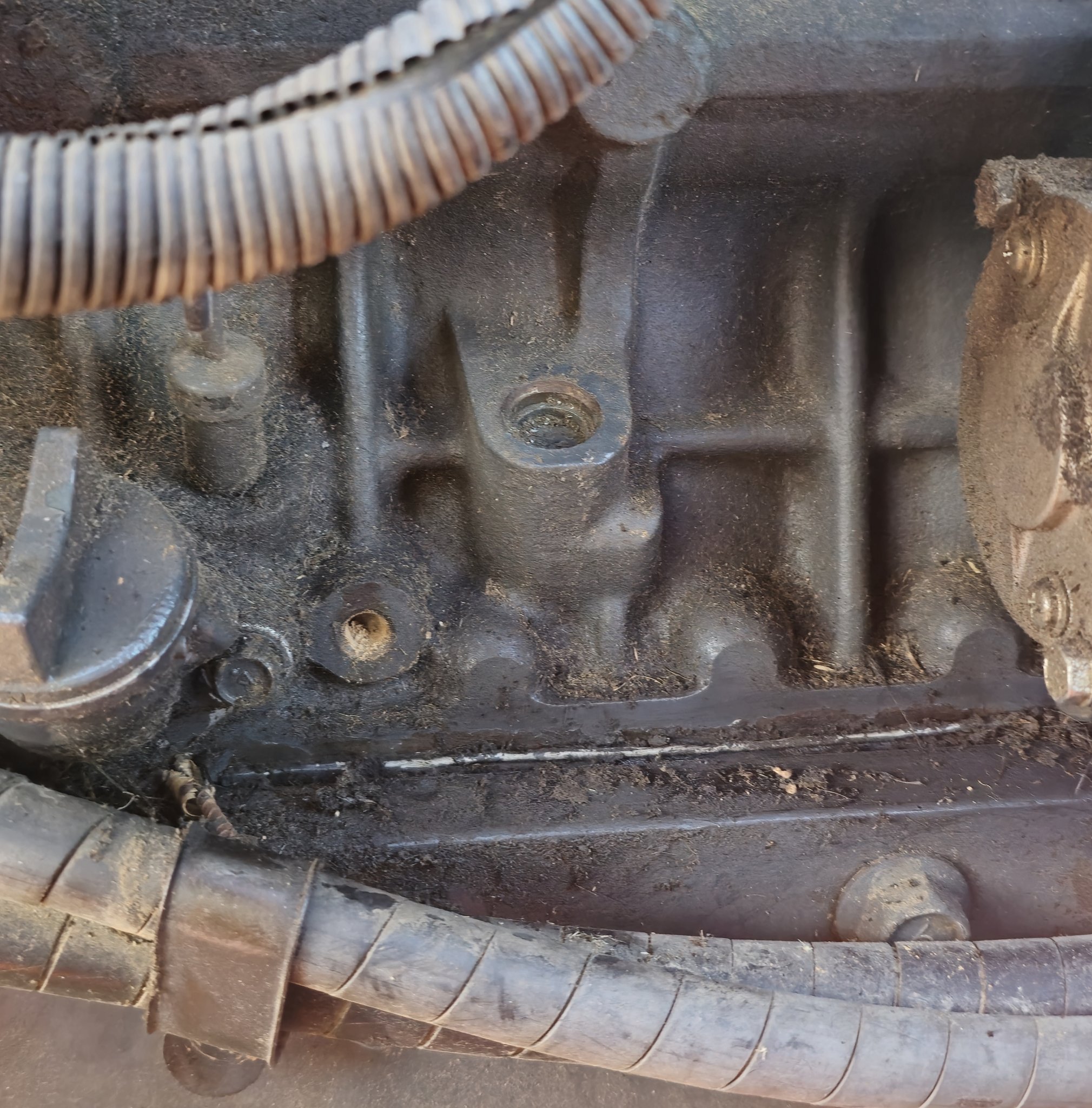

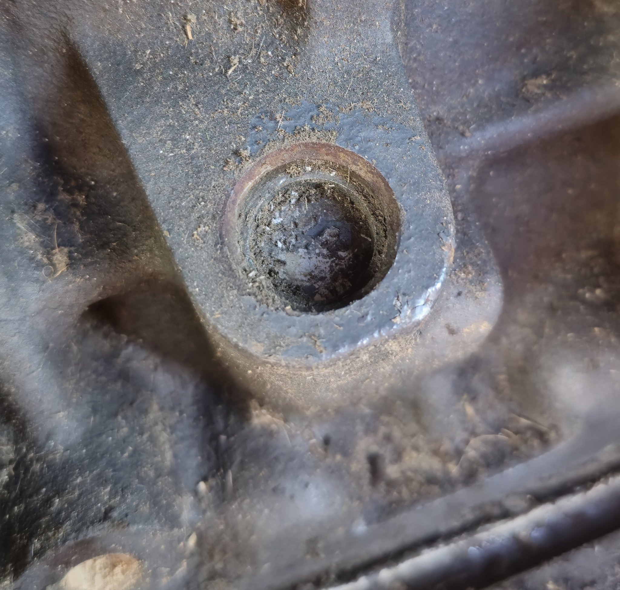

Almost have all parts i need to add a turbo to my M6800. Biggest issue so far is the oil return. This is where it's supposed to go...but it appears plugged. Does anyone know how to remove it? Im guessing from the inside and punch it out from the lower end?
34,211
9,396
Yep that's the return port, from the bottom is the easiest.
but you could use a dent puller (slide hammer) to pop the plug out if you don't want to pull the pan.
34,211
9,396
Screw point slide hammer. ;)
