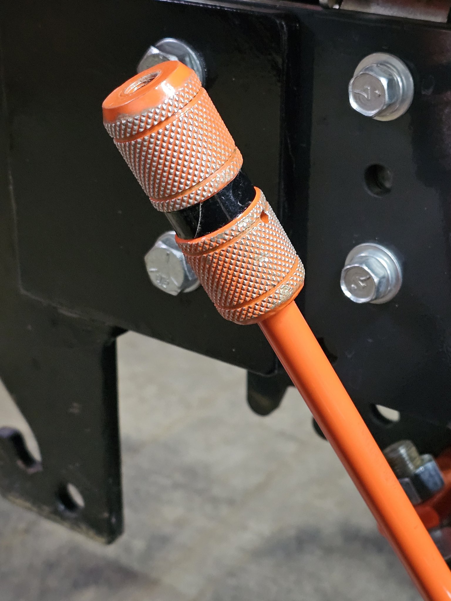

Trimley Well-known member Lifetime Member Equipment BX23SLSB-R-1 plus additions Jul 25, 2023 1,181 872 113 PNW-WA Oct 16, 2023 #1 The lock lever arm was threaded, as was the knurled handle. The knurled handle was screwed on, and is kept in place by a 1/8" roll pin. Much more user friendly. Last edited: Oct 16, 2023
Runs With Scissors Well-known member Equipment L2501 TLB , Grappel, Brush Hog, Box Blade, Ballast box, Forks, Tiller, PH digger Jan 25, 2023 3,364 4,293 113 Michigan Oct 17, 2023 #2 Looks very "grippy" for sure.
D D2Cat Well-known member Lifetime Member Equipment L305DT, B7100HST, TG1860, TG1860D, L4240 Mar 27, 2014 14,638 7,103 113 40 miles south of Kansas City Oct 17, 2023 #3 Runs With Scissors said: Looks very "grippy" for sure. Click to expand... Sure does! Have to wear gloves using that thing much!
Trimley Well-known member Lifetime Member Equipment BX23SLSB-R-1 plus additions Jul 25, 2023 1,181 872 113 PNW-WA Oct 17, 2023 #4 D2Cat said: Sure does! Have to wear gloves using that thing much! Click to expand... Nah, the "points" are shaved a tad to remove the bite..

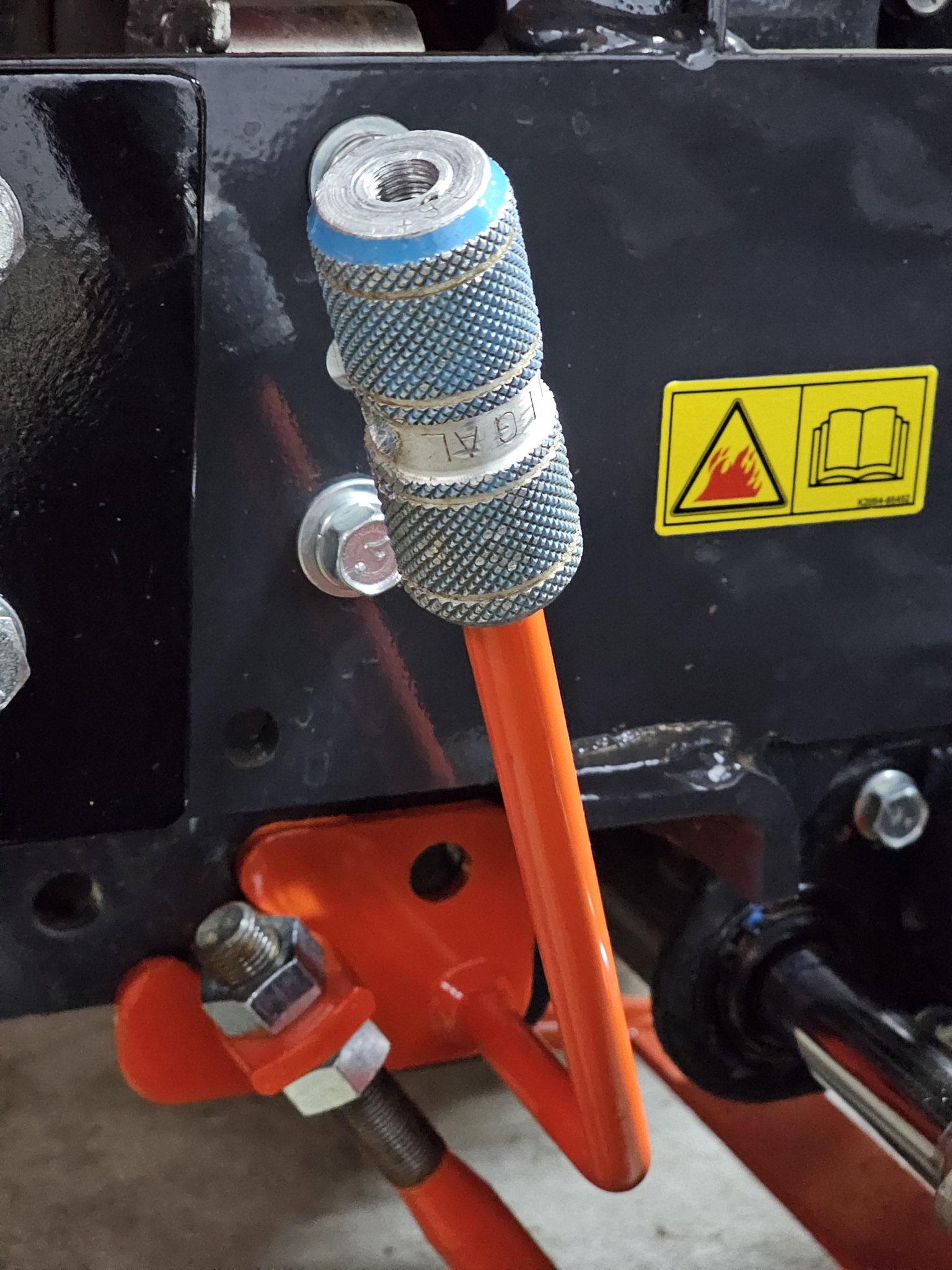

Trimley Well-known member Lifetime Member Equipment BX23SLSB-R-1 plus additions Jul 25, 2023 1,181 872 113 PNW-WA Oct 18, 2023 #5 Finished with a little paint. Done.
Runs With Scissors Well-known member Equipment L2501 TLB , Grappel, Brush Hog, Box Blade, Ballast box, Forks, Tiller, PH digger Jan 25, 2023 3,364 4,293 113 Michigan Oct 19, 2023 #6 Looks good.
