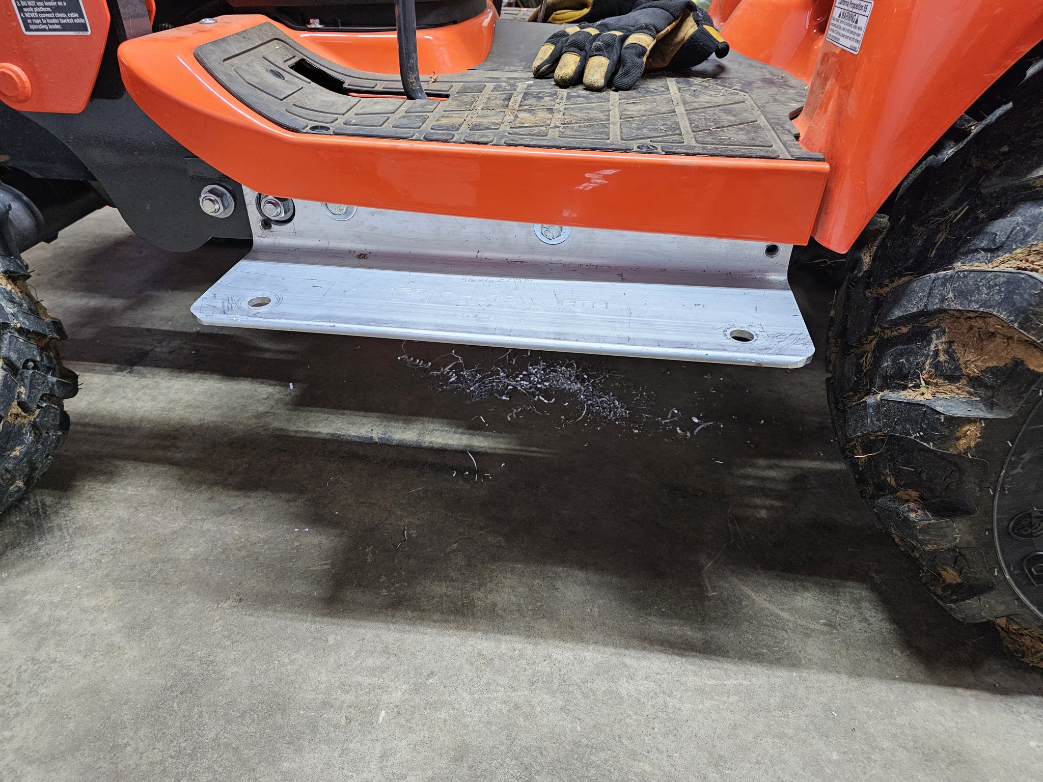

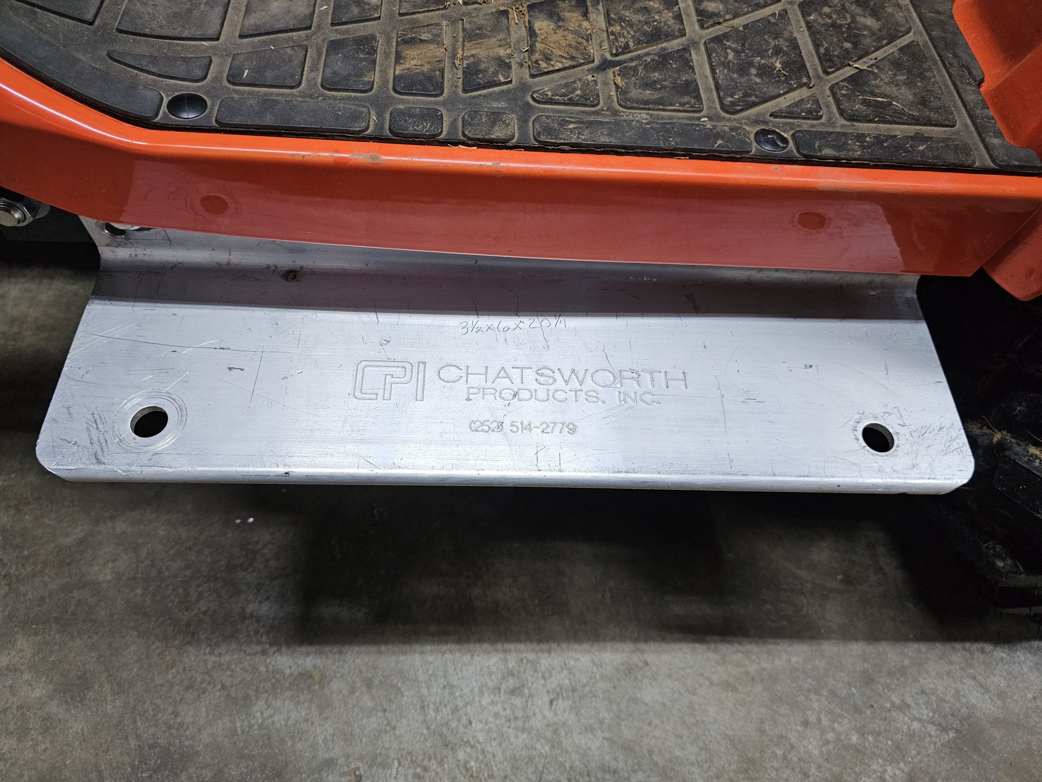

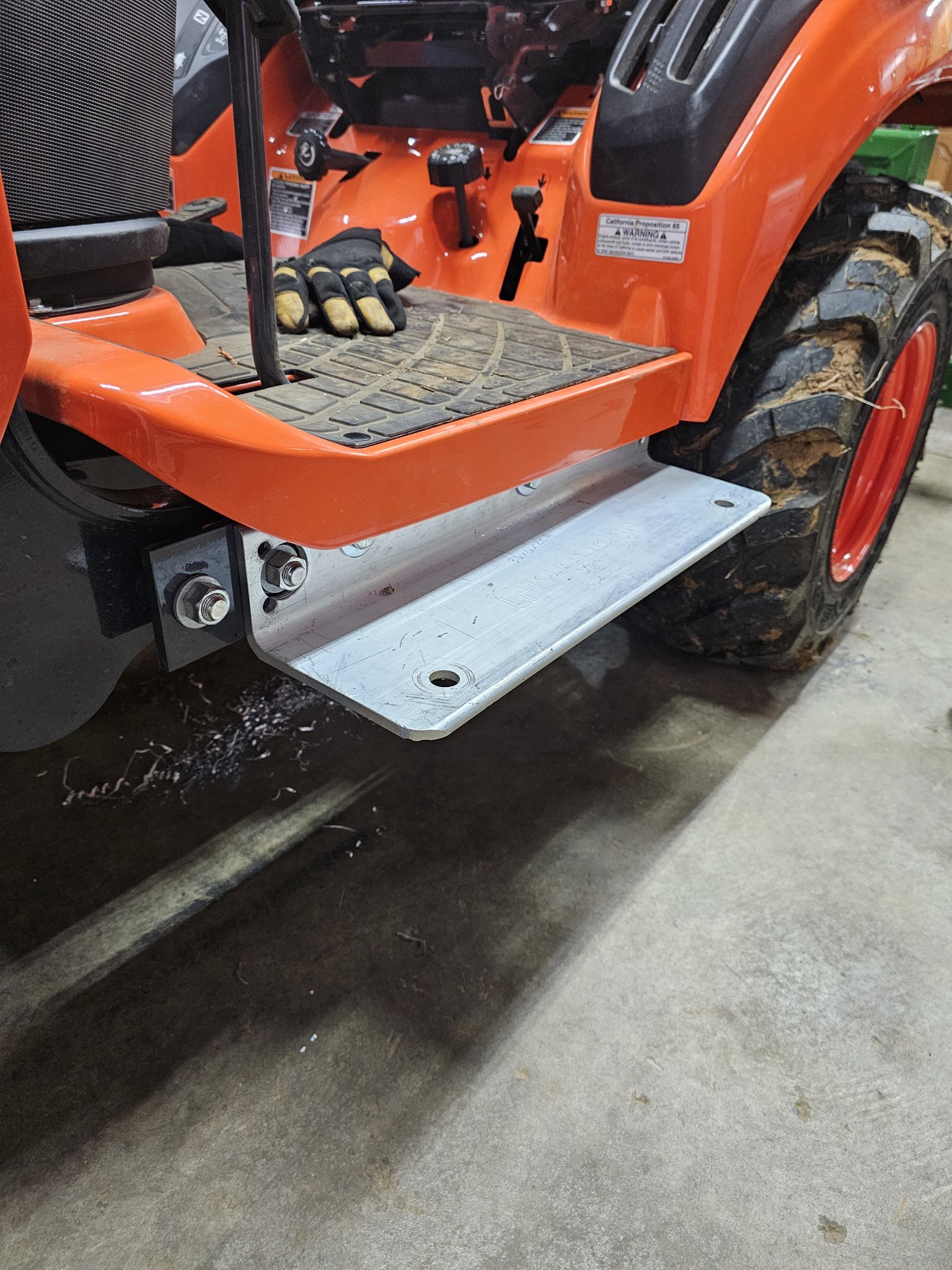

These are ready-made, used in conjuction with internet/server pedestals. Sizes are written. See images
Only one for now. Plot, drill & bolt.

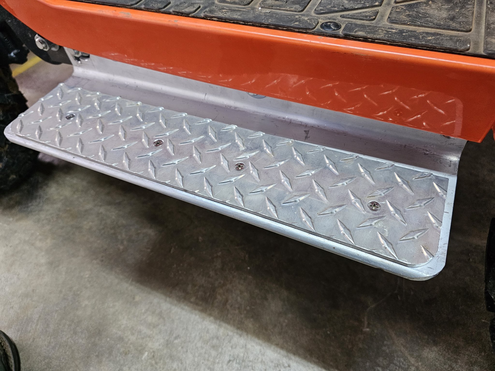

If I can find some, I have plans to put a piece of Aluminum or Stainless Expanded material to make it non-slip.
If I can't find any, I'll drill, tap, and Loctite a dozen or so short Stainless bolts.

I did not have the deck on, or test for interference prior to making the step. I kept the bottom of the step flush with the bottom of the rail that supports the FEL Pedestal/floor pan, so it "should" clear the mower deck when raise at the highest setting.
I'm undecided if I want to add a step to the tredle side. If I do it's purpose will go unused, because I'll block that side entirely by mounting my toolbox there. Which I just might do eventually. As a Winter project. Tomorrow 🤣🤣🤣

The Aluminum, I had a couple pieces of 1/4" tread already bent in my scraps. The bends had too many stress cracks to trust not ripping apart. Had I used them, they would have needed supporting. At that point I may as well used wood and Simpson Hangers.
