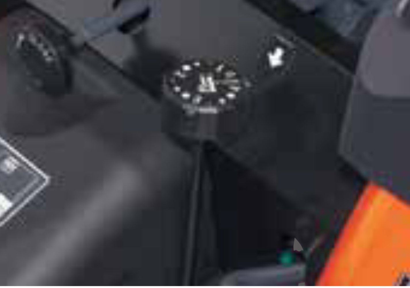

Shouldn’t you just have to raise the 3pt then spin your deck height knob to a lock position to prevent the mmm arm from lowering?
edit: added the picture. Should have a knob like this. DC057161-B5FC-42F3-A27B-C091EEA81AA3.jpeg

Thanks, will try that....the easiest solutions are the best....really snowing here in IL!

on my bx23s the knob says “top”, that picture is just from the kubota online brochure.

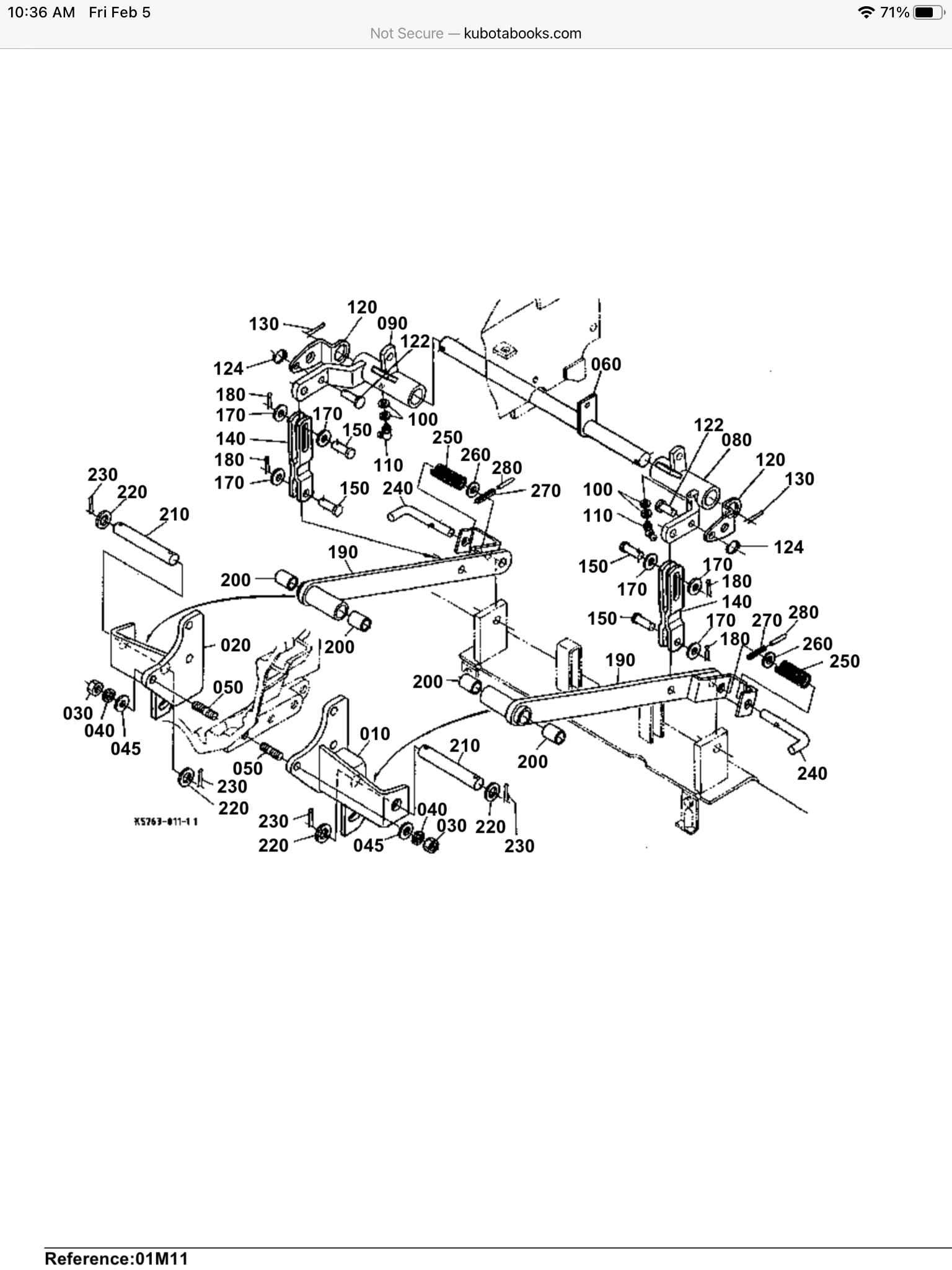

The MMM can be pinned up with two hitch pins (should have been provided with tractor purchase). This allows 3PH operation without raising or lowering MMM. The MMM arms can be pinned up with or without the mower deck installed.
This information should be found in the mower deck operators manual. Part number 150 in the diagram.
