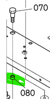

Looks like you are indeed missing a spacer also. See items 70 and 80 on the parts diagram, unfortunately they don't give you the size.

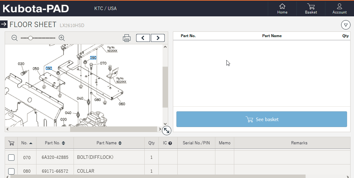

The parts list calls it a Bolt, Diff Lock and Collar. Quantity (1) of each so there's not one on the other side. Looks like it may be a stop for that rod behind it in your picture. Is that part of the diff. lock linkage?
Hmm... so there isn't anything missing? Think maybe I should put something in to at least plug the hole (there is a little bit of rust developing in it). The rod is actually the T-handle on the seat assembly stop, so unrelated.

I think there actually is a spacer ... if you look at the parts diagram, the spacer is quite short relative to the shank of the bolt, which appears to be a shouldered bolt. I guess the bolt goes through that upper plate so it can be removed. (EDIT) Actually, I think it's related to a vibration control system. Parts #040 "Rubber, Vib Proof", presumably compress and stretch. Parts #070 & #080 limit the amount of stretching by acting as a stop for plate #060 "stay (seat, rear)" If the plate lifts up too much it hits the head of the bolt.
Good call by @PoTreeBoy seeing that there's only one and not two. Funny how we see a threaded hole and automatically assume there should be a bolt in it.

The hole in the seat bracket is smaller on the left side than the right side that has the shoulder bolt/spacer. So, that bolt won't fit. Odd that the casting is threaded and the threaded area was masked during painting, so it gets quick surface rust. I'll toss a small bolt in it or a quick spot of spray paint come spring.
No bolt, just a shot of paint will ease your mind.
