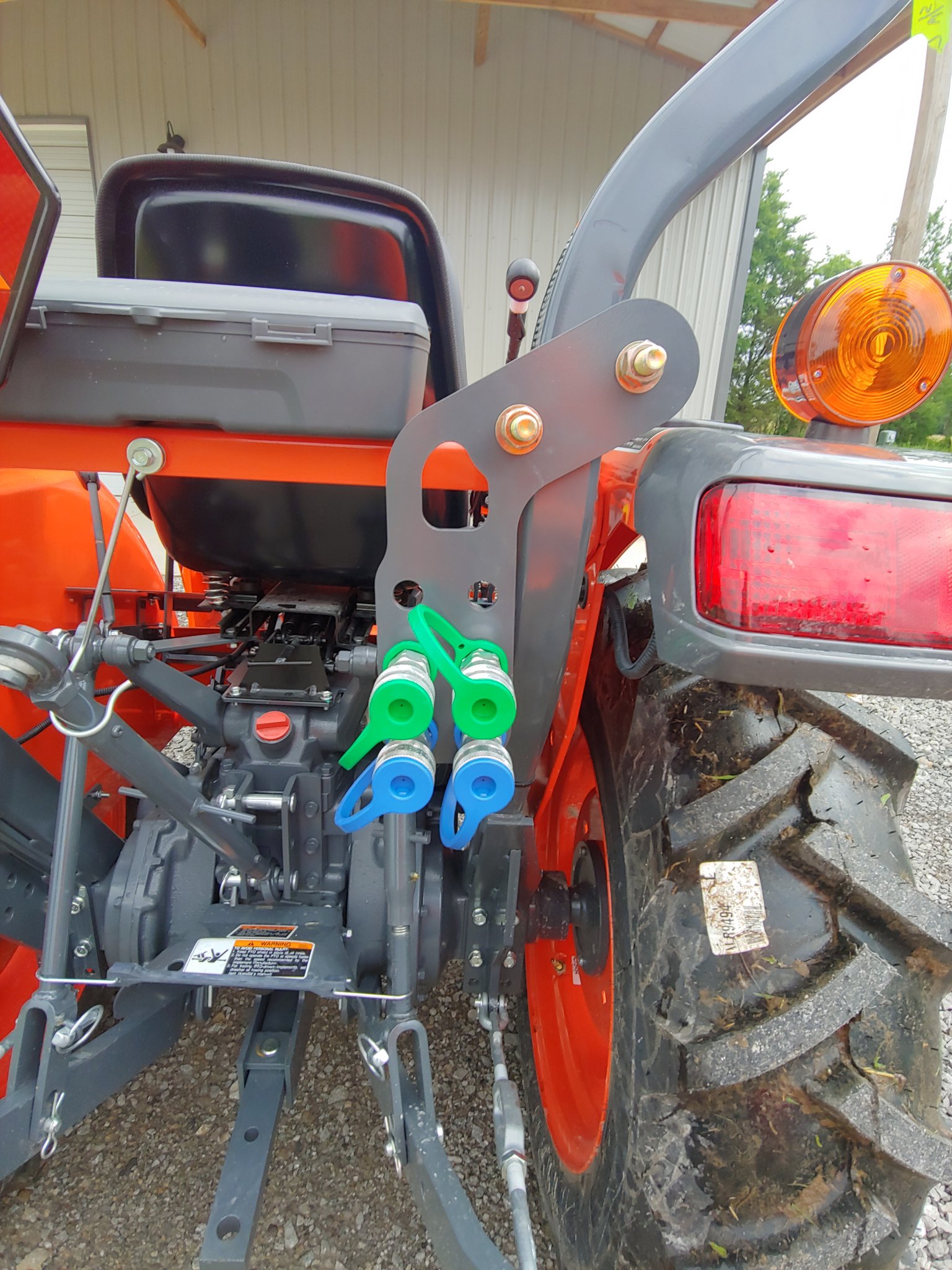

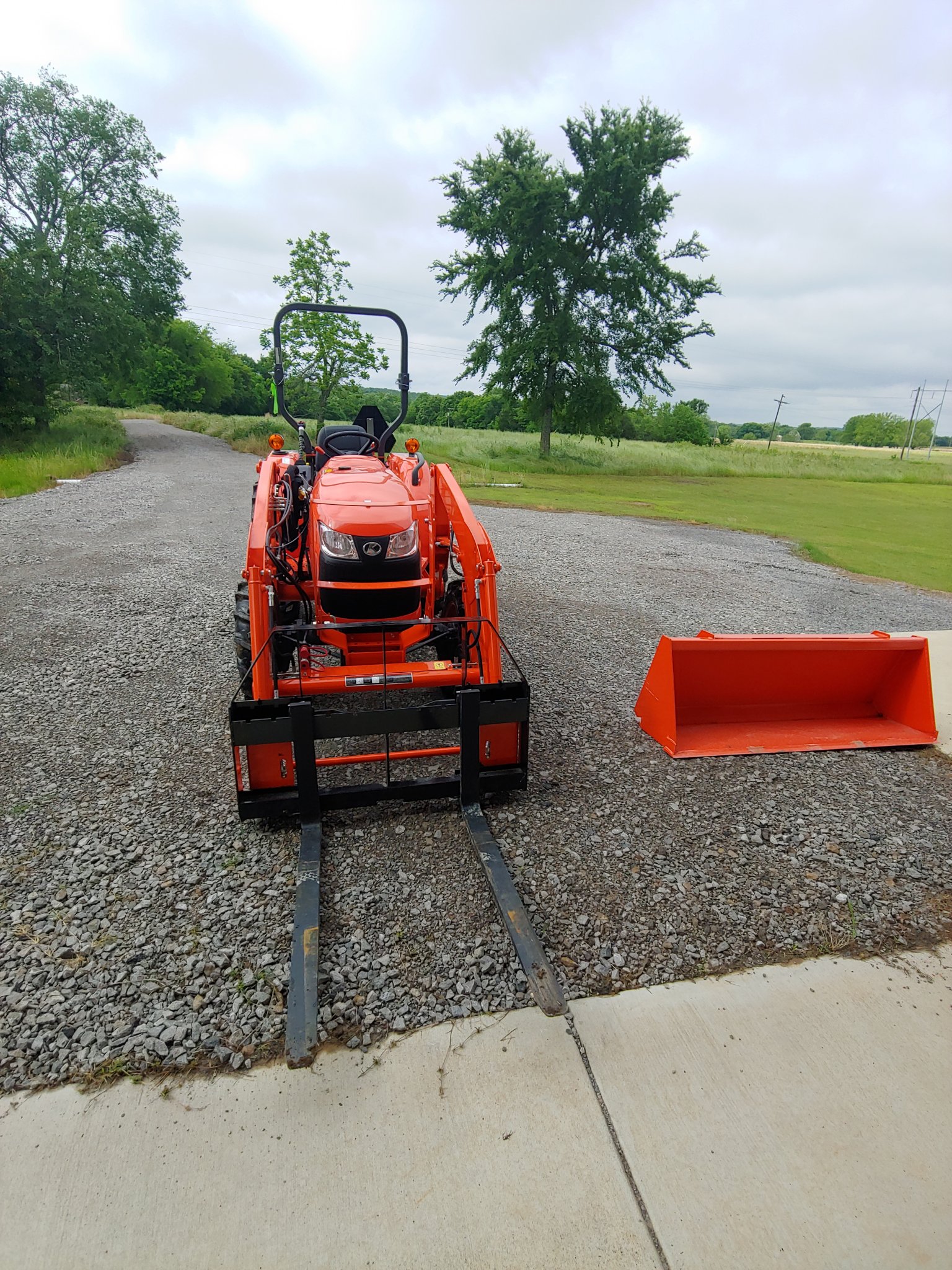

Well here she is about 3 weeks later. Showed up with .3 hours. They had one sitting in the crate. Took a few weeks for all the valves to come in. I checked the nearby mega dealer with multiple stores and they were substantially higher than my local store 15 minutes away. They said 2501's are pretty easy to come by, since they are so popular, but the rest of the lineup is hard to get.
Went with ag tires - I know the industrials are really popular on here, but I mostly do mud and dirt work and the 135 still has original ag tires from 1964 so I figure they should last.
We got a few inches of rain last night, but I still took it for a spin. I already almost got stuck and rutted up my field-forgot this thing has 4WD. Definitely some getting used to over the old geared tractor.
I was able to pick up my 5' brushog with no 3 point ballast, just the loaded rear ag tires. I'll have to get used to sitting down on my seat to keep the engine running, I got in the habit of standing up on the 135 to see what I was doing.

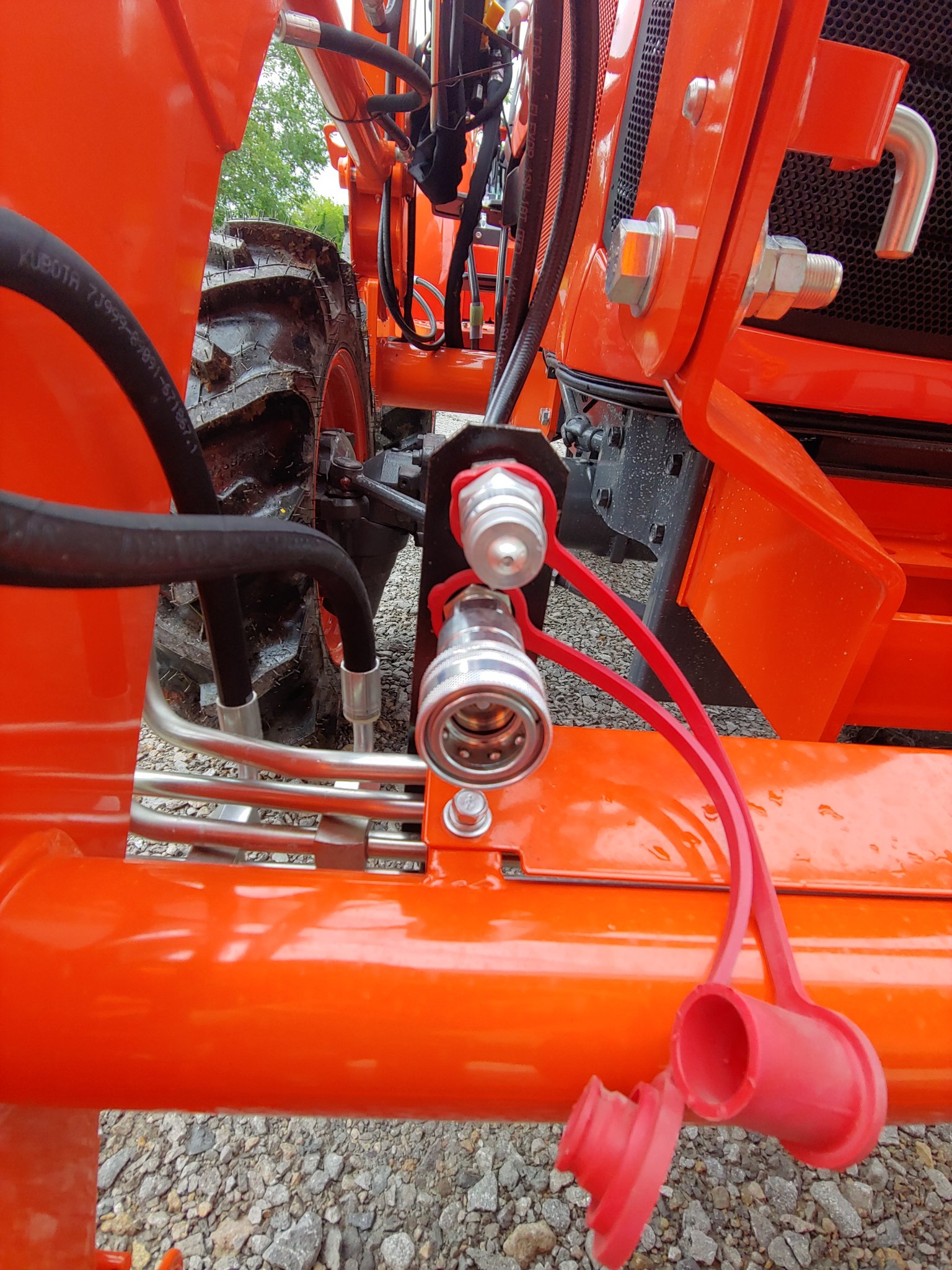

Question - is the front third function a 1/2" pioneer valve? EA needs to know for the grapple fittings.

Nice! Looks good. I envy your rear remotes. The salesman talked me out of putting them on mine. I wished I had stuck to my guns and had them installed.
Just some advice, and don't do like I did and wait. Check your front axle fluid NOW. They don't ship full of fluid and often the dealers forget to fill them. Don't wait, just go ahead and check it.
I will definitely check that when I get back to the tractor. The dealer already had to come out once with a mobile tech because the 3 point wouldn’t lift. Between the front third function and 2 remotes, lots of hoses going on. He had to swap two lines. I wasn’t there to watch it, but it works now.Hope it didn’t damage any of the hydraulics. I’m glad I went with a local dealer.

In case this helps anyone else, check your axle. Mine took 3 quarts. Dealer paid for it.

Yeah, I estimated mine had about 1 1/2 quarts in it when I checked it. (Manual says it holds 4.8 qts.) So, they never checked yours either.
