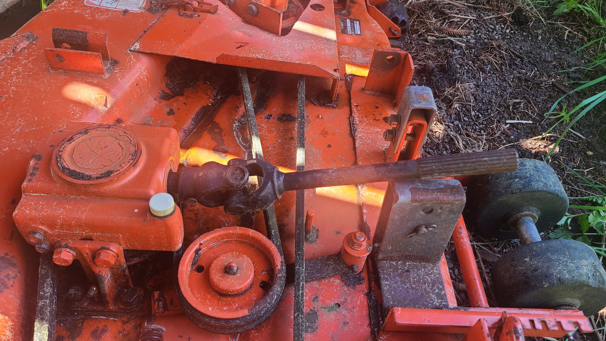

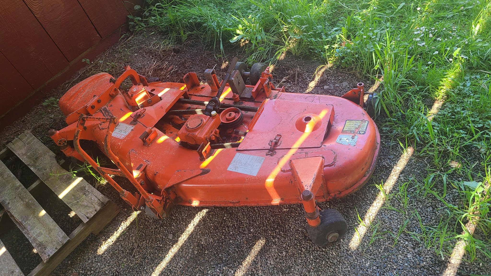

I've got an RC60-24B mid mount mower that came with my recently purchased 2004 B2400 HST. The driveline assembly is missing. It has the yoke and u-joint that attaches to the mower, but the part it slips into and the yoke and u-joint that attach to the tractor pto is missing.
Looking at replacing this, I see prices of $1100 for a replacement for part #76553-32030.
My question here is: can I replace the driveline with an aftermarket product like this one on amazon. https://www.amazon.com/Complete-Tractor-3013-6010-Driveline-Universal/dp/B07B9G9S5T/ref=sr_1_4
If it is possible, how do I find out the min and max extension for the driveline for my mower? (Looked in the manual for the mower, but did not find it)

Figured that specific one wouldn't work, but wondering why. Do you think it's the length? the size of the connector? something about the linkage that is specific to this mower or tractor?
Where did you finally find the part you were looking for?

The driveline kubota uses for mid-mount mowers is smaller than 3-point implement drivline like your Amazon link. It's probably metric and uses an oddball spline count. Whenever buying a used Kubota mid-mount mower, always make sure it comes with the complete driveline because most of the parts are discontinued. You might try ebay, craiglist, marketplace, or online salvage sites. Sometimes you have to buy a crappy deck just to get these illusive driveline parts.
