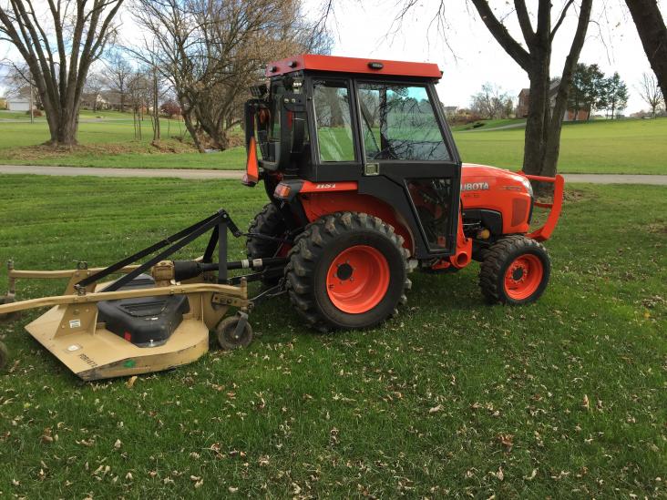

Had a MMM and the next tghree tractors wore RFM's. The most recent is my L3200 with a 6 foot rear discharge Landpride. This is my favorite so far. Here's a shot from early Fall.

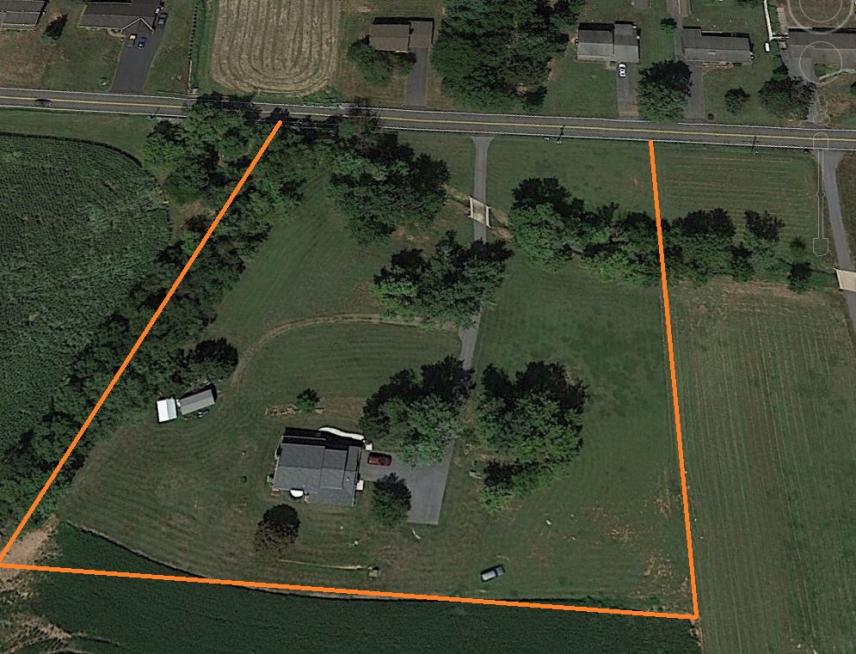

The time it takes me to mow with a 72" vs. 60" deck is far less than would be expected if you just look at the 72" deck being 16% wider. I went from mowing 2-1/4 acres to about 3-1/2 acres when I switched to the 72" deck. Mowing time went from about 33 minutes per acre to 22. The extra grass didn't add time to the mowing. We have some trees, a couple sheds and a creek. The property isn't one big open flat square.

Do you have a 72 inch MMM or RFM? Looking at the picture of your property looks like you have a lot of trees. Was curious if you had the RFM how you did around trees.
It's a rear mount (see post#5 for pic). This is the third RFM for me. The first tractor had a belly (MMM) mower and I strongly prefer the RFM. After getting some time with the rear mower, it is fairly easy to swing around things. I don't have a small rider or walk-behind mower. Whatever is missed with the Kubota gets trimmed with a string trimmer.
