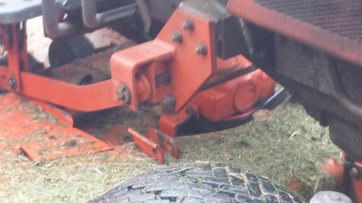

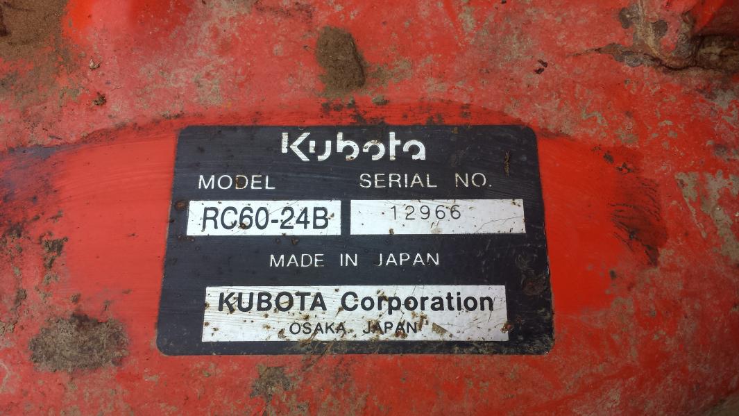

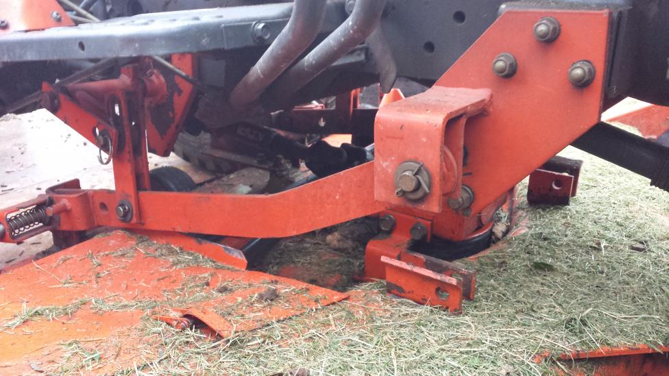

they are slightly different decks - I have the RC60-24B shoved under my B7100HST....... when I bought it, I knew something was fishy when the front bracket had a lot of welding on it........and the front end NEEDS to be jacked up to get the mower deck OUT from under the tractor.
pictures of mine.....they may not help - your tractor is different too
