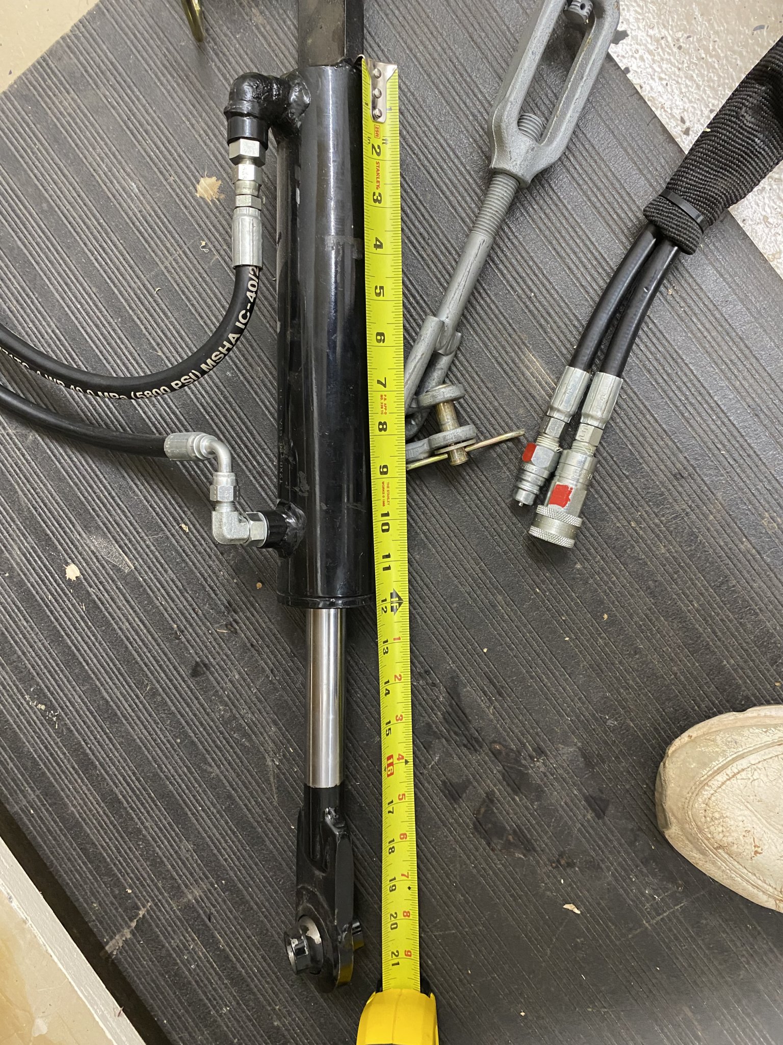

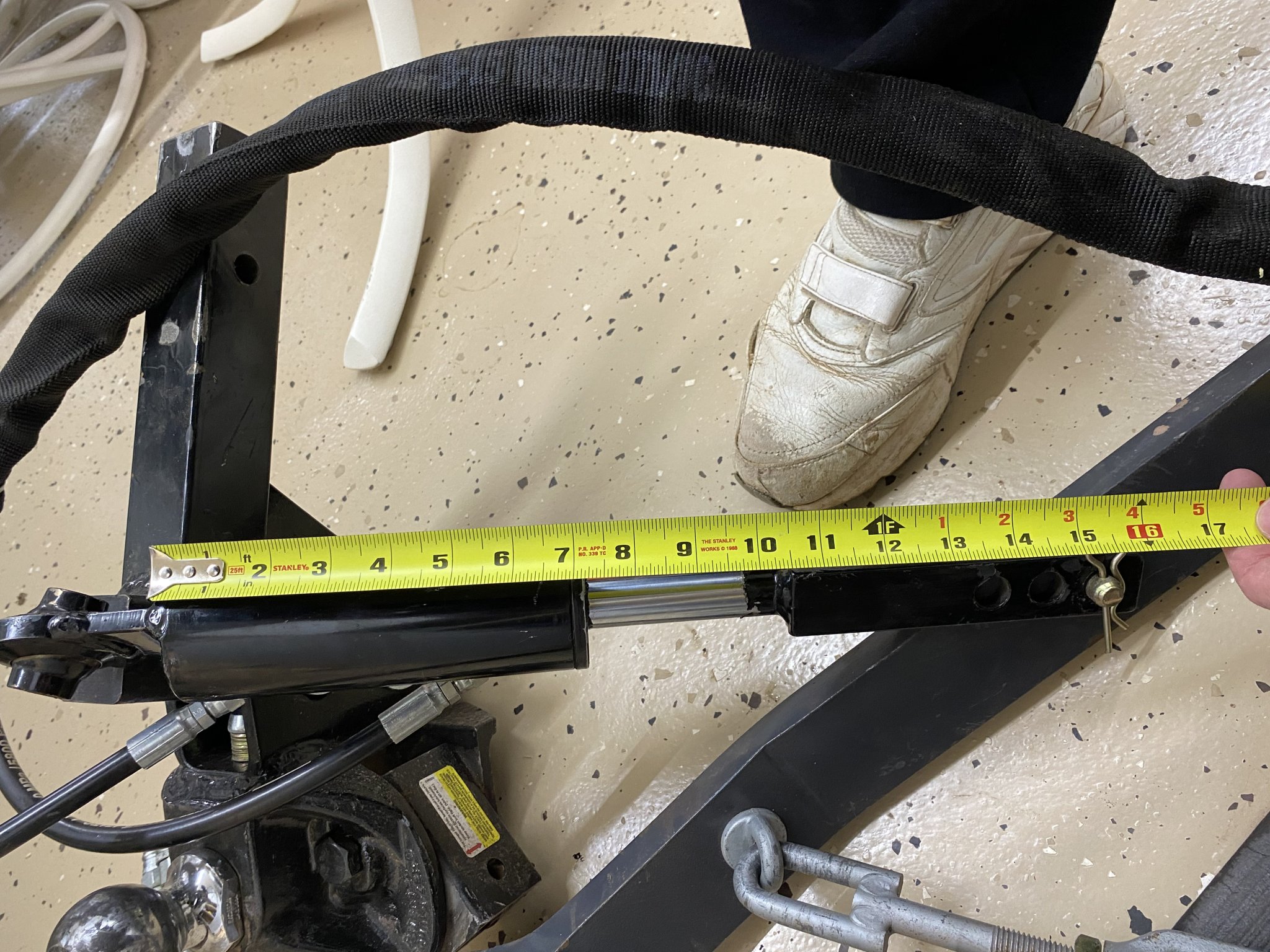

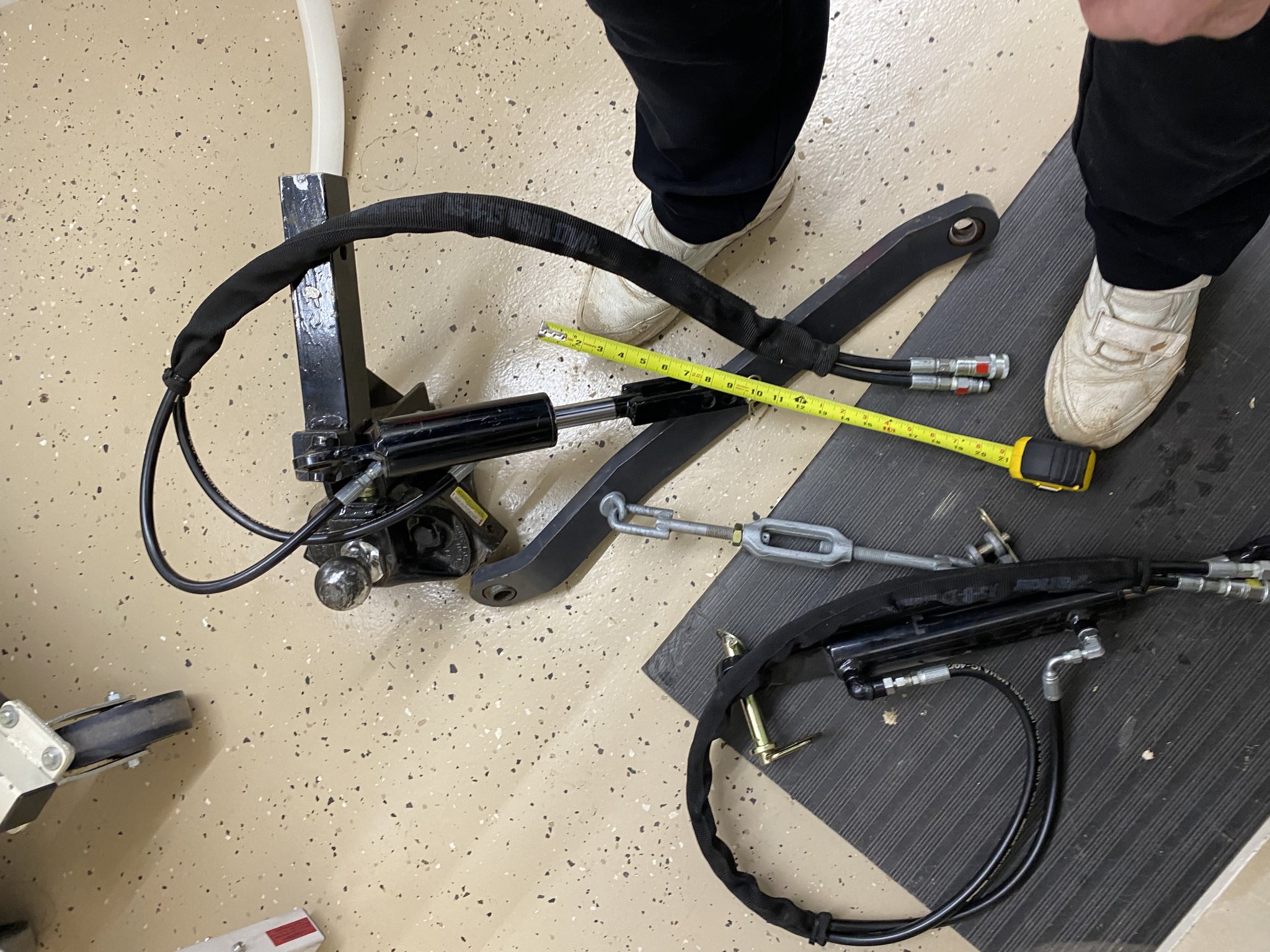

OP..since you are up by me…within about an hour…I have an idea for you…way cheaper than that kit…
I have a little used set that I will make you a deal on. I plumbed my tractor for a TnT for a box blade I used once. Sold the box to a buddy and have the rams and hoses sitting on a shelf. Was on my L2800 and worked great….bought a backhoe and just leave that on full time…the ram are essentially new.
