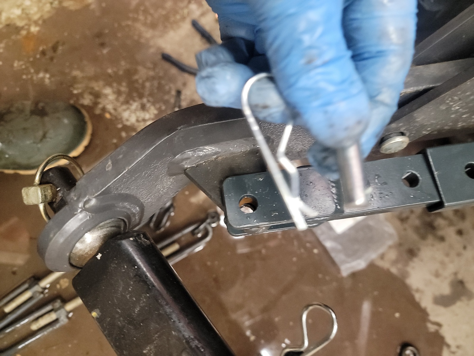

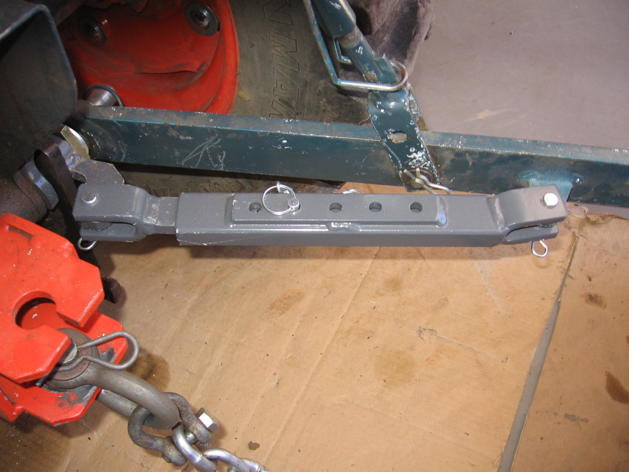

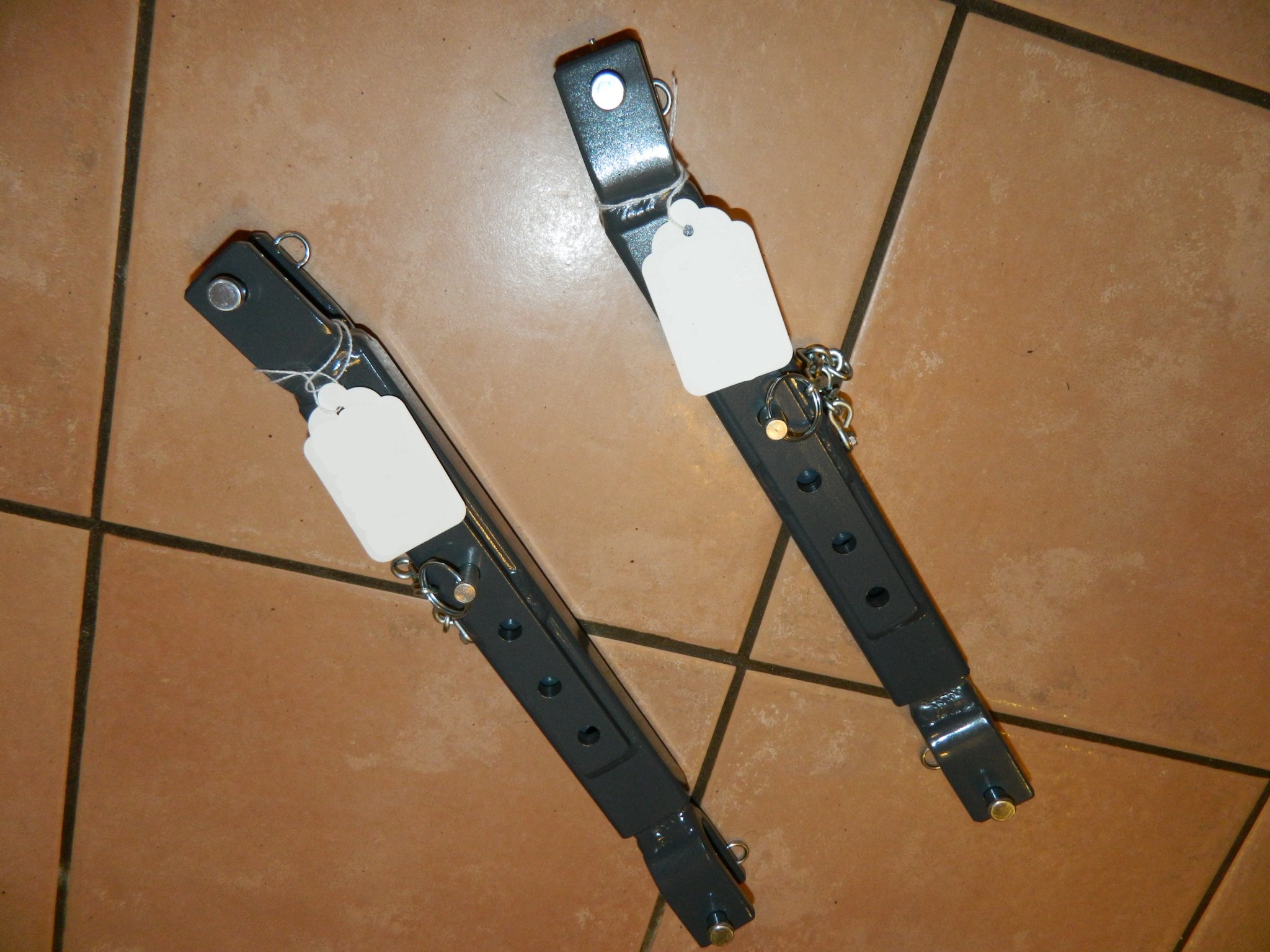

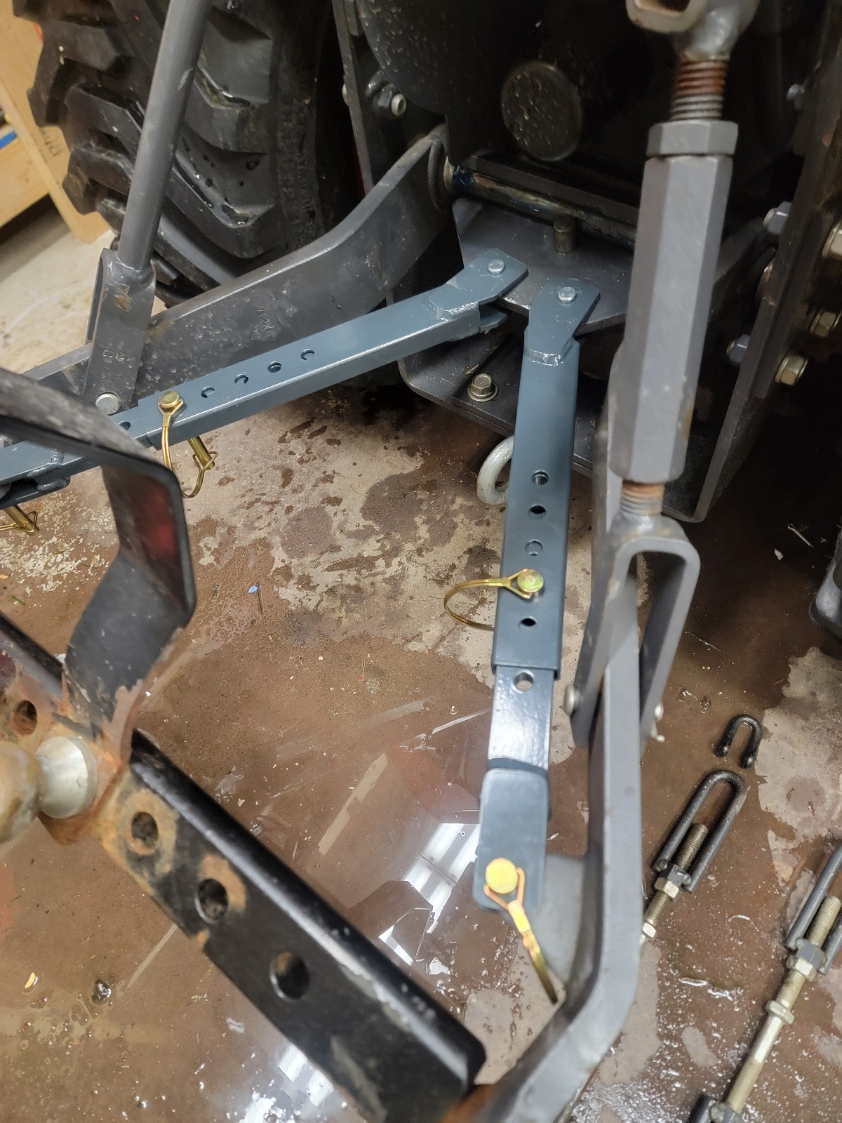

installed these feild ready stabilizers tonight
Photo 1: Shows the product
Photo 2: I inverted the steel bracket that hold the stabilizer to the tactor. It nows sits vertical rather than dropping down a bit. By inverting it I gained a a couple of centimeters in addition space for any rear PTO attachments

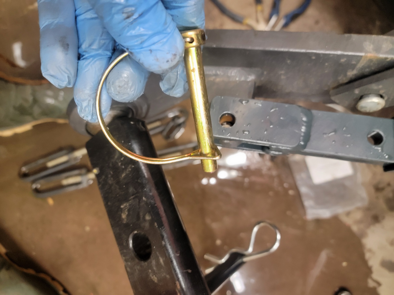

Photo 3: New pins and clips that came with the kit. I only used two of those amd elected to go with a difference pin for ease of readjusting the 3 point hitch.
Photo 4: Shows the left stabilzer installed without the adjustment pins
Photo 5: Shows the pins that came with the kit.
Photo 6: Is the pins I installed rather than the factory supplied pins
Photo: 6 & 7 Show the completed installation on both right and left sides.
Photo 7: is the old stabilizers.
I think the upgrade was well worth the money. The ease and simplicity of adjusting the lift arms is GOLD in my books.
Removal and install time. 20-30 minutes including cleanup.

I added an extra pin in each stabilizer. Most of the time, 2 holes line up just enough. It will be more rigid.
