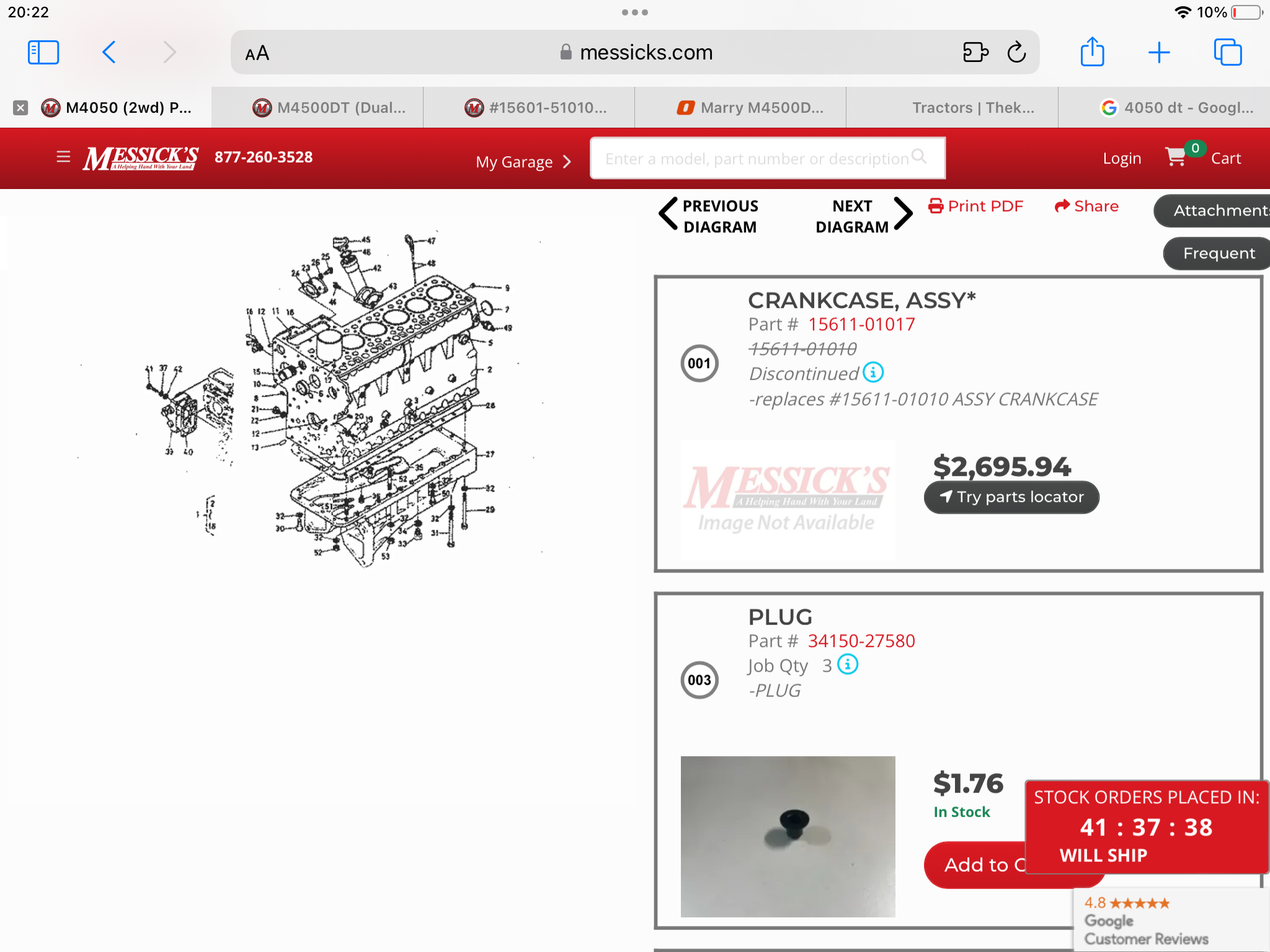

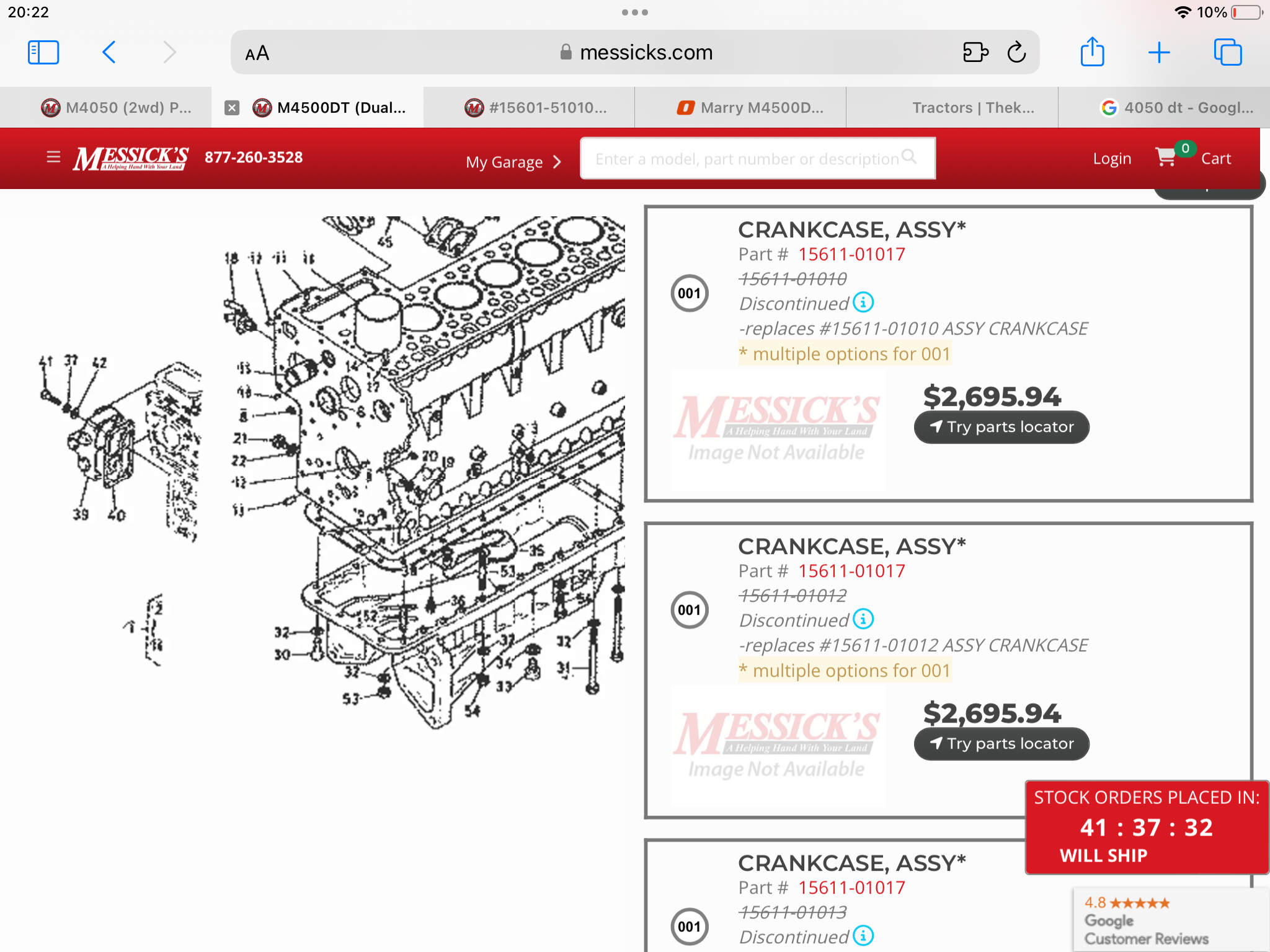

Agreed, doing a pn search is a good step. Which I did a rough one before posting here. i could be wrong but I’m pretty sure the block numbers are the same. Same with the clutches the clutch housing (except for the DT because it has the shaft out the front).
The m4500 has the S2600-A engine the m4050 has the S2600-AL engine. I believe the ”L” is for lower HP (55.5 vs 48). I believe the fuel pump( also the same) is just adjusted differently.
