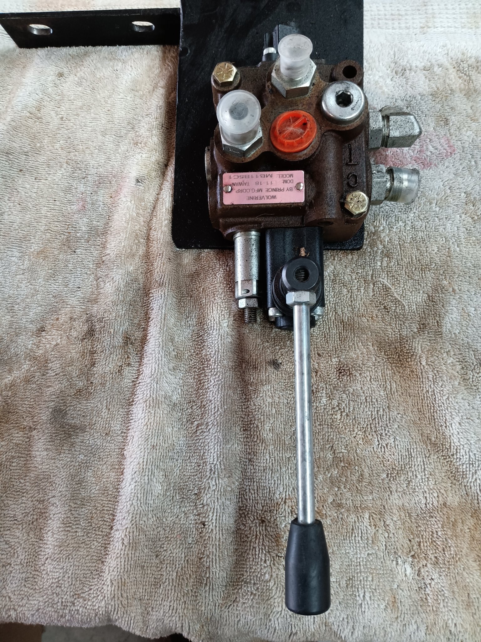

Lightly used take-off ready to mount next to loader valve. Single spool manual Wolverine valve by Prince. Less than an hour to install.
Valve and loader mounting bracket -$100

I will be happy to discuss details of a sale via PM but here is some additionsl information on plumbing for the benefit of anyone else that may be interested.
This is not a selector valve. It is a manusl 3 position spring center double acting directional control valve. The valve is equipped with power beyond and tank outlets and can be connected anywhere in the neutral circuit of most models. It was used as a third function valve mounted next to the loader control valve.
  1. The bracket fits the underside of the base plate on the LA525 and similar loader valves. The mounting holes are slotted to allow some flexibility. It may be usable in other loaders but I would need some pictures and measurements to verify fit.
  2. On standard L's you disconnect the loader power beyond hose at the hydraulic outlet block and loop the hose forward and back up to the inlet port on the aux valve.
  3. Using a new hose you connect the power beyond port on the aux valve to the neutral return port on hydraulic block.
  4. You disconnect the loader tank return hose at the hydraulic outlet block and loop it forward and back up to the top tank return port on the aux valve.
  5. Using a new hose you connect the other tank return port on the aux valve to the tank return port on the hydraulic outlet block.
I can do that in about 30 minutes but I have had practice. Here is a a picture of a two spool Summit monoblock valve I installed in place of the single spool Wolverine valve Same exact bracket and plumbing.
