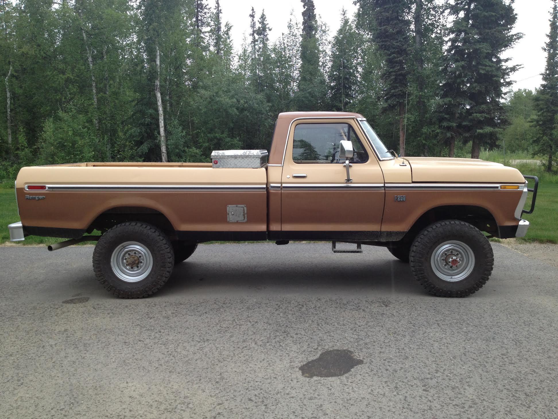

More pictures of that Hiboy please
You like, traded Chev Blazer in for it new back in the day, when Ford Rangers were real trucks.:p
Don't drive it anymore, took it apart with intentions of converting 460 over to fuel injection, got a little sidetracked. for now.
