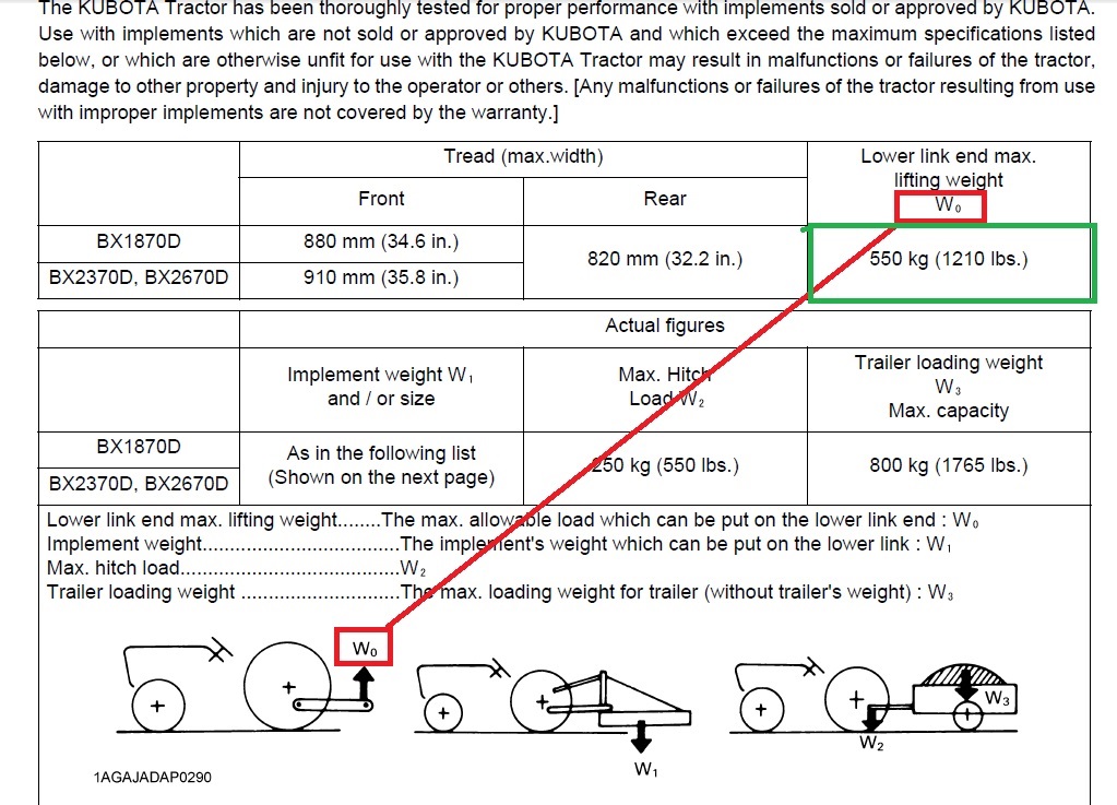

The answer to your question is very dependent upon this material from your owners' manual
In addition to the weight the 3 pt can lift you need to realize the further back from the center of the rear axle the ballast weight is supported the more it will lift the front of the tractor.
The other factor often overlooked is the ability to prevent roll overs if the ballast is properly located.
The ballast weight will have the greatest benefit for roll overs if when raised the weight is lower than the center of the rear axle.
Your ballast form may place the weight too high to add roll stability.
If your 450# ballast is kept as close to the rear of the tractor as possible the weight should be OK.

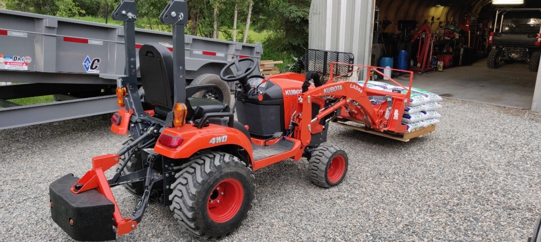

I rebuilt my form, above, to make it 37” wide, 10” tall and 13” deep. This will give a lower center of gravity and a bit longer out the back. It‘s meant to hook up to my Quick Hitch. It looks like Crummy keeps his on for ballast for the forks.
I’ll post pictures of my project.
Crummy, what attachment (brand name and model) do you have for the forks? I’d like to switch back and forth from the bucket to the forks. I’ve seen some negative comments on the forum about the quick hitch type of bucket, but I’m still interested.

Crummy
LX2610
Jul 29, 2021
14
9
Alaska

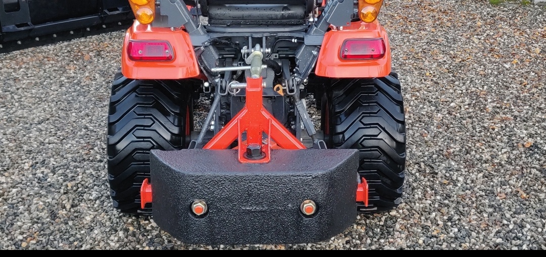

SSQA Bucket is the only way to go if you want more than a Bucket. I run
Forks - Kubota BX2415 32", Snow Pusher - Land Pride SPL1060, Grapple - Land Pride SGC0554, modified 72" Curtis snowplow and two different buckets.

Steel or Iron have a distinct weight advantage for ballasts.
Concrete weights approx 150# per cubic foot.
Steel more than 3 x more at 489# per cubic foot.
There’s no doubt that Crummy built a ballast worthy of an art museum. That piece of iron is the perfect size. I’m coming along pretty well with my steel frame and the concrete block is fairly small and should easily hook up to my Quick Hitch.

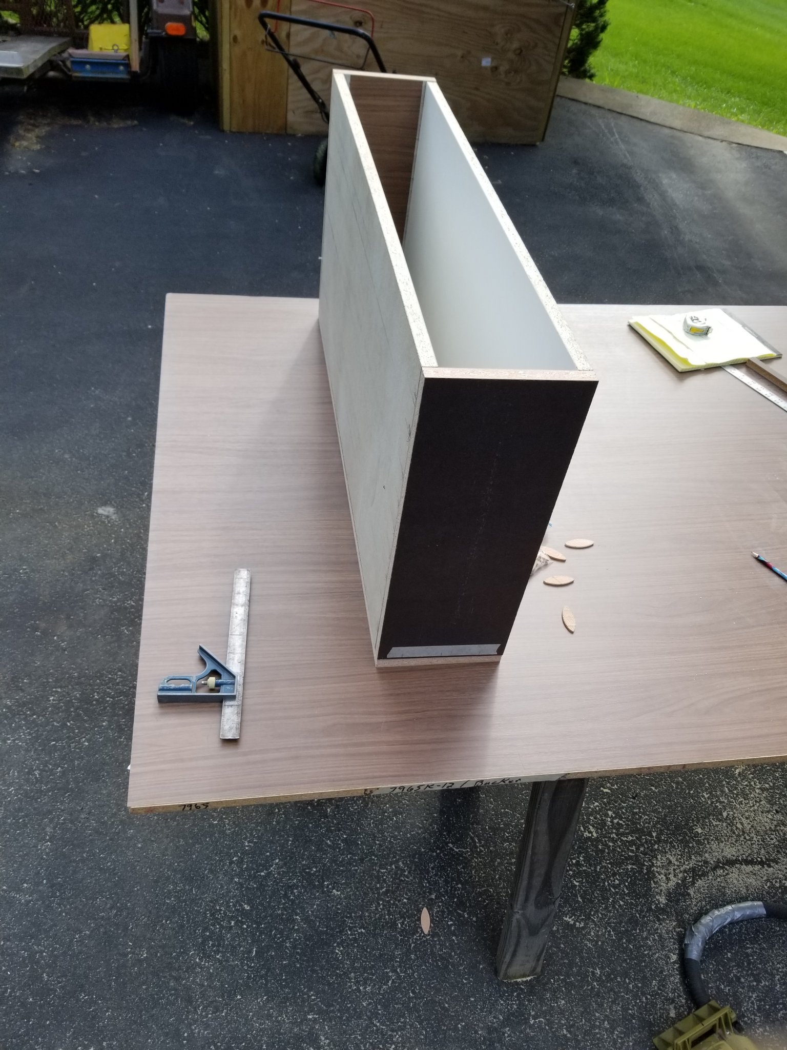

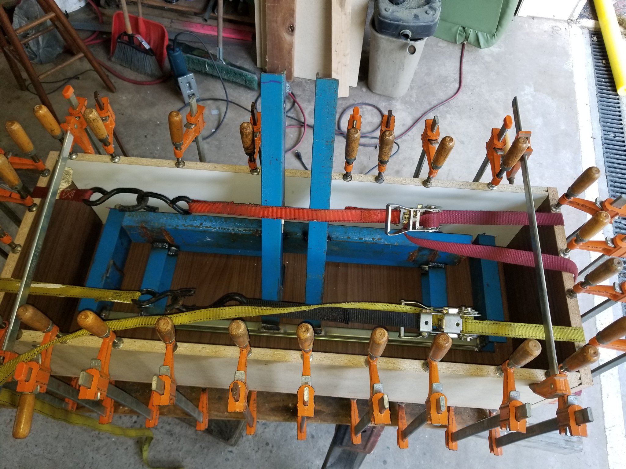

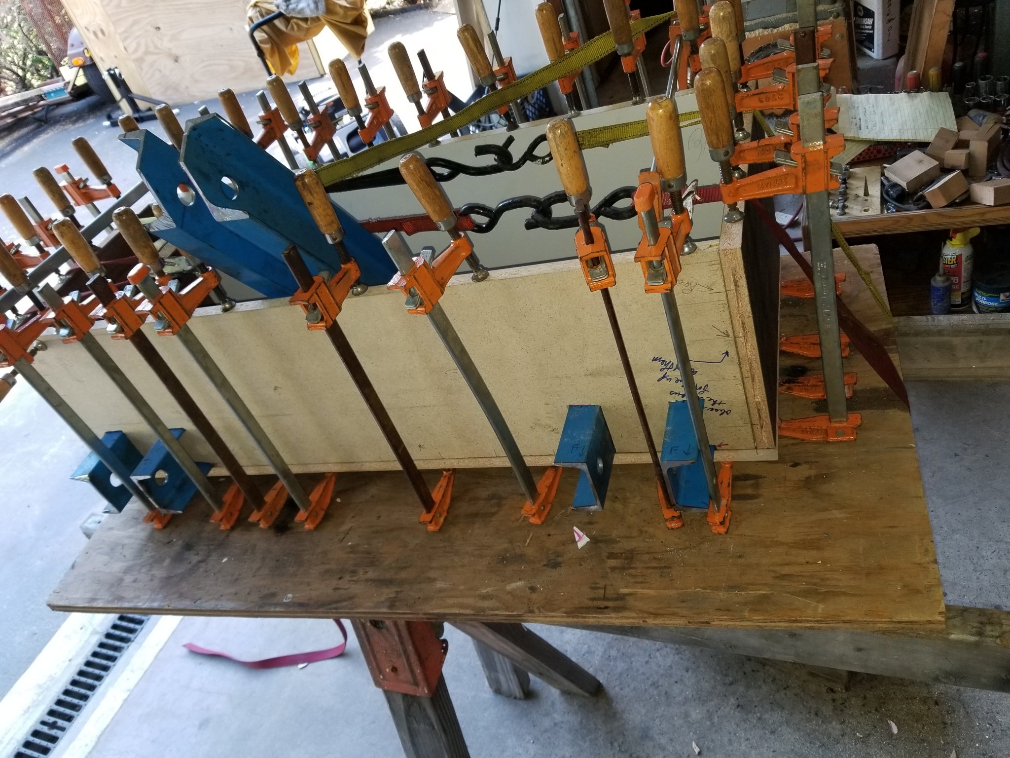

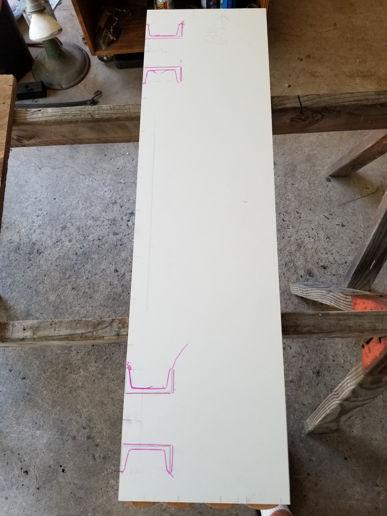

I am using scrap structural steel for a frame
It's size will be 37 x 13 deep x 10 high. A local mill put out pallet of scrap 3/4" PB with Formica on one side, so I grabbed one. The C channel Mark's were cut out.
All edges are cut for biscuits and glued together. Tomorrow I'll fill the form with concrete.
View attachment 65738 View attachment 65739

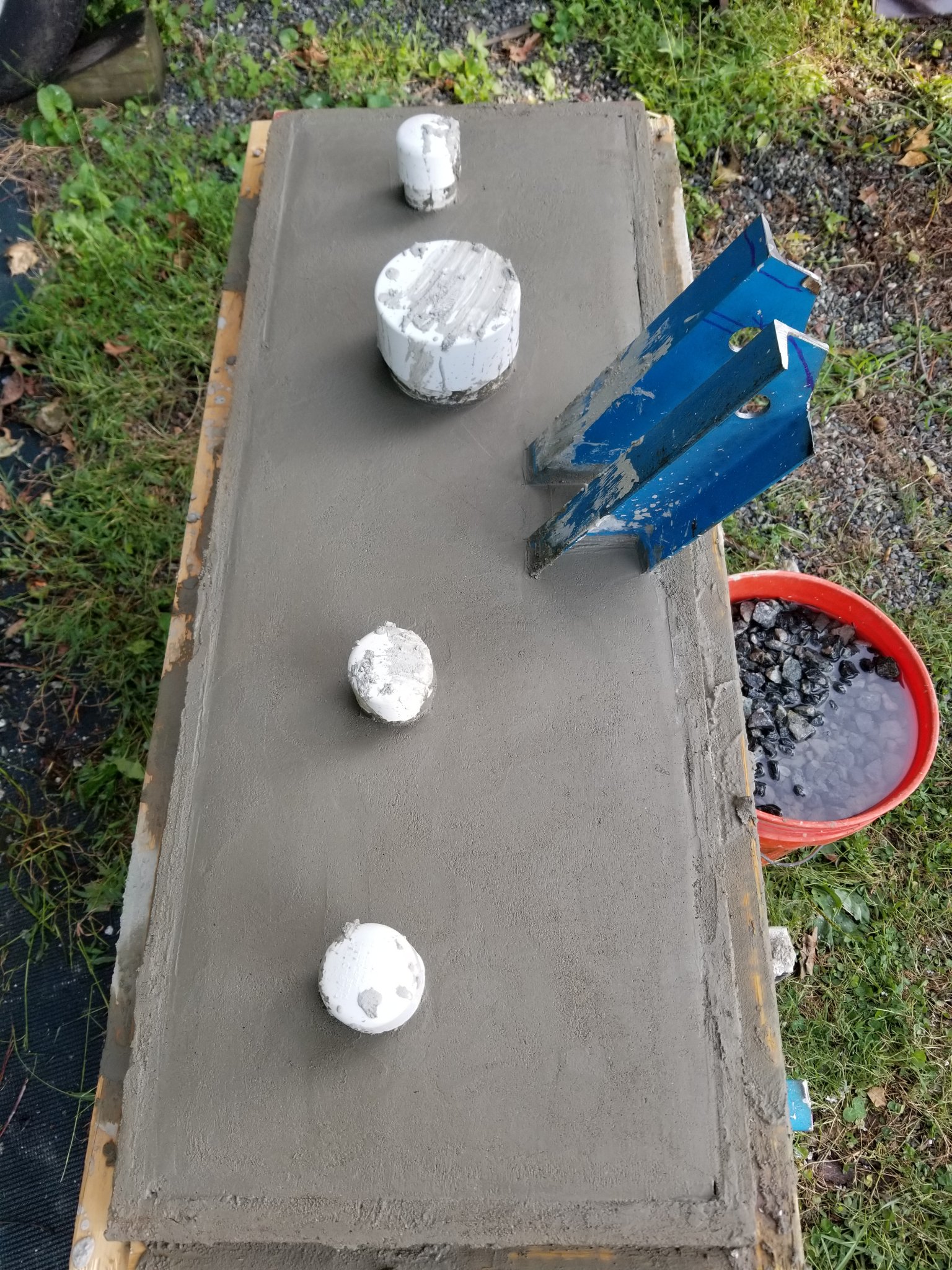

you might want to include a few pcs of PVC set in vertical. Would give you an easy way to carry shovels, rakes and implements of destruction.

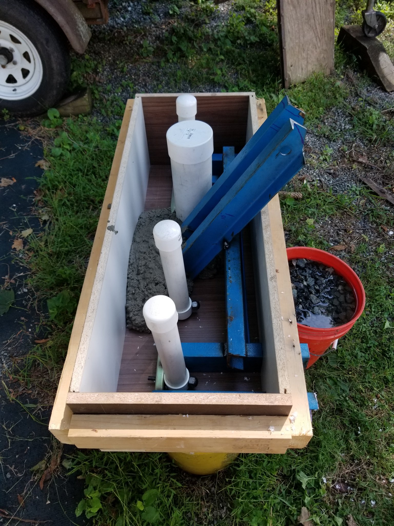

I saw the tubes on the commercial boxes but I don't think I would ever use it. Good idea, though.

Just toss all the clamps in there, that’s gotta be a few hundred pounds!
I dig it. I would definitely put some pvc in, you may never use it, but if you need it and it’s not there....

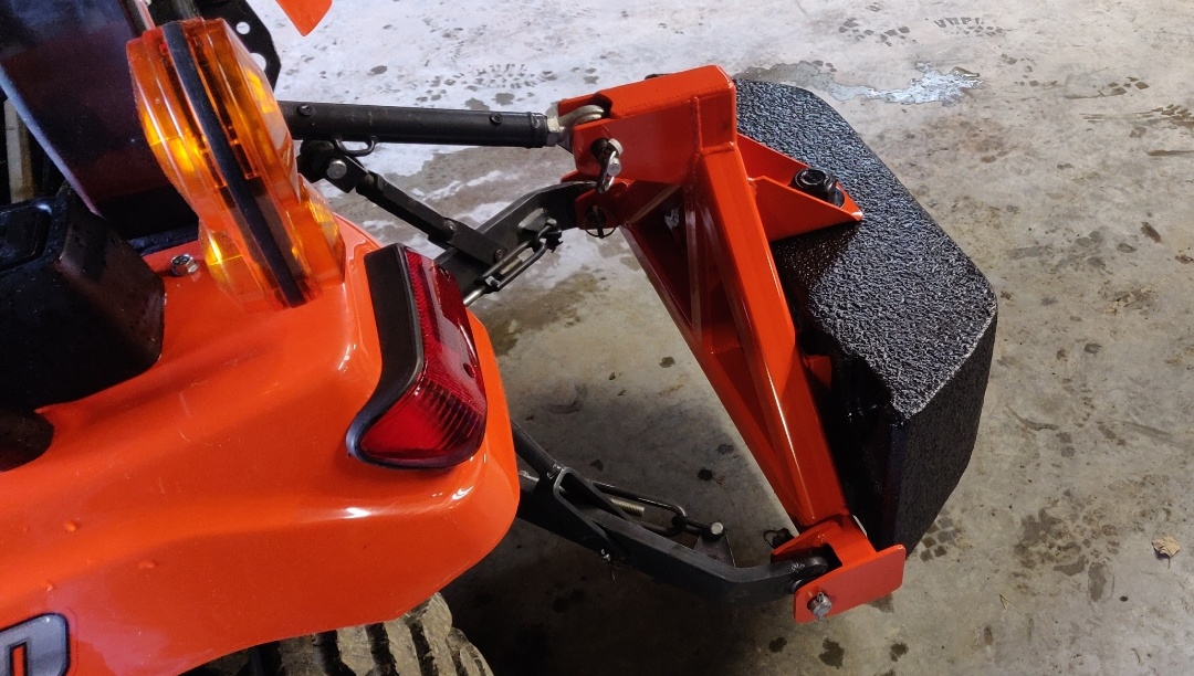

I took the advice of the tool carriers. It used 340# dry weight of concrete plus the steel, 80#
Now to keep it sealed up in plastic for 30 days and get some custom mixed Orange paint.
WAS BANNED FOR NSFW PICS
6,518
5,152
Cover it with burlap, and keep it wet. You shouldn't keep it enclosed in plastic. Concrete needs to breath to cure properly. Wetting it down once a day, and keeping it out of the sun will be best.
Good tip. It’s sitting in the woods. I recently made a refractory slab for the top of my wood stove. I kept it in the form for a week, keeping it wet, and then I submerged it in water for a month. Ponding is another way to cure concrete.

@Baymee, that's a neat solution you have there. I can imagine some folks standing around it 50 years from now wondering who made it and why. Very cool. It'll be interesting to see if it cracks, but hopefully not.
When I worked in construction, we used to spray a diesel-like liquid over our concrete pours to retard evaporation. This was in Hawaii back in the late '80s and early '90s.
