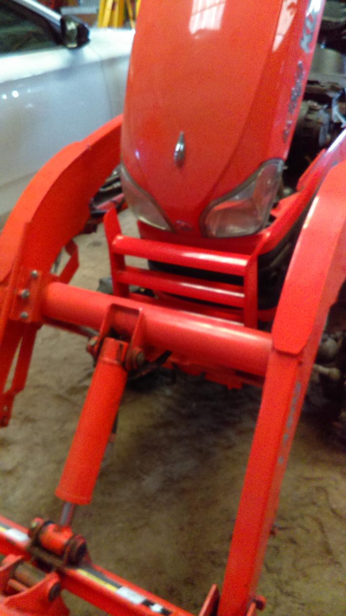

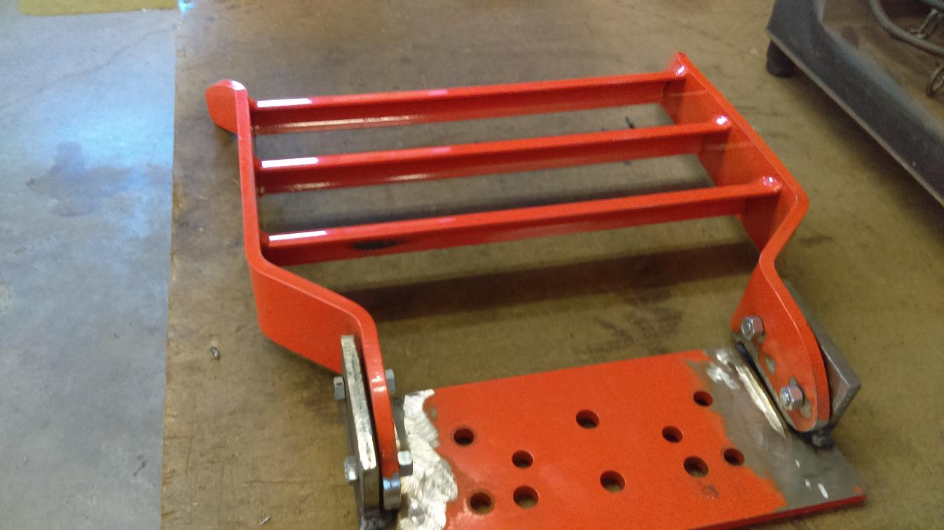

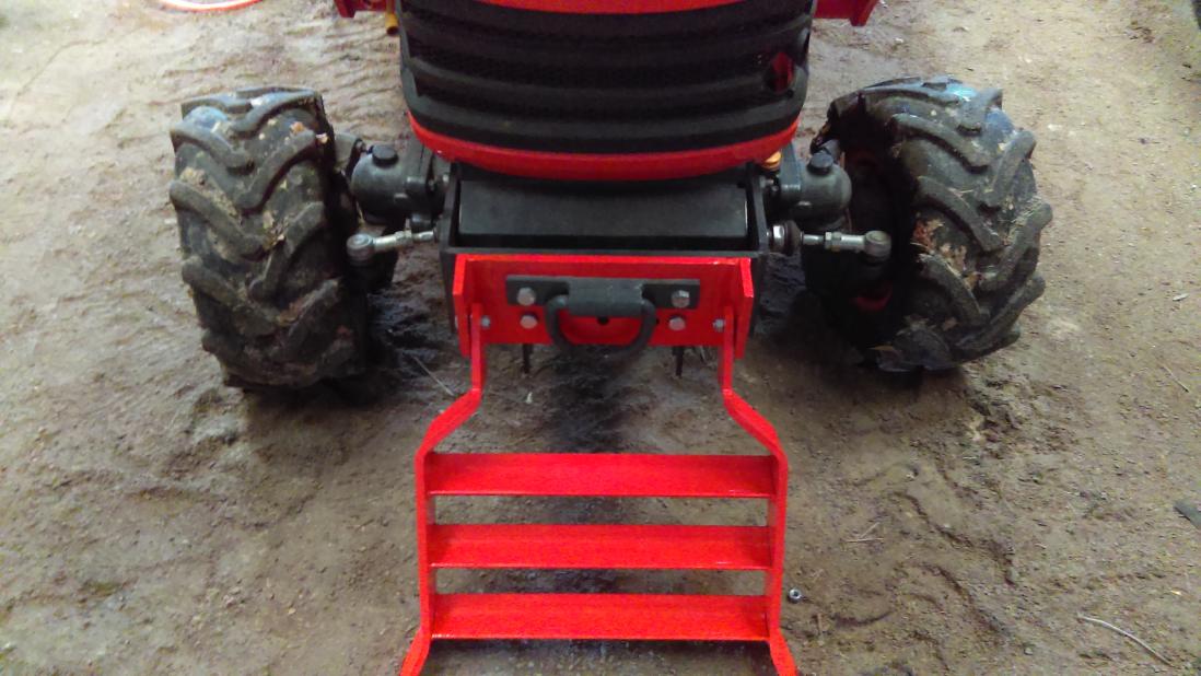

i recently got a hold of a new BX2334 relatively cheap. noticed if i want to remove side covers, had to unbolt grill guard, unacceptable. i ground the welds best i could, then used sawsall w/metal blade and finished cuts. made 2 extra plates, drilled some holes, had my brother weld up, paint and installed. now i have a folding grill guard just like the bigger Kubota tractors. now just looking for the correct quick pins to replace the upper bolts.
