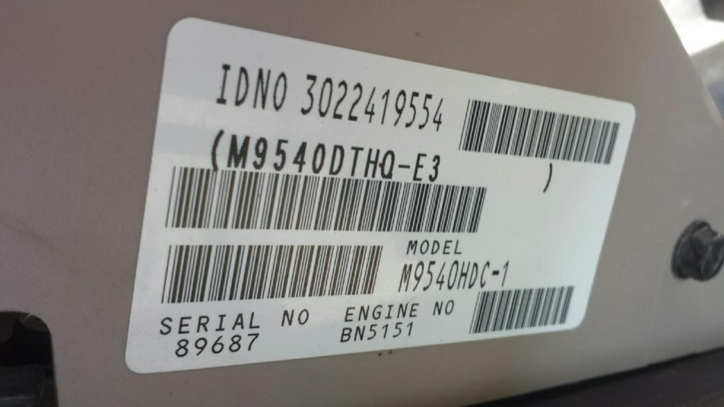

There is quite a few different models and options, what exact model are you working with, serial # too.

I do not have the serial number. I only know right now that it is a 2012 M9540. And after looking in another section of the service manual, it appears that the expansion valve is mounted to the top of the dryer. I suspected this, but wasn't sure. Does this sound right?

32,692
8,227
I'm 100% sure, it's off of Kubota's site.
But like I said earlier I would need to know the exact model and serial # in order to give you the exact part#, as there is 22 different versions. ;)
32,692
8,227
So an M9540HDC-1
Hydraulic shuttle, 4wd, Cabin, Interim Tier III
Compressor: 3C581-97590 $1770.00
Receiver (Dryer): T0070-79270 $166.50
Expansion Valve: 3A851-72170 $170.26
