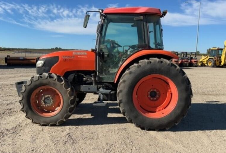

2007 M9540 with rear cast centers, standard fronts per the following:
420 / 85 R 34 Rear Rubber
320 / 85 R 24 Front Rubber
Has anyone else swapped to R14's on existing Wheels on the 9540?
Does anyone know or possibly have ordered a new set from Kubota with the cast weighted rears with R14 or only after?
Anyone know where or have a thought on where to find another set of cast rear centers same size? I still need my AG setup, & I have found the outer rims used, but I might simply keep 2 sets (1 R14 & 1 AG) to just swap as needed.
Anyways, appreciate any guidance. Maybe have to get normal rear wheels + R14 & then add weights. I may look to find a shop that can make the cast centers from what I have now if the price is right & then buy a set of used outers.

You'll need to get different rims for R14 the rims for the R4's will work, the R1 rim will not work.
You will need to switch both the rears and the front as the ratio will change.

Any recommendation on what Wheels for all 4 needed for the R14s & or a suppliers? I suspect then I will also need to obtain wheel weights vs. the cast but I guess that all makes sense especially since the R14 I think came out after my model anyways.

What size tires do you have on it now.
Looks like the M9540HDL has stock rims that are wide enough to support R14's

Update:
I currently have the Rear 34 \ Front 24 per below along with the Titan Wheels. The R14T Part#s Titan confirmed fit this setup.
I am now looking for another full set of 34\24 to have 2 full sets but 1 AG, 1 R14T in case anyone comes across these, please do PM me & thanks in advance.
420 / 85 R34 Rear Rubber | Wheel = Titan 34XDWW 15A 3 18 07 S2 _ 04 21273 00 187 | R14T = Part# R4T154
320 / 85 R24 Front Rubber | Wheel = Titan 24XW10 129 _ 03 10 8 03 06 S1 | R14T = Part# R4T214GEF
