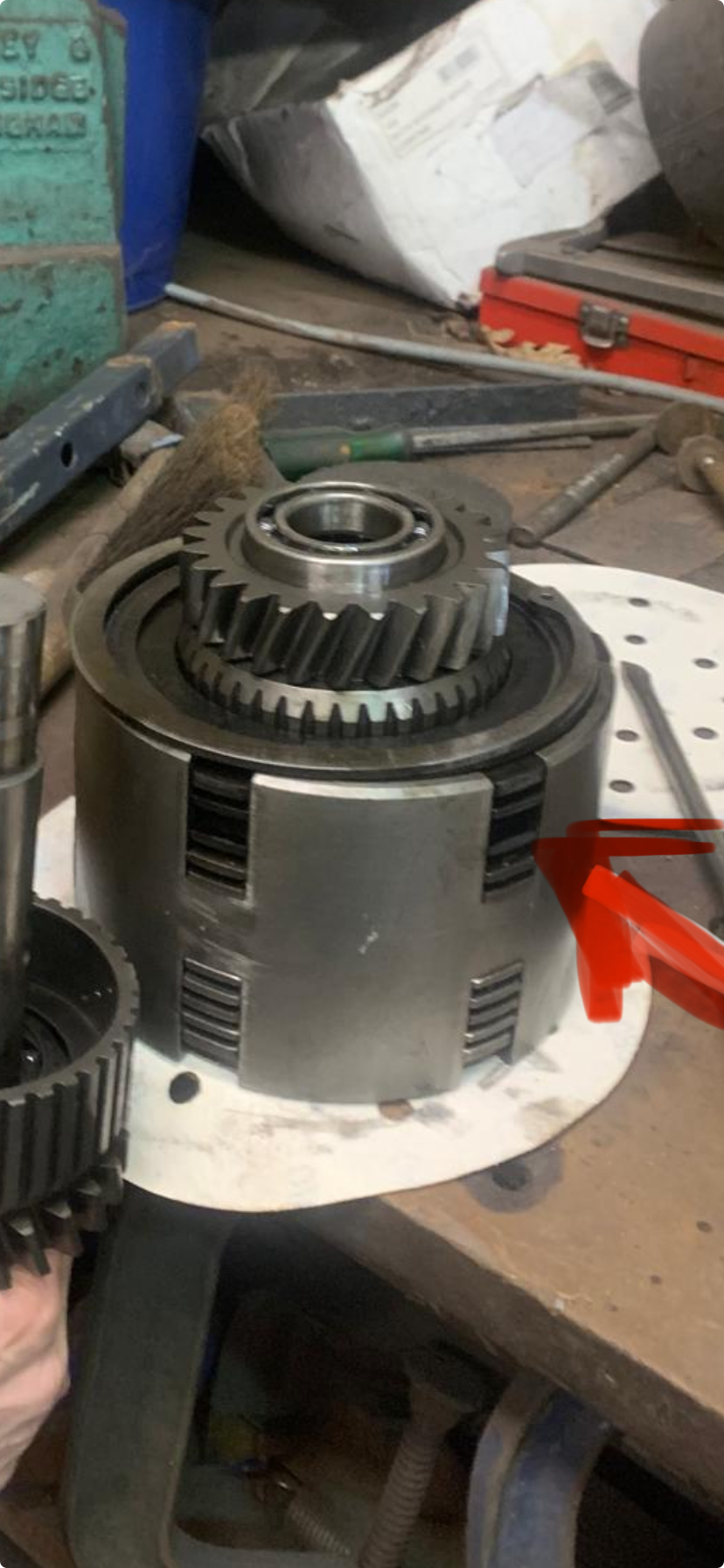

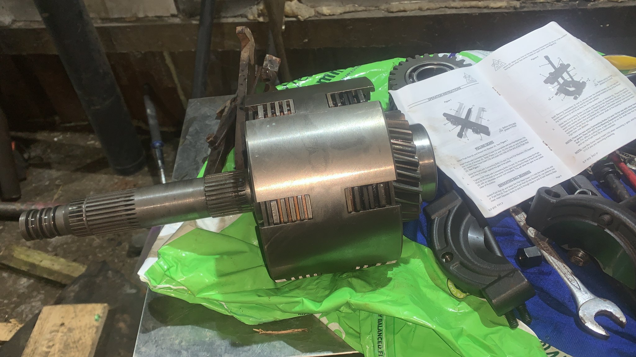

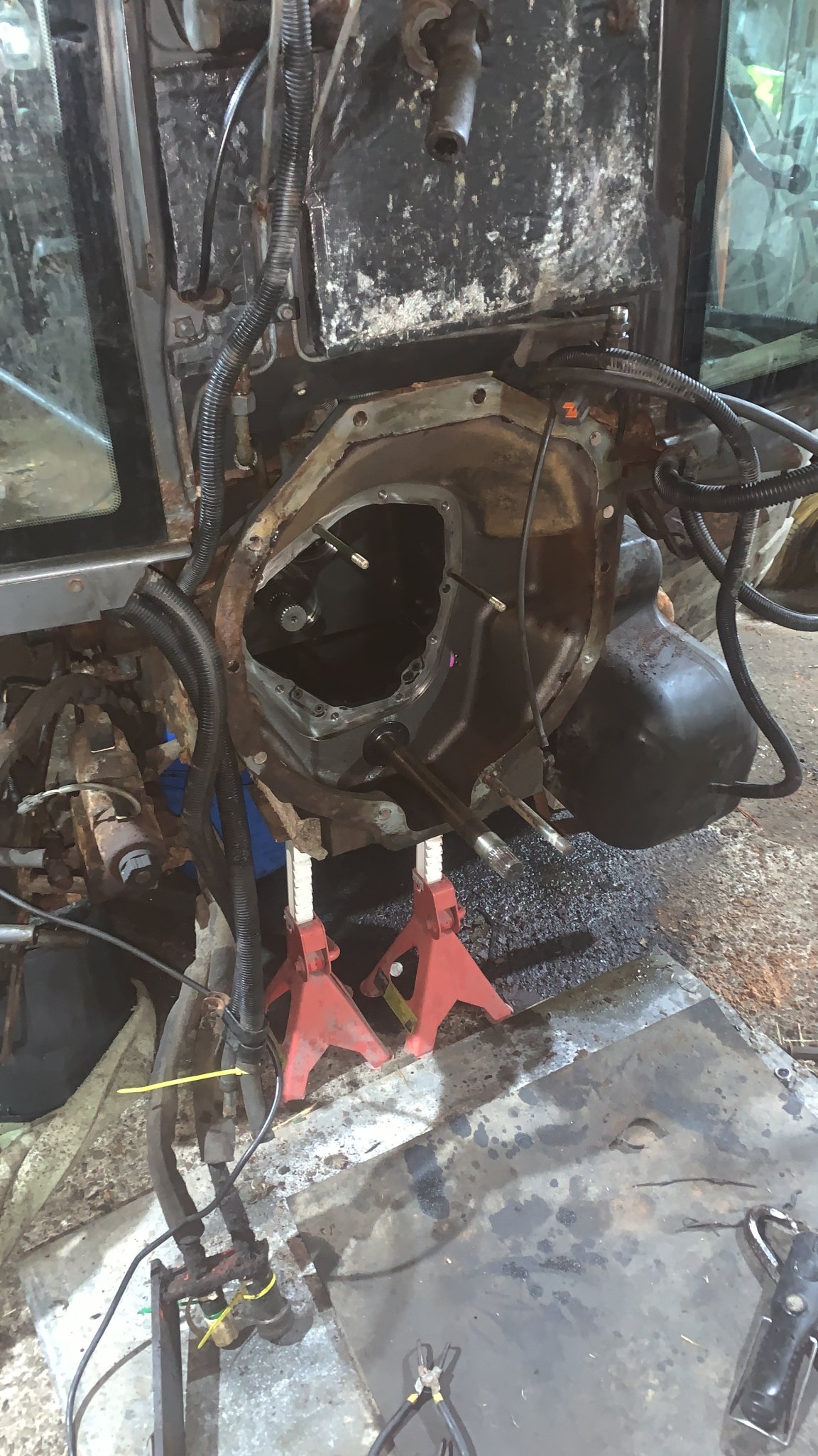

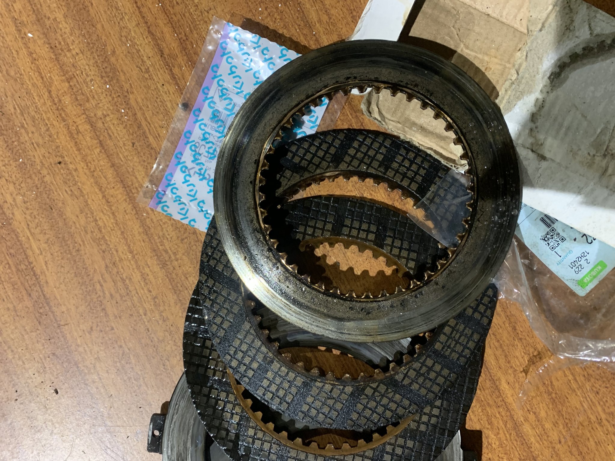

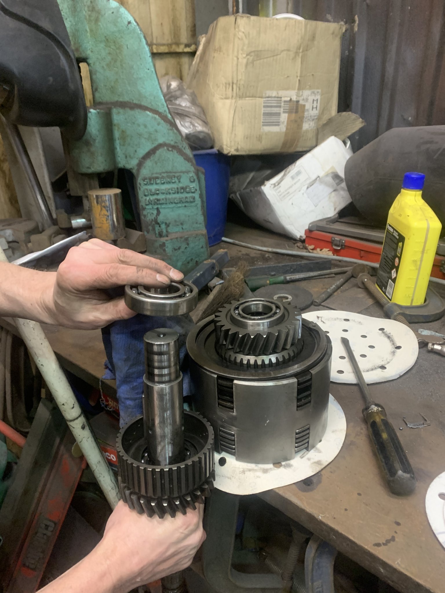

I have a M9540 tractor
I bought the tractor 🚜 from my neighbor as I had really slow drive.

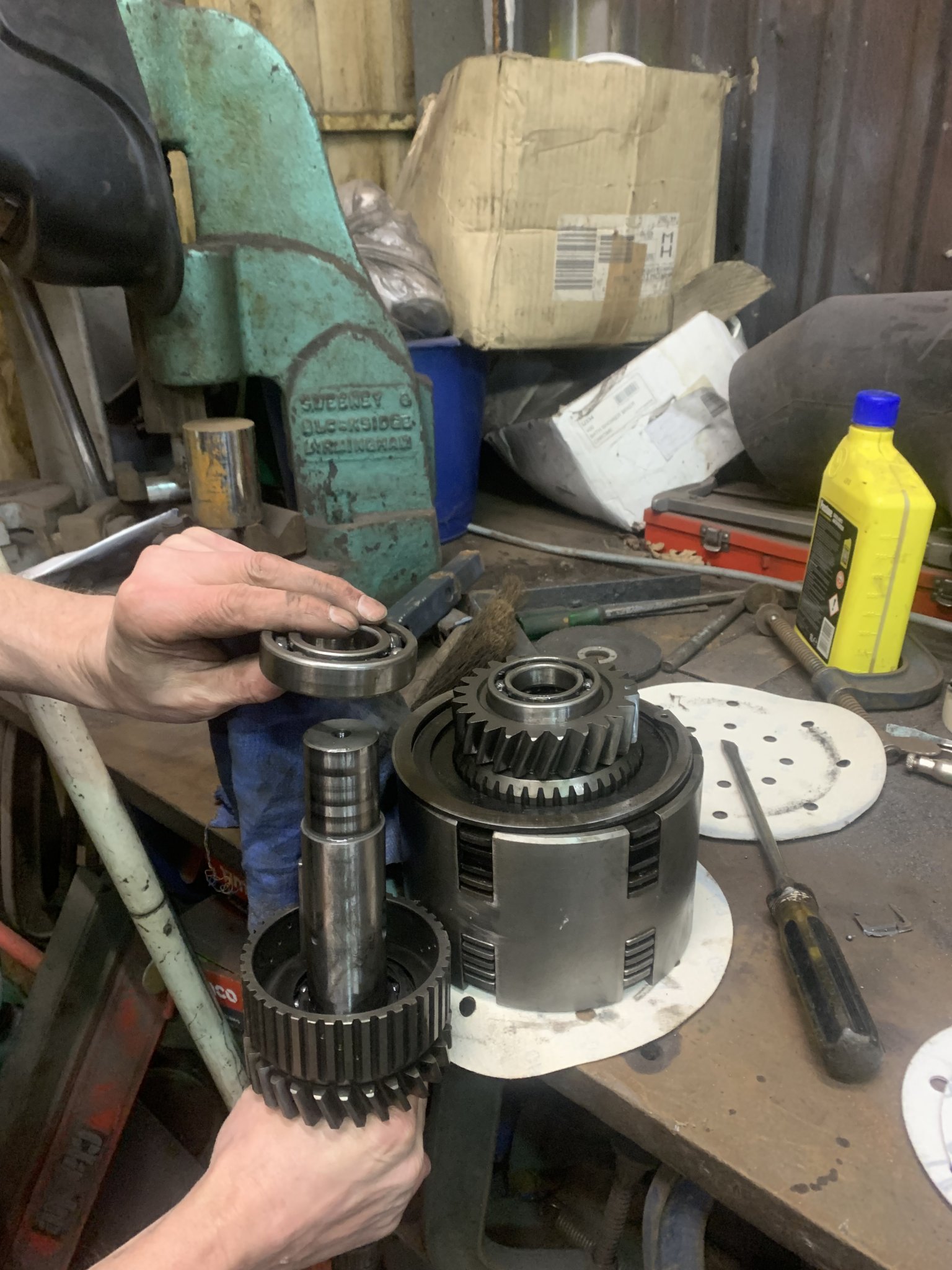

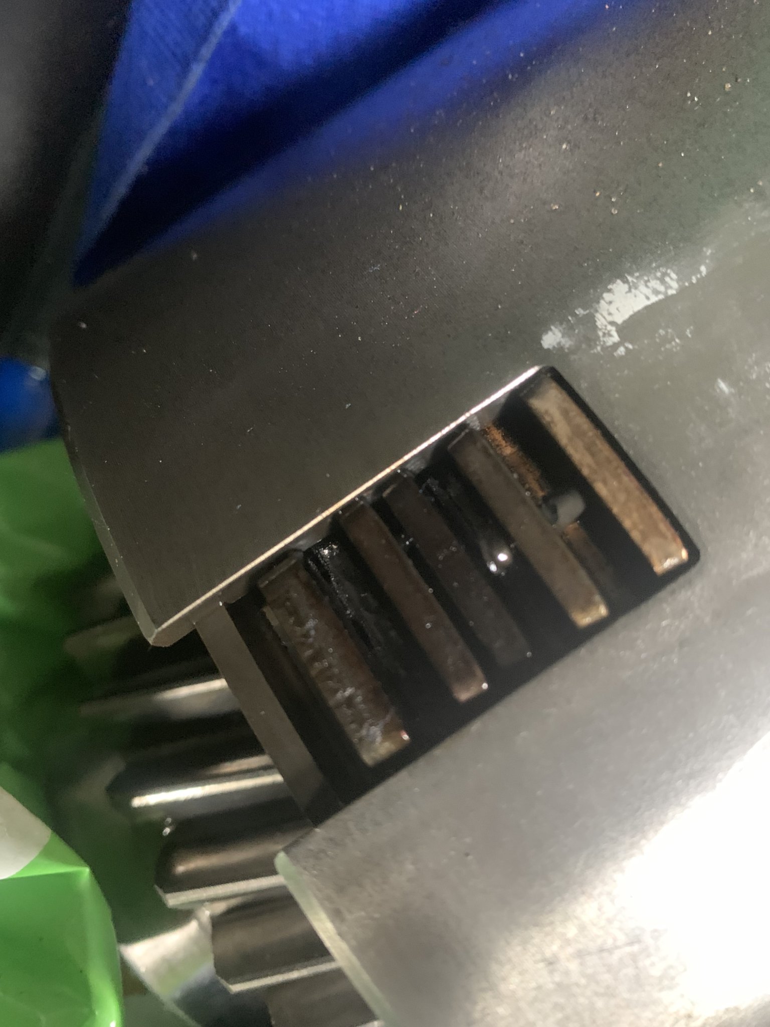

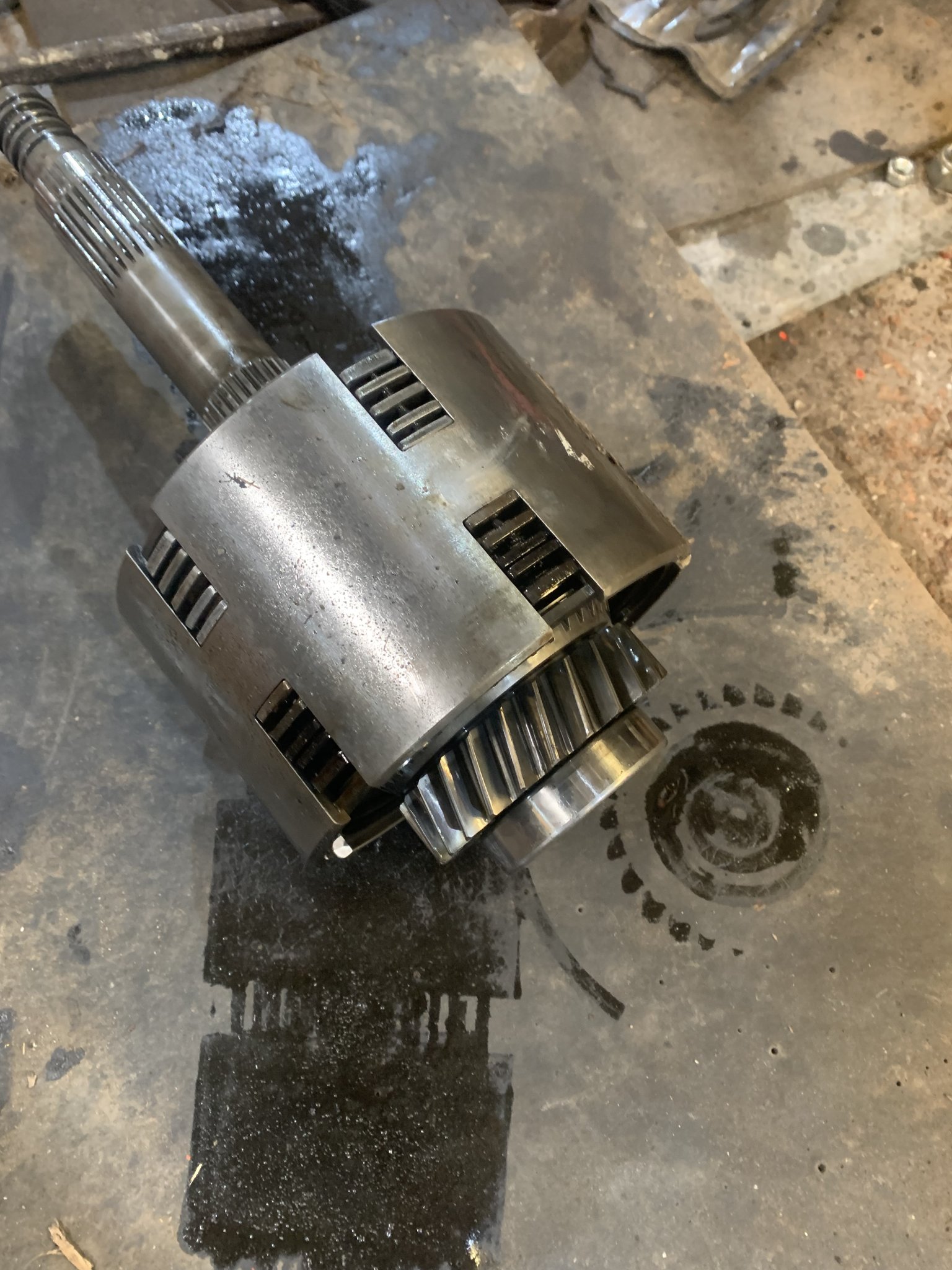

I suspect the clutch pack had gone. So I split the tractor and yes one side had totally burned out was happy to of found the problem. Changed all clutch plates and metal spacer’s put some photos. Built it back up. Changed all the oils and filters and have nothing at all no drives. Does anyone know if it has to be bleed or primed or what makes the clutch pack work ? What pump to check for drive
Many thanks for any helpful advice and information

Of course I have a workshop manual and didn’t tear it apart DH . I diagnosed the problem as the clutch pack and was completely correct as the pictures ℹ showed and stripped it and rebuilt the clutch and the tractor is back together was looking for help or information

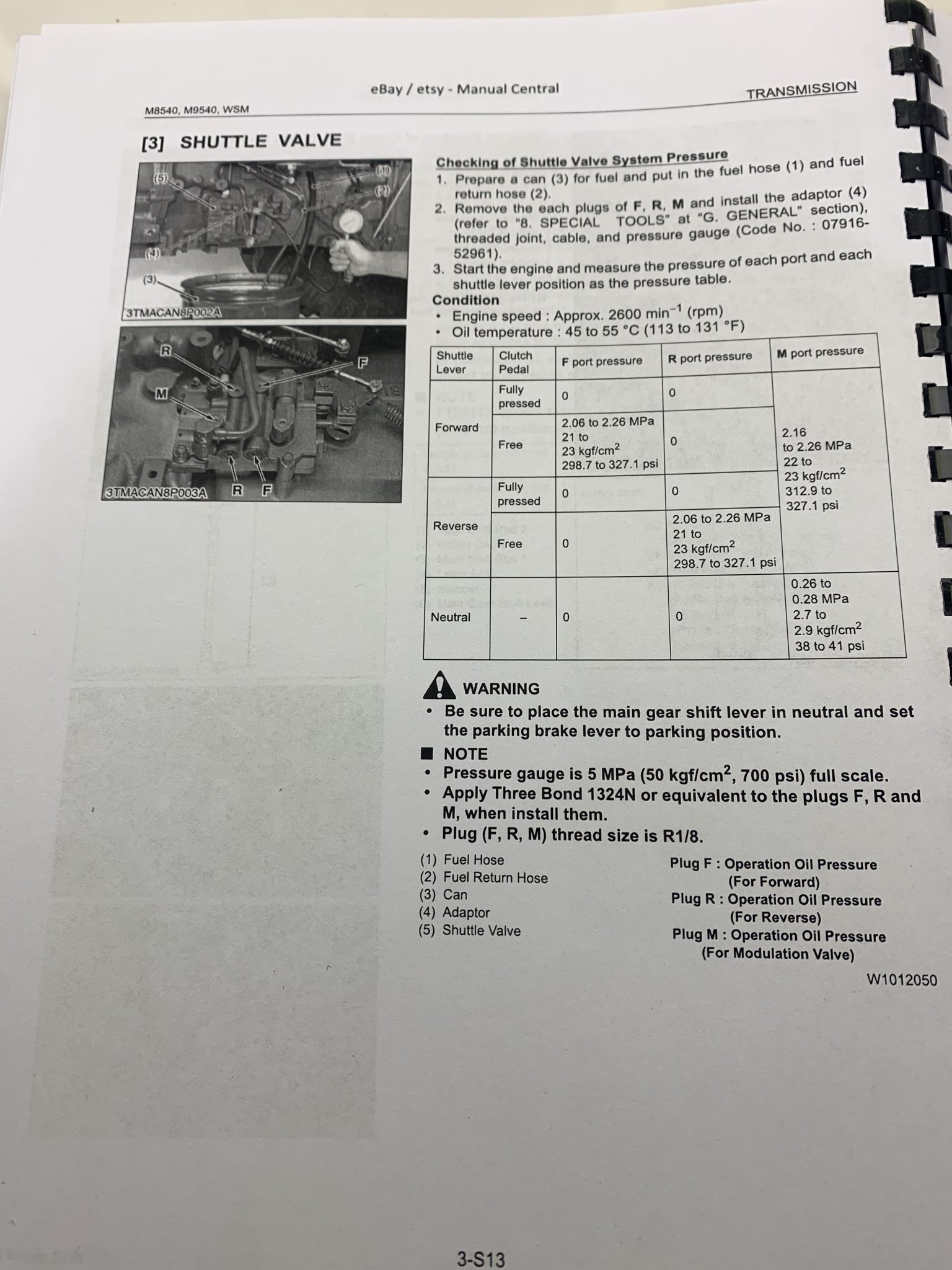

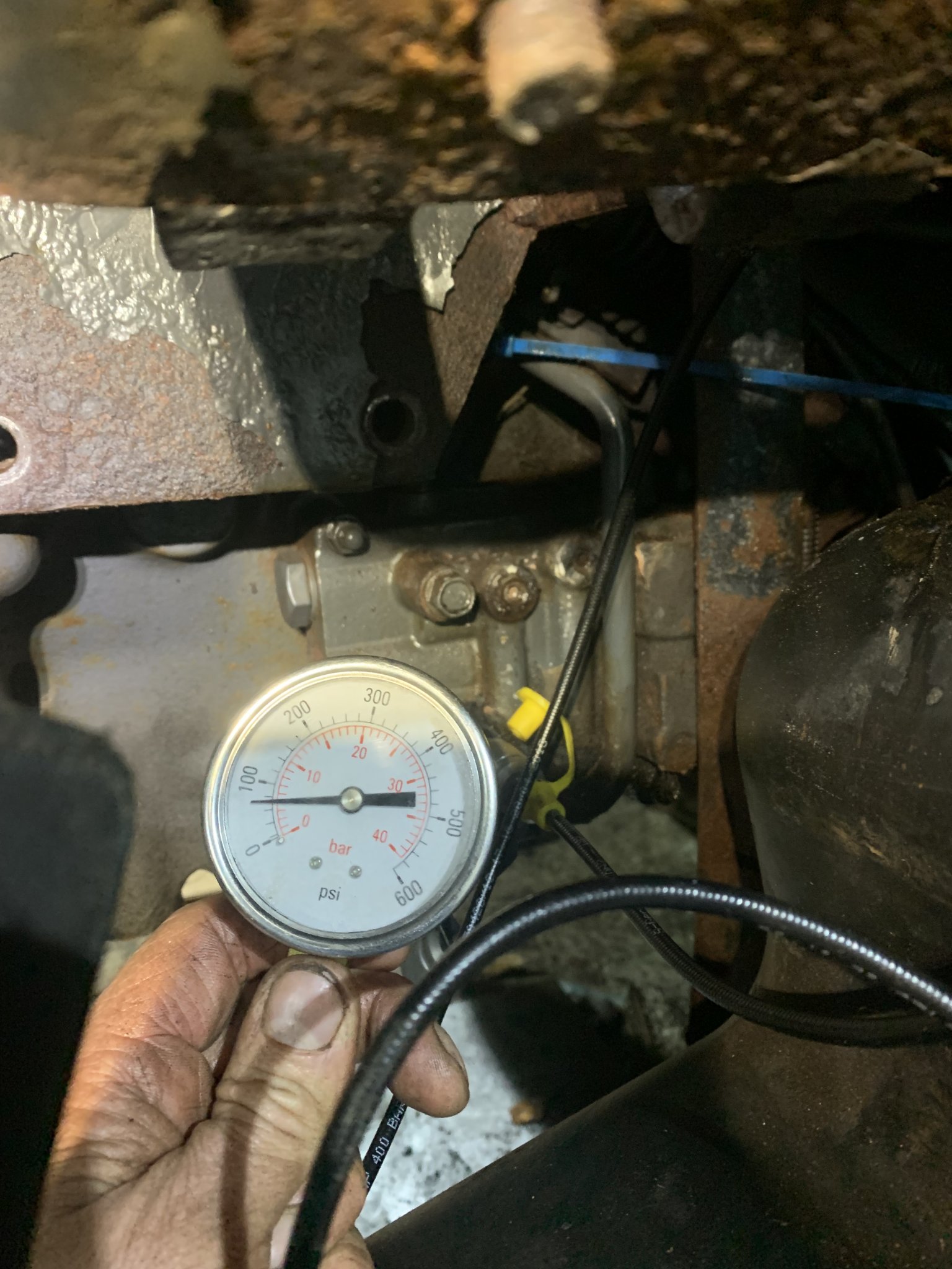

Okay, you have the manual. I'm no expert on this model by any means, but I can find my way around/through a manual if I have one. As I see it, the shuttle valve is supplied from power steering return flow. Do you have steering? Do you have PTO? All of that runs off the steering pump section.
The manual shows test ports on the shuttle valve. It says the pressure to the clutch packs should be 300 325 PSI. Do you know if you have that?

Like @Fedup said, what and where you have hydraulic pressure would be a good start.
Did you tear into the entire sump and get all the clutch material out, as it could very well be clogging up that suction side of the system.

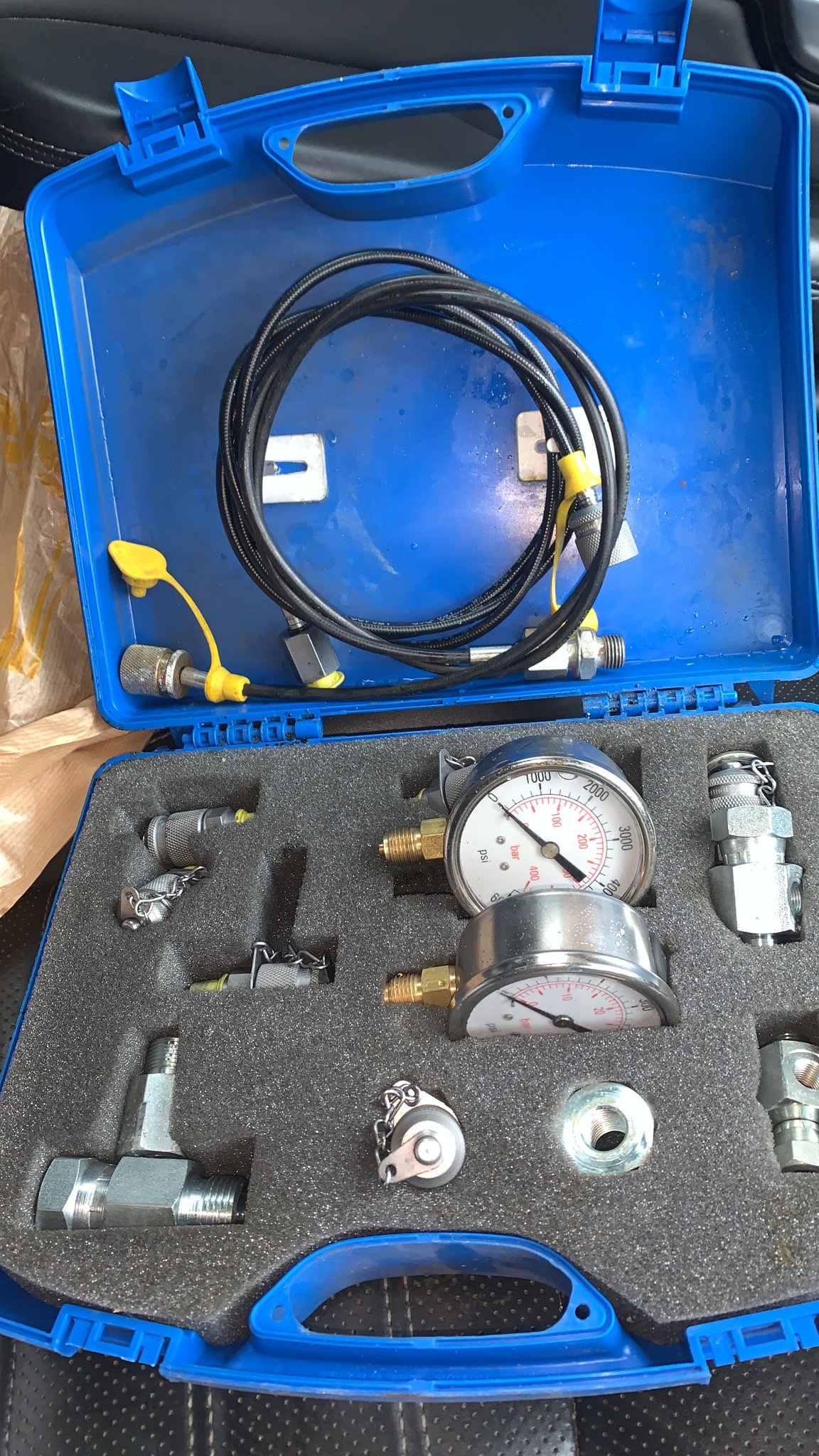

Hello Fedup
I have come Today to check the psi as in the WSM and I have a faulty valve so
Hello Fedup
I have come Today to check the psi as in the WSM and I have a faulty valve so am no further forward but will have a full updated
Tomorrow included some photos
