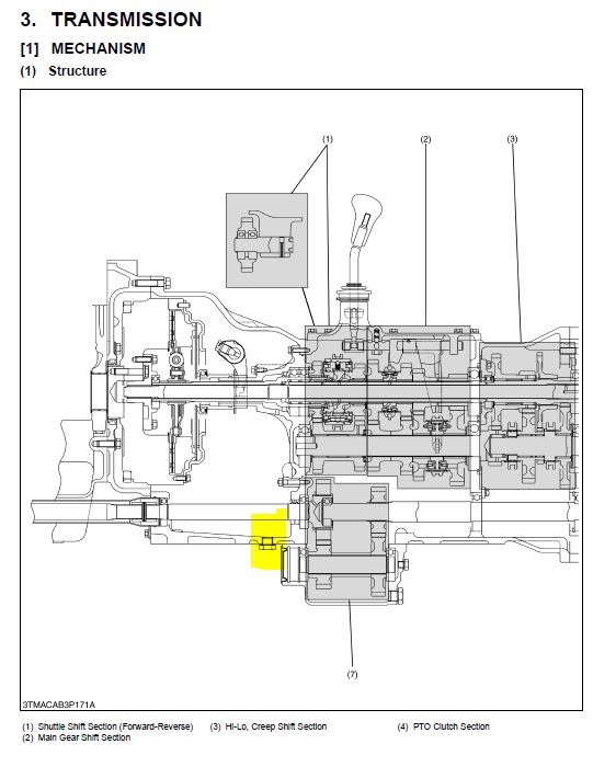

There is a plug in the bottom of the Clutch housing that you remove to allow it to drain any water out.
It might have a little residual Hydraulic fluid in there (front propeller shaft seal leak), open the plug and let it drain.
Then using a long straw or tube spray some WD40 into the hole.
and when you pull the plug fire it up and let it just sit there and Idle this will help heat and dry it out.
Thank you a lot for these advises.
So if I am reading this correct, it could be water in the clutch that is normally dry? So when I open up the plug there will be only water coming out and not a lot of hydraulic fluid?

Yes only water, there might be some ( slight amount ) hydraulic fluid if the seals for the propeller shaft are bad.
