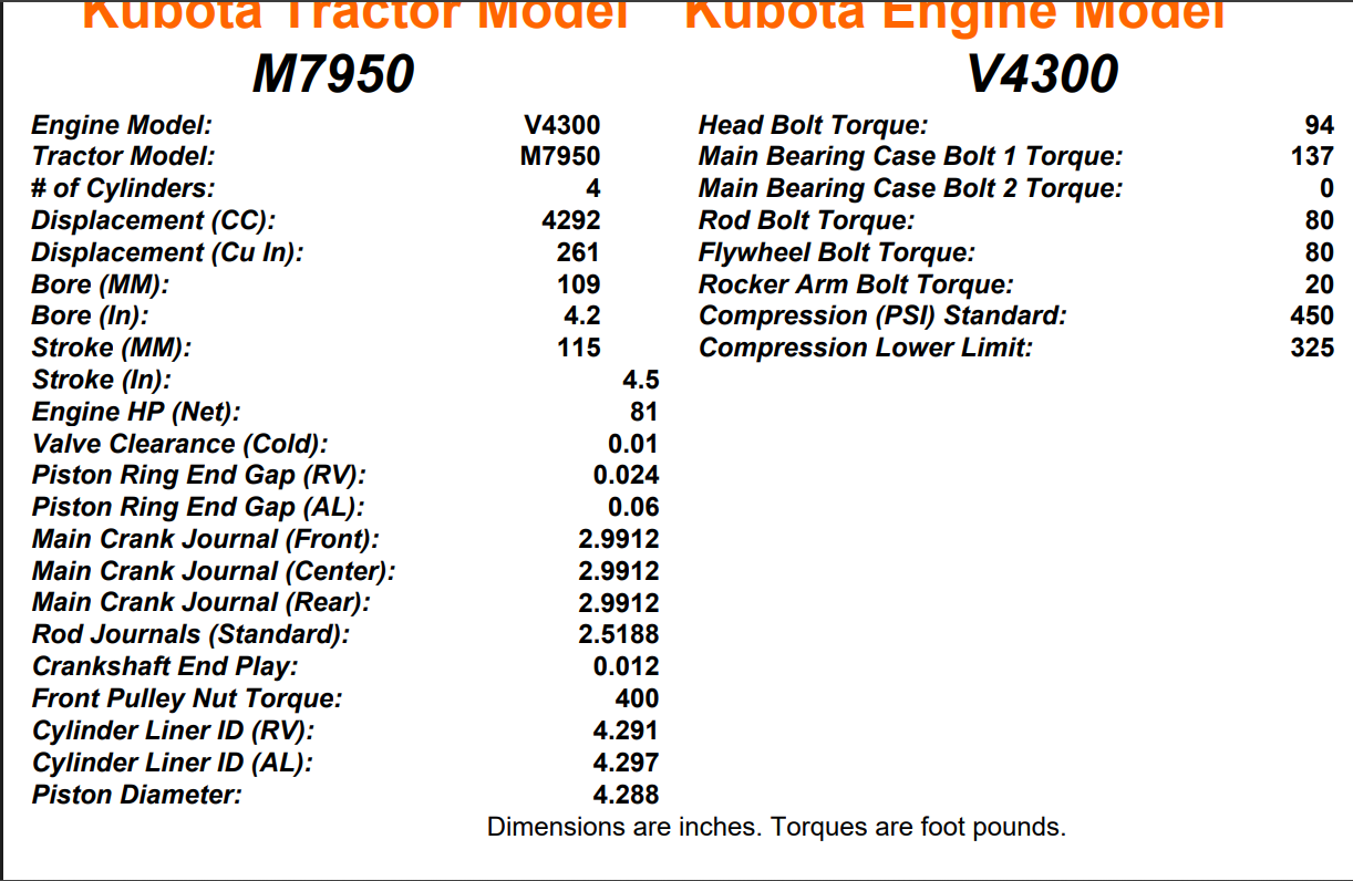

M7950DT flywheel bolt torque specs
Fishineb
M7950DT
Jun 20, 2025
Wondering if anyone has the torque specs for the flywheel bolts for an m7950dt? I have the wsm for the tractor itself but not the engine so it’s not listed in there. I’ve got a rough idea from others I’ve seen but would feel more comfortable if I could get the ones specifically for this.
