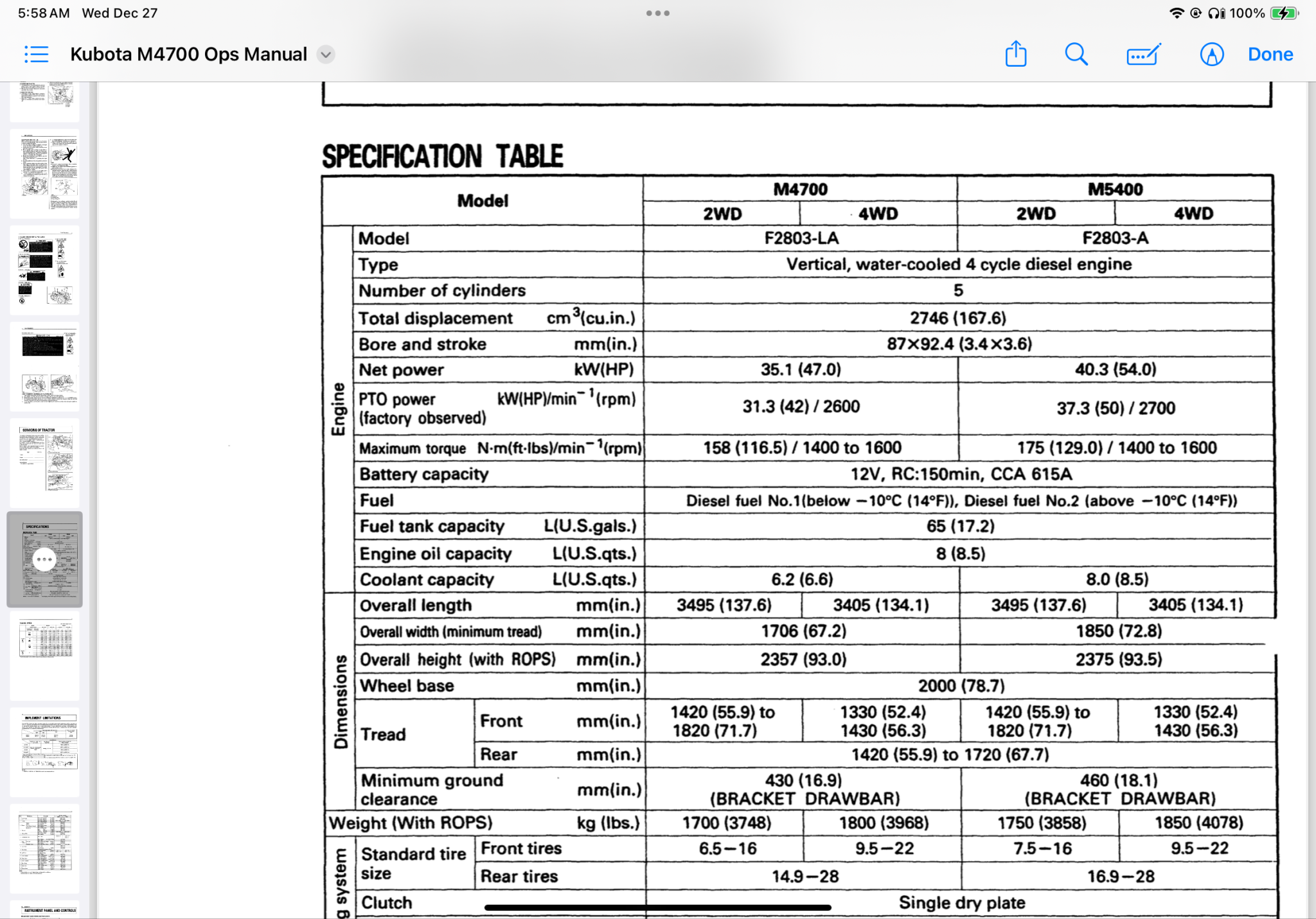

Not the same tractor/model comparison….but my M4700 had a slightly more powerful big-brother…the M5400… virtually the same tractor but with more HP. But that HP increase was due solely to a higher operating RPM (only 100 more at that) used during the specification… all the other capabilities were identical….same implement capacities, sizes, etc etc. The only real difference was the M5400 was spec’d out with slightly larger tire sizes…which…as it turns out….were also available as an option on the M4700…AND which were already ON the M4700 which I happened to have purchased. Doh.

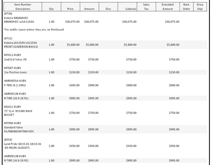

I have the M6060 and the actual difference is 7.5hp net, and 8hp at the PTO. I bought the 6060 off the lot from a dealer in Sheridan, WY but had I ordered a tractor it would have been the M7060 with the F12/R12 transmission and I would have added the creep range as I did to the 6060. The increased oil flow, electronic 4WD, and better transmission are worth the price difference. The engines are the same and there are affordable options to bump up the 6060 power output so I wouldn't focus on the hp difference.
Are those prices for the bare bones tractors or are there any options included? Are you looking at cab or open station? I paid $40,075 out the door for the cabbed M6060 tractor and options listed below, but that was in April of 2022.
