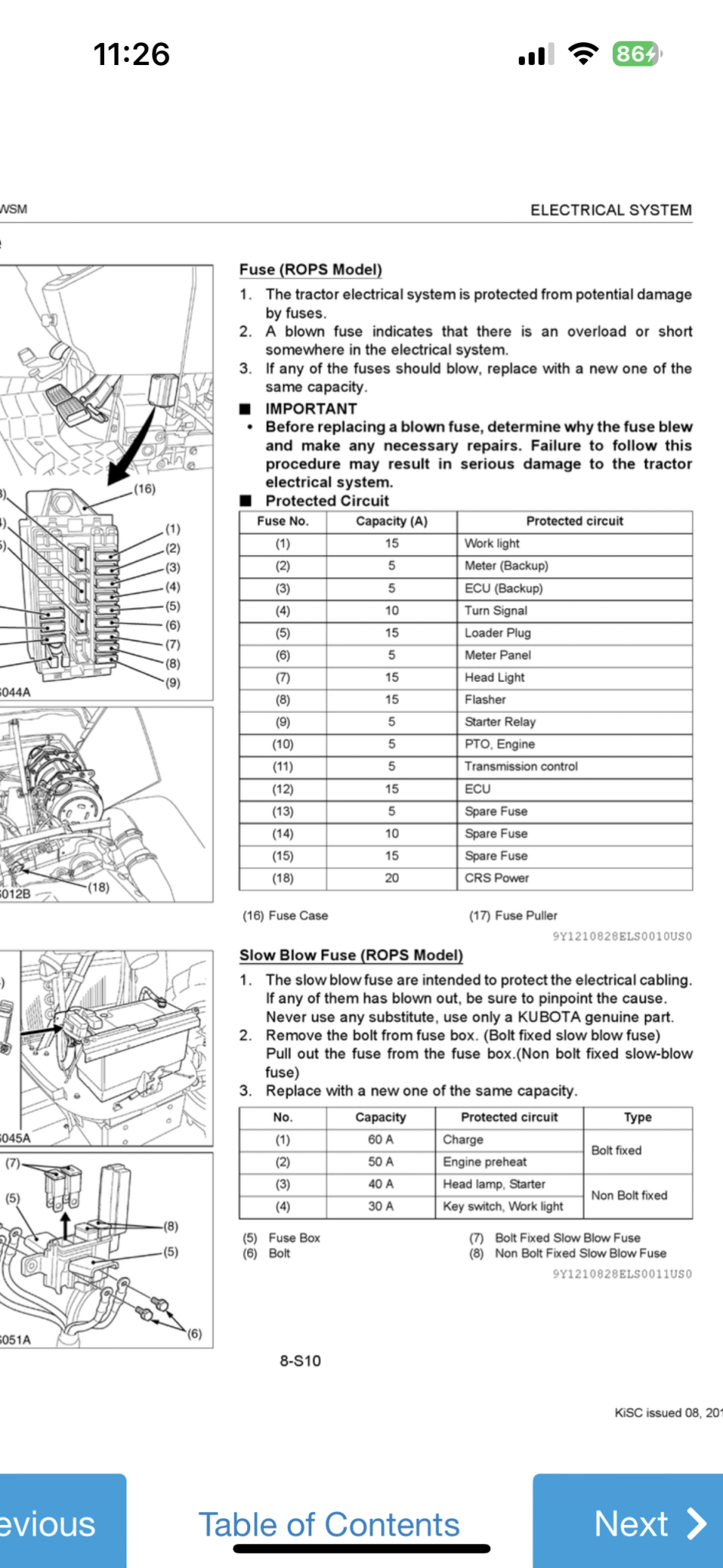

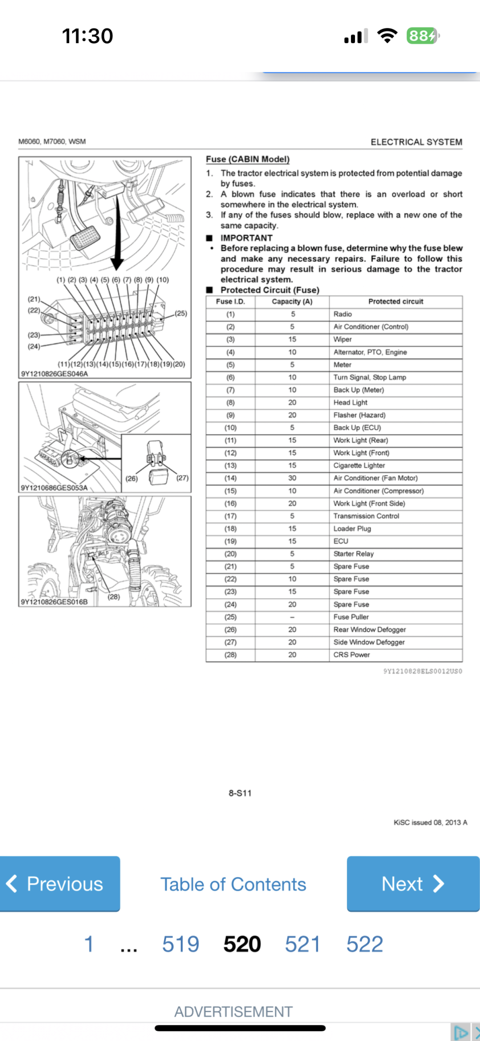

Maybe a bit more info would help. Cab or Rops? Both have a different fuse box location and fuse number setups. Quick search showed me only the rops had a 5amp fuse labeled pto,engine fuse number 10. Is this the fuse that’s blowing? Will it do it without pto engaged?

Are you talking about the ECU (backup) 5A fuse? You’ve sorta tied an injector replacement, a DPF regeneration malfunction code and a PTO operation all into one that’s being stopped by a mystery fuse.
ROPs

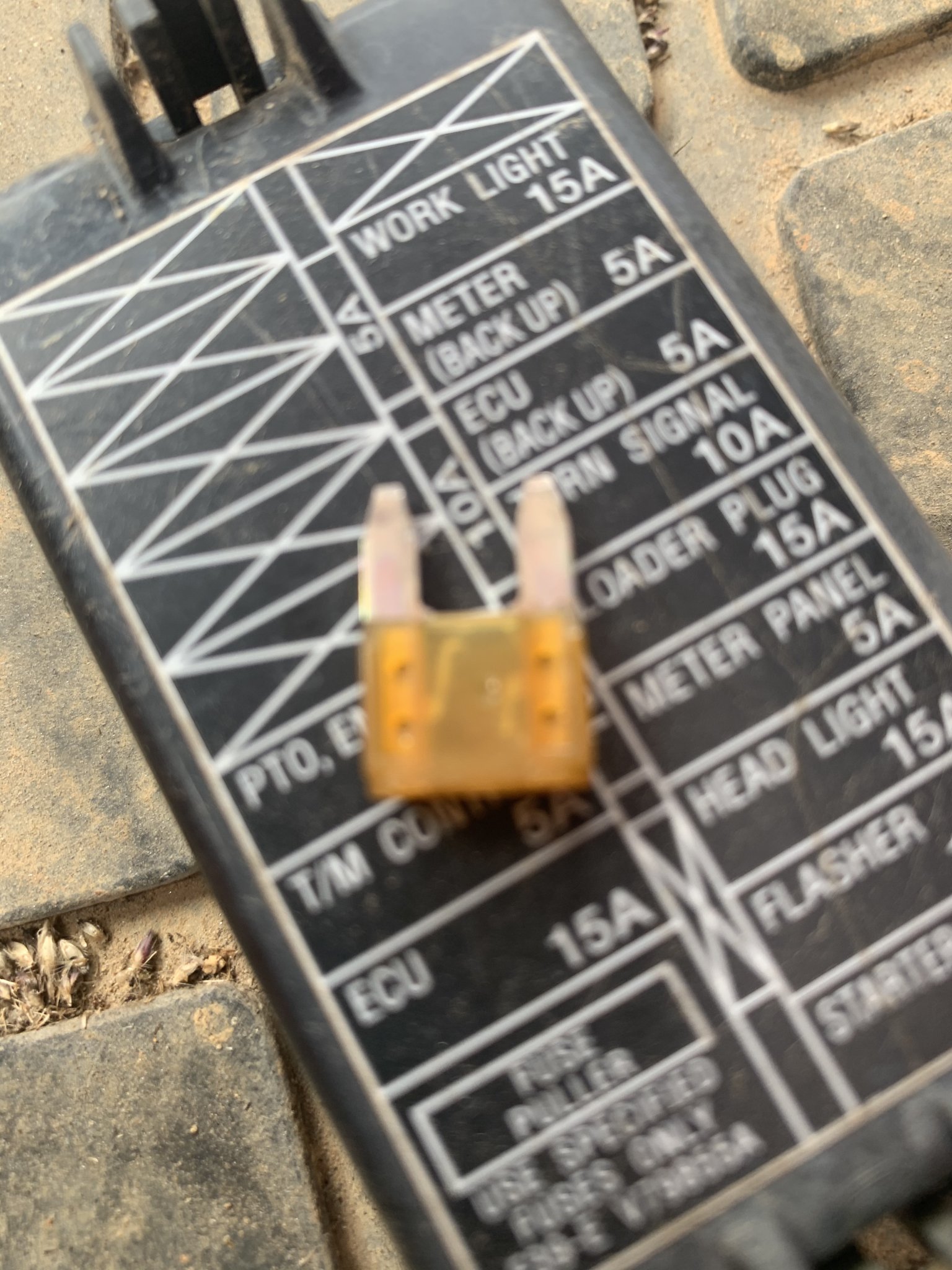

Brumleyson
M7060 726G
Oct 17, 2023
12
North Carolina
It’s the T/M fuse

Transmission Control. I guess Tran Cont or T/C didn’t cross the label maker’s mind. Crazy!
