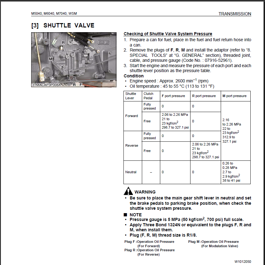

I have not checked them as of yet. Need to remove wheel, fender and fuel tank. The tractor would not be warmed up enough to duplicate the problem. So at cooler temps I would suspect good readings because there is no problem when cool. Thanks, Mark.
Remove the wheel, and remove the fuel tank. Install a gauge or gauges. Fix a 2.5-gallon jug in place under the operator's platform, fill it with fuel, and insert the suction and return fuel hoses in the jug. Tape the hoses in place. You can now run the tractor and read the pressures.

If the pressures are wrong, what is the next step? The manual does not say. Can there be a problem elsewhere, or is the valve the problem?
I have previously considered doing what you said, But my holdup is I need the tractor for haying right now, and that rear wheel is loaded, weighted, and has a cast center. I'll need another tractor to lift it and move it. And I'm not young anymore!
I also was really hoping someone else would have had this problem so I would have some insight. I have asked around - 2 dealers, another forum and a few tractor mechanics -no one else has heard of this happening.
So anyway, if the pressures are right, or, wrong, what is the next step? Thanks, Mark.

The answer to the question about the next steps will be to then adjust the pressure if it is lower or higher than specified by adjusting a relief valve or two in the system, replace pump if pressure is really low, or replace tubes or hoses if they are damaged. It may be a control valve that is damaged or malfunctioning that needs to be repaired.
The workshop manual should have a description on what to check and then suggested steps to take afterwards. Is there not a troubleshooting section for the transmission?

First of all, the manual does not say what to do if shuttle valve pressures are wrong. I agree that it should. I was at a Kubota dealer and we both read it again on his computer (I have it downloaded at home) and he was surprised too. The only trouble shooting for the transmission concerns the transmission gears- nothing about the shuttle not working. I should have added I checked the hydraulic pressure at the remotes when the problem occurred, and it was about 2700psi, which meets specs.
I have studied the hydraulic flow charts for the shuttle valve in the manual as best I can, and my suspicion is that the modulator valve sticks for some reason. As best I can tell the modulator valve is common to both the clutch pedal and the shuttle shift lever. It never matters whether you depress the clutch or change directions with the shift lever, when the problem is occurring, the tractor won't move until I lower rpms. It has never happened when it was cold. It only happens after running at high rpm for over an hour working. The shuttle valve does appear to be able to be disassembled. Thanks, Mark.

I did some searching and re-reading, and actually I have read this before. The hydraulic section is only about the pump and the 3pt lift, does not even say anything about the remotes. And nothing about shuttle problems. Even the transmission section shows the shuttle's hydraulic flow in every scenario except letting the clutch out. Shows it released and depressed, the lever forward, neutral, and reverse. If this info is there, I cannot find it. And it tells what the shuttle valve pressures should be but nothing about if they are wrong. Thanks, Mark.

All the information you need is on pages 3-M7 thru 3-M12 and 3-S13
It shows all the test ports and all the pressures to expect at each port under different conditions.
You mentioned checking the pressure at the remotes, that really doesn't tell you anything about the pressures of the shuttle valve.

I was pointing out to someone that replied that the pump was ok. I have read this info about the shuttle pressures, but it does not say what the next step is if they are wrong. Which, I guess, has been my main question all along. I even read this info with the local dealer, and he agreed that there was no info what to do if they are wrong. I do have the same manual, and I do appreciate your efforts. Thanks, Mark.

The pages 3-M7 to 3-M12 have the instructions on the bottom of every page on what part needs to be serviced if the pressures are wrong.
34,361
9,592
With all due respect, I don't see any instructions at the bottom of any of those pages. I just read what is going on in a correctly operating valve. Thanks, Mark.
Exactly, you read what is going on with a correctly operating valve, so any deviation will point to the problem, be it the proportionally reducing valve, the shuttle valve, the inching valve and so on.
It's a testable process of elimination.
Do all the pressure tests in all possible test scenarios and it will point to the problem or problems if there are multiple issue.
Testing these kinds of issues is a simple matter of you will see this pressure or the lack of pressure (bad behavior) and it will be caused by this fault (bad part).
