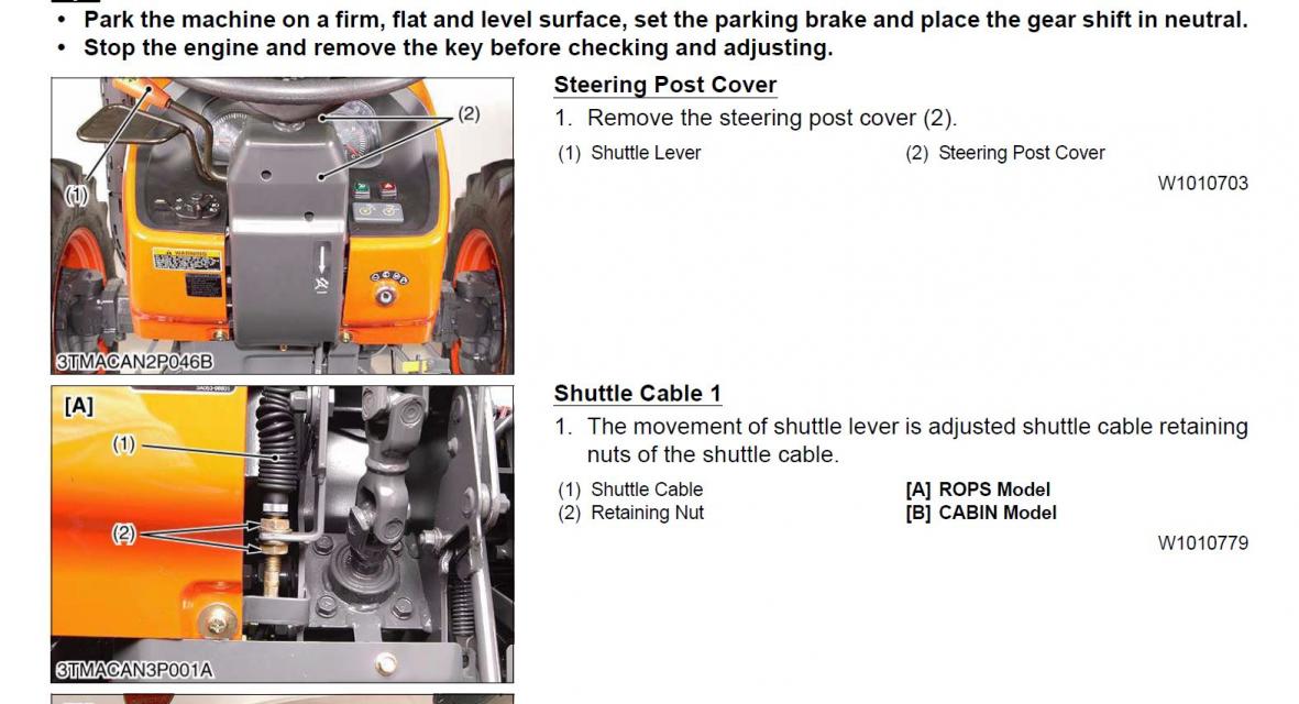

The F/R shifter is controlled by a cable. Here is a photo of the WSM on how to adjust it. It may just need an adjustment (or not). Good luck!
