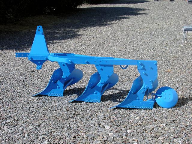

I use a 3 X 14 3PH plow and it works just fine. However, a 3 X 16 might just be a little too much for the tractor. It is a bit light for that much drag (depending on soil and conditions of course). I've had the plow want to spin the tractor...tail wagging the dog type of thing.

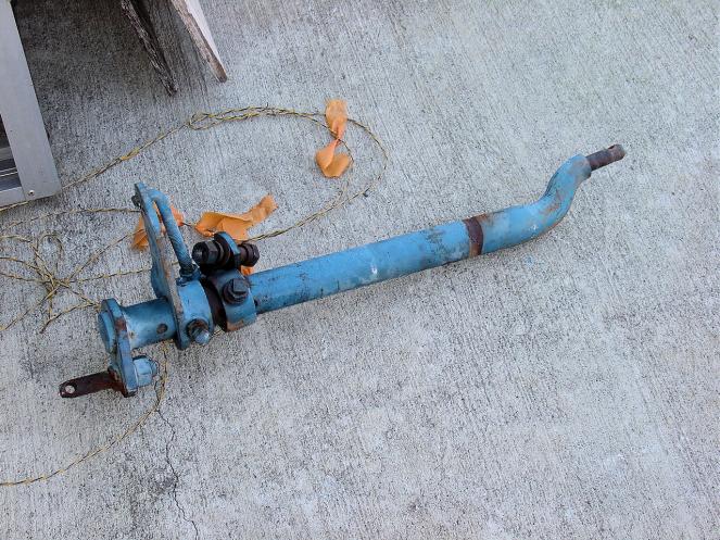

The tires run in the furrow just as necessary and I have a CAT 2 cross shaft. However, the CAT 2 shaft is an addition that was welded in place of the CAT 1 OEM shaft. Turns out the CAT 1 pins were too short to be bushed and fit on the CAT 2 tractor's balls.
The right side of the CAT 2 shaft was lined up so the CAT 1 lift pin and the CAT 2 lift pin were in the same position.
Not sure if this information is of any help.

Thanks GWD. That looks like a Series 101 Ford plow with Oliver bottoms. I owned one a number of years back and converted to a cat 2 using a John Deere cross-shaft. Surprisingly, it worked. Does your 7040 have cast rear wheels? According to the manual it adds 700 pounds. Without the 700 pounds I suspect a 3x14 would be a chore to drag behind and based on your experiences I would have to say my 3x16 Kvernland plow is out of the realm of possibility for a 7060. Thanks again for the feedback.
Indeed, the plow in the photos is a Ford 101.
No cast rear wheels, just filled tires. The rears are not so much of an issue but the fronts will almost leave the ground unless the FEL bucket is on and the bucket has a load of dirt in it for a front counter-weight.
This is not a complaint about the tractor, just that it needs some "adjustments" to make sure it works perfectly. Plows work best behind weighty tractors as you already know.
