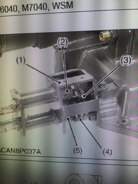

Found the problem i wanted to share it so if any one else has it they know what to do. IMG_1728 (002).jpg when you raise the lift these little cams rotate. There not hooked together but the one that goes inside #3 in the pic was sticking in the bore. This happens when (like in my case) the tractor was used in a chicken house or a very dusty enviroment. A lot of oil and some working freed it up now works fine.

Hi David - just reading your thread as I am having a similar issue these days with my 2011 M7040. The diagram you posted above - is this to the left on the rear side of the tractor behind the seat? Just trying to get my orientation. I have tried a few different things with no luck so looking to give this a try.

That valve is to the right hand side.
If you give more details of your issue and the exact model as there is 19 Sub models of that tractor, and the controls vary greatly from one sub model to the other.
