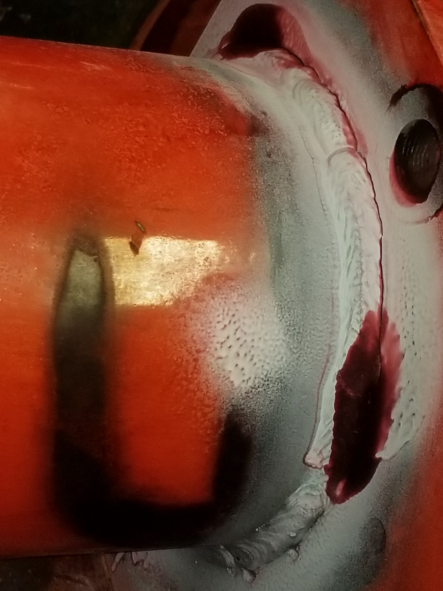

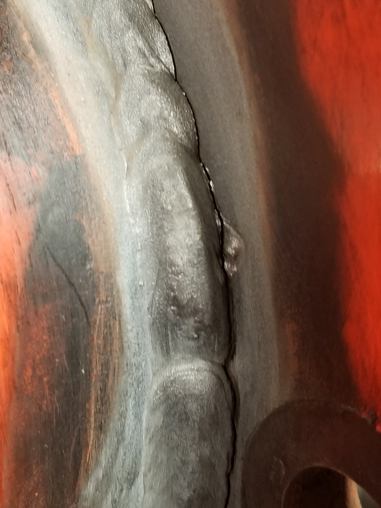

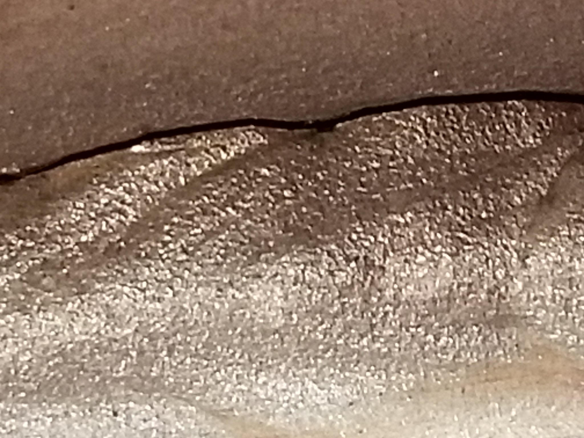

Have th LA1153 loader on an M7040, 3600 hours and the right side loader mount bracket is cracked all to heck.
The factory bevels that 3/4 thick plate but the weld never penetrated the bevel for more than half the circle. Can split the layers with a pick after grinding it down. Lots and lots of grinding to a clean root then 7018 stick welded.

My experience with the Welding on Kubota stuff is just the opposite. Excellent penetration and good under cut, recently rebuilt an excavation bucket for a customer and had a helluva time gouging the welds off and resorted to a thin kerf cut off wheel to undercut them.
I would never stick weld them myself, bit then I own an ESAB pulse MIG. MIG is the only way to go in that situation where the weld is not in a flat plane. I agree the weld appears cracked in the root but not being there to look at it, not sure if i9t's totally failure prone.
Only time I resort to stick welding now is in the field, using my gas driven welder. In the shop, always pulsed MIG or TIG on alloys.

Vibration is an enemy of welding. After 3600 hrs. of operation it's possible that was the main cause. However it does appear to be a little light on penetration.
7018 is a good rod for mild steel

I agree. 36K is a lot of imposed stress. Still would MIG it, not SMAW it.

7018 is a good rod and stick welding it was also fine, IMO. (Lot of ww2 ships, dozers, and tanks built with sticks and did just fine.)

Normally Id not fret too much but this weld had a lot of stops and starts. Gouging it out with a grinder I was surprised to see the weld area turning blue. We knew we had a problem, cleaning the area when carb cleaner squirted out the opposite side. Chased all the cracks back but the welding dust was gathering on the edge like a magnaflux test so there may be others in the future. I really enjoy having the dye penetrant test available. Oxy torch is the fastest way to de-paint a weld area short of a big sandblaster.

Welding your loader with 7018 rod is a good choice. The main issue is getting the heat right. Too cold and it will break. Too hot and it will undercut creating stress risers which will break.

Oh heat was good, five layers of beads. I feel I have good puddle visibility and can see any potential issues, pause, needle gun and a whip of the grinder, spark it up again, mig can be so fast that you might miss an issue. The factory had a nice bevel but zero bonding to the plate and a decent attachment to the tube

Not looking at the weld root, only the top of the weld bead. I'd say the welder had the MIG nozzle at the incorrect angle and the amperage not high enough for the gauge of material and should have more closely reviewed his welds. Not withstanding, with that many hours (and stress) on the loader components, the weld, if faulty in the root, would have failed long ago.

the factory welds them continuous, in a rotating positioner, via robotic GMAW process
with that said, I have not specifically see a loader frame come out with any issues, but I have seen a couple backhoe issues; one was actually marked "porosity" on the boom, with an arrow pointing toward the upper (stick) pin mounts. I saw nothing wrong physically, but Kubota Replaced that one. And I seen one that had poor weld quality on the lower boom mount, also replaced but against the wish of the manager. Got my butt chewed but it was worth it.

Well if that's true, that robot needs to be fired and crushed. All the welds on this piece are awful with stops and starts and really poor fusion. Really looks like a brand new welder on his first day after he left the accounting department.
