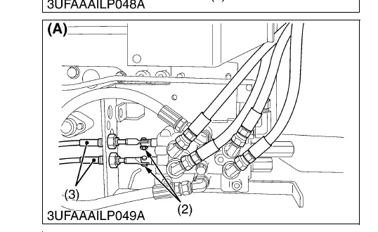

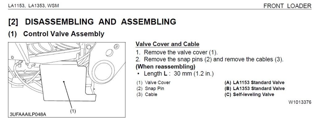

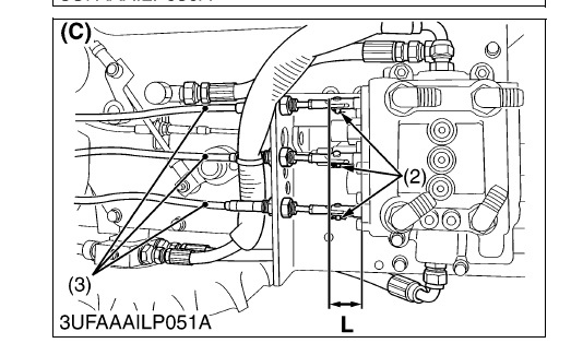

Jim
There are "Load Checks" not simple check valves.
If you send me your email in a private message I will give you FEL WSM which has detailed operating illustrations.
Dave
