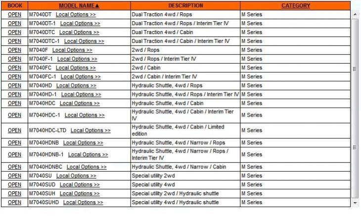

This was one of Kubota's most popular models and there are many model variations and they span many years, and the systems changed over the years.
Please give the exact model.
