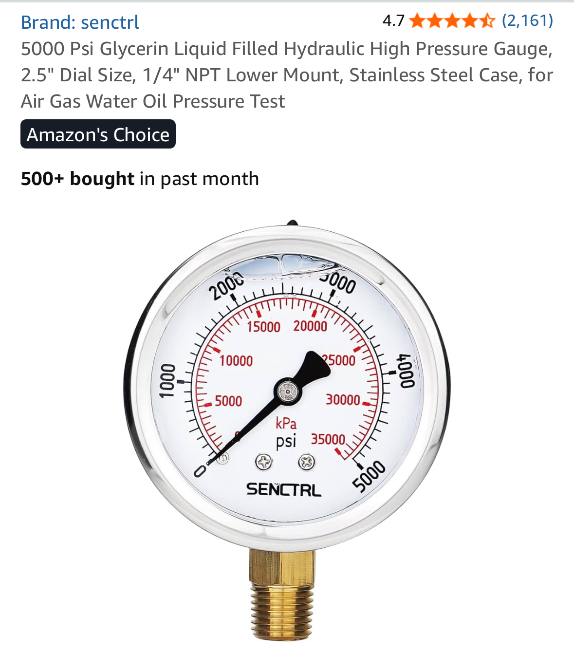

I would suggest a couple simple tests. Conduct each test before the oil is warmed up and again after its warmed up and you are loosing lift.
  1. Check for cylinder bypass. Remove the small return hoses on the lift cylinders and check for fluid when you raise a heavy load. Ideally there should be none.
  2. Measure pump pressure. Plug a pressure gauge into your rear remote and operate the control lever to get a pressure reading. Factory specification is 2770 PSI.

I am only getting about 1300 psi at the rear remote.

There arent many places to use as test points in that plumbing.
Kubota wants you to use a "special tool" (adapter block) to connect a flow meter to the outlet flange on the pump.
There is also a joint in the delivery pipe that looks like you could hook up there with a simple hydraulic fitting. That would be my first choice.
In either case if you dont happen to own a high dollar flow meter you also need to construct a pressure test rig from some hose, a needle valve and a pressure gauge. Pretty simple. You up for that much work?
