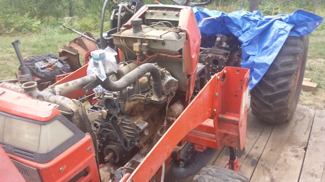

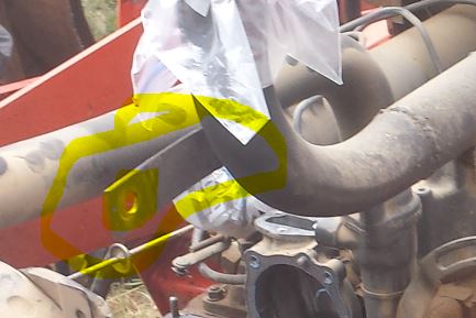

Looks like you can unbolt the exhaust flange and rotate it 90 degrees.
It may line up with the exit hole, or a custom pipe with a bend can be made...
Muffler is then eliminated...
A glass pack can then be put on the exhaust stack...
Cherry Bomb make some short (8 inch) glass packs, 12 inches total length...

I just used a simple generic muffler, as it was very light weight.
To support the pipe and the muffler I used a simple mount on the pipe, because there is no motor mount, anything you mount can be solid.
