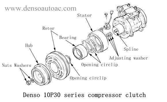

The stator (clutch coil) in the compressor clutch may be failing. The stator is a coil of fine copper wire. Typical mode of failure is gradual corrosion or cracking of the internal connections, failing open as they heat up. I've had a couple Denso stators fail like this. Eventually they stop working at all.
It may work ok on startup, but as the engine (and compressor) heat up, the stator coil can become an open circuit. Test by taking the plug off the stator and checking resistance across the terminals. It should be around 4.5 ohms (cold).
AC cycling on and off is often due to low refrigerant level - but a bad stator can cause it too. If its borderline the heat of being energized can make it fail, working ok again when it cools a bit.
Attached drawing is a typical Denso compressor. The stator pulls the hub and rotor into contact.
Dealers typically replace the whole compressor. Hope you rig is still under warranty. Compressor replacement can chew up a thousand-dollar bill - a new Denso stator can be had for $65. (one model fits several compressors) In a car the labor charge can be high - should be better access on a tractor.
