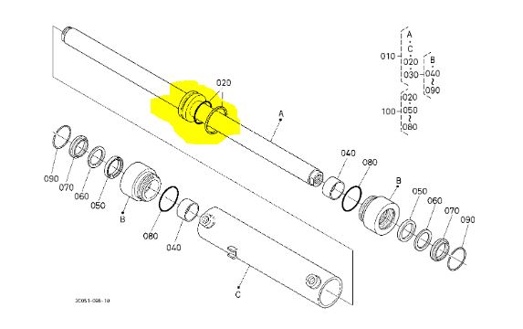

You most likely have a have a blown seal in the steering cylinder.
You can verify this by removing one line off the cylinder, attach the loose line to a bucket to keep things from being too messy also leave the bucket under the open port on the cylinder, turn the wheel in the direction of the open port, a little fluid will come out, the cylinder should go to the end of it's stroke then if fluid is still coming out 100% damaged seal. ;)

Does not seem like I'm getting pressure to the cylinder wheel spins freely manual steering with tractor off does not work and no leaks. Thanks wes

It will do exactly that when the seal is out, as it will just pass fluid around in a loop from the tank to the steering controller to the cylinder, then past the seal and back to the controller and then back to the tank, you will not see a leak externally, it's an internal leak.

Do you happen to have a part number for a cylinder rebuild kit? I will have to look at the hours the next time I'm out at the ranch. Thank y'all
