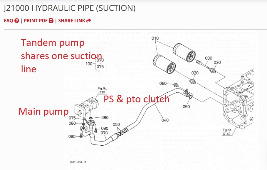

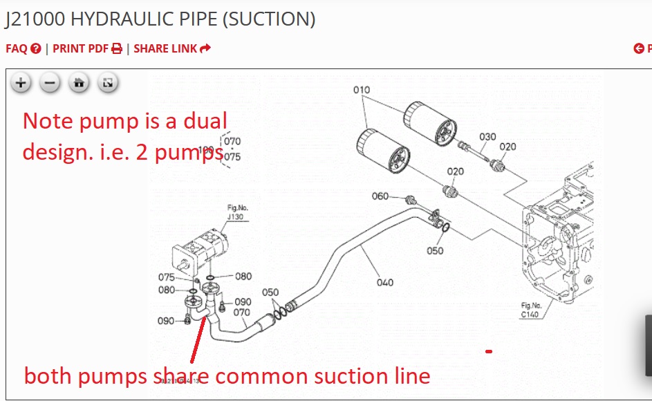

Please note that your system has a dual or tandem pump. This is two pumps in one body.
Both pumps share a common suction line. The fact that two systems on your tractor are acting up emphasizes the advice from Lugbolt.
The power steering will be one of the pumps and the 3 pt hitch the other.
You cannot see a suction leak. Replacing all O rings, #80 & #50 plus checking metal pipe for cracks or physical damage would be wise.
