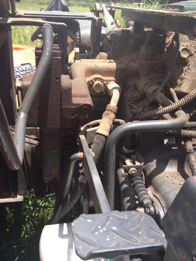

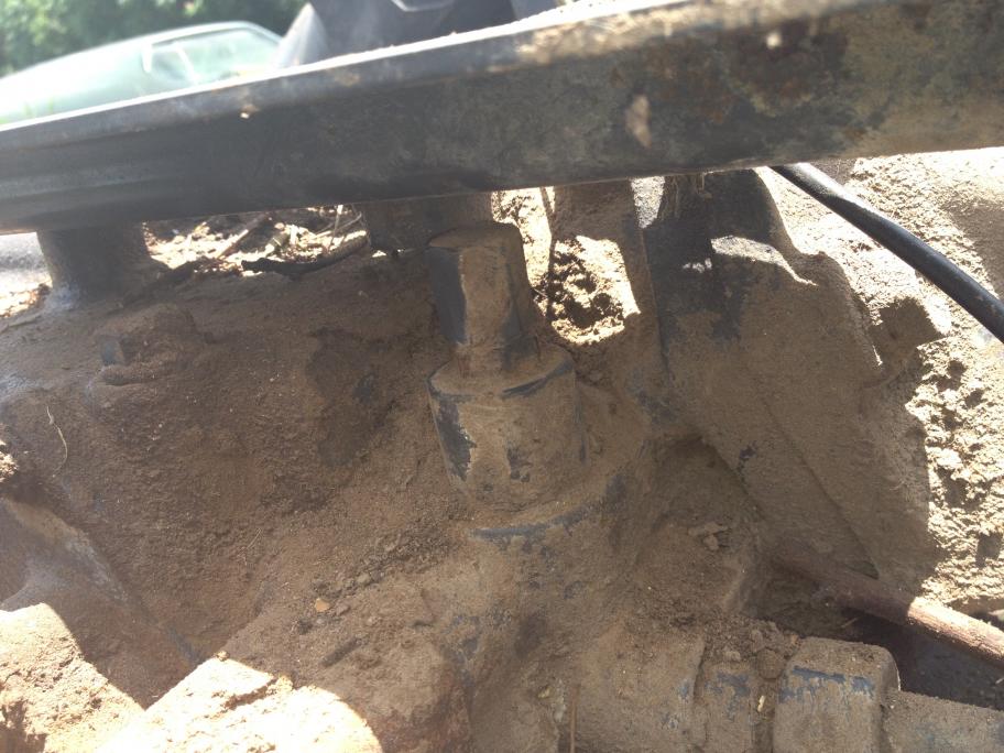

do I pull off both of the blocks in the pics? what is that plug? or what not in the second picture is that something I need to clean? Im fixing to wash all this down before I proceed and go from there.... are there any specialty tools needed to disassemble those blocks?

Pump was trashed, over pressured and extreme heat is what they said caused the failure. I have another pump on the way. In the mean time I found two pressure relief valves under the seat. I disassembled them and cleaned them etc, however, they were not dirty at all. everything looked brand new. I drained what was left of the hydraulic fluid (it was clean as a pin). Removed the filters and they looked good as well. Blew out the lines with compressed air. Is there anything else I can or should do before installing the new pump so as to try to prevent this from happening again? I cant afford to ruin another 1500.00 pump.

I'd be putting a pressure gauge on the unit once the new pump is installed to make sure it's operating at the correct pressure. You want to make sure the pressure relief valves have not been modified or dialed up to too high a pressure.
