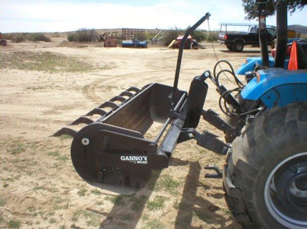

To start with, if you actually want the box blade to work in pretty much any condition, don't even consider anything less than 1000lbs plus or minus a few lbs. A good width for your tractor would be something in the 78"-84" range.
Anything that fits in this description is going to cost some $$$$, not in the $1000-$1500 range.
The ideal unit would be a Gannon similar to this.

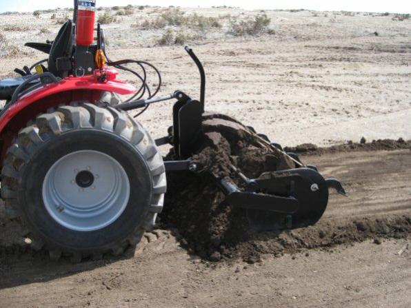

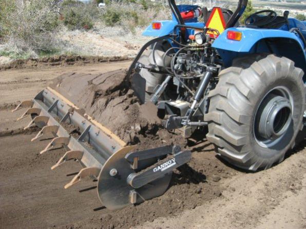

TripleR mentioned a roll over box blade or (ROBB). These are also a very good alternative. I happen to use a 65" & 81" Gannon ROBBs with my tractors. Unfortunately Gannon discontinued their ROBBs a few years ago. :(
Something else to consider is a top & tilt set for your tractor. This is a HUGE help in getting the most out of your grading implements.
