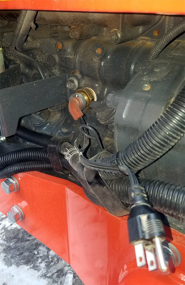

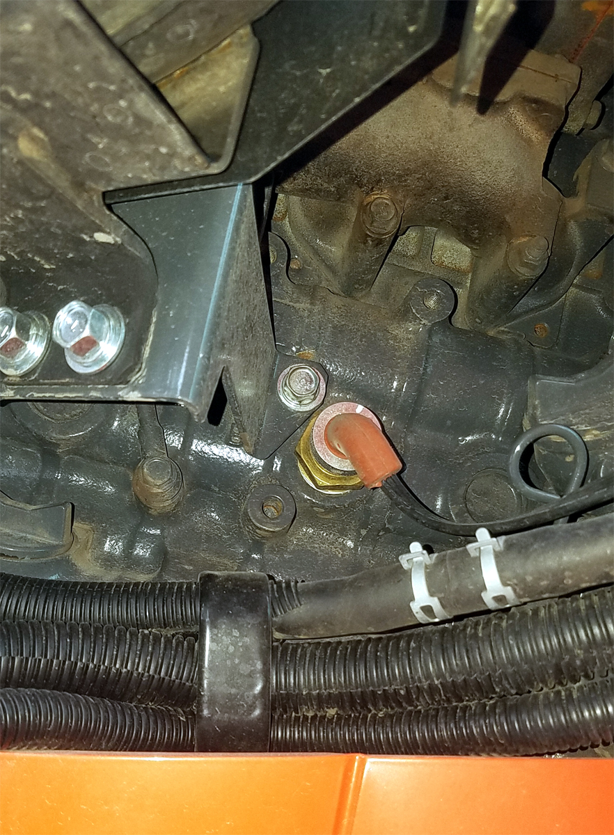

Howdy,
I purchased a block heater for my M5-111 and the instructions that came with it are not helpful. Can anyone point me to the location on the engine? It is a threaded one of that helps.
Thank you
Erik
7,577
10,501
I took a few photos of the locations of the block heaters on my M6060 and MX6000. This might be no help at all since neither are an M5-111, but both are four cylinder engines, and the block heaters thread into ports on the left side of the engine near to the cab i.e. towards the rear of the engine. Up here all tractors come with block heaters installed, based on the four tractors I've purchased anyway. But I do know that the local dealer has them in all new tractors that they sell.
M6060
MX6000
Ehughes2017
M5-111
Dec 10, 2022
Colorado
M6060
MX6000
Thank you I will take a look. I called two different Kubota's today and received two different answers- one said left the other said right side. I just need to look for the one plug that has a Hex hole.
