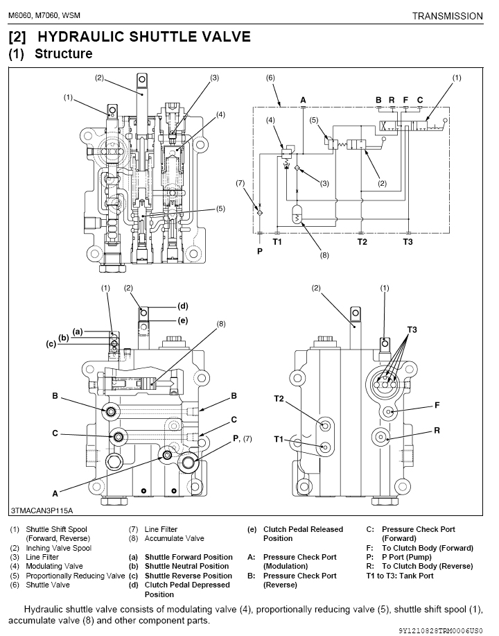

Since the hydraulic shuttle is working, and both the clutch pedal and hydraulic shuttle are connected to the hydraulic shuttle valve, you might also look at the clutch cable and associated linkage. The image below is from the M6060/M7060 WSM and I would expect the M4 to be similar.

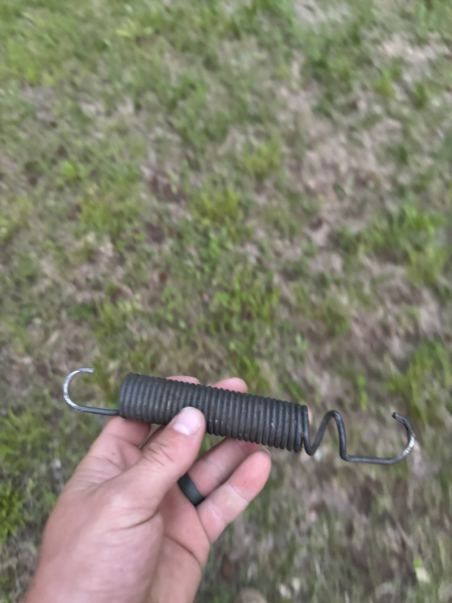

Well I may have gotten lucky. Went back and traced where it happened and found the spring laying on the ground. So hopefully this is the only culprit.
