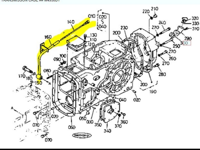

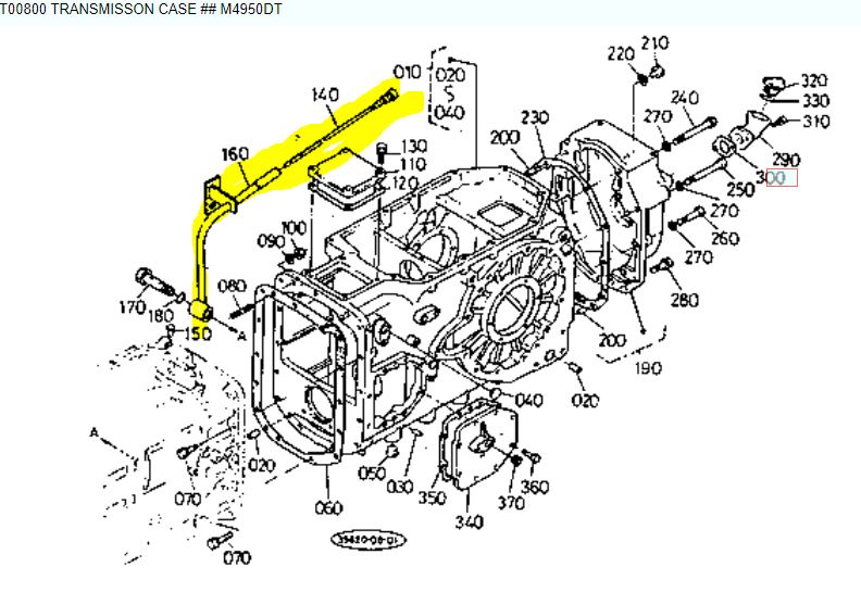

I thought that was the dipstick but I was confused because there is a cap to fill under the seat and then by your diagram it shows part #290. That’s a fill also? I was confused by having 2 places for filling

What if the entire dipstick arrangement is not there?(140,150,160,170,180)
How would I check oil level?
