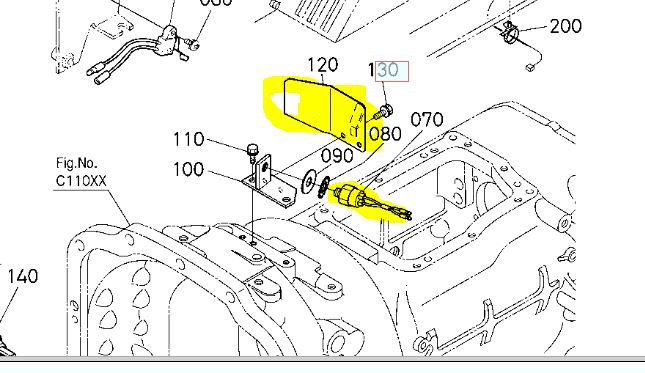

M4900 is at farm 500 miles away. The Shuttle Safety Switch (,Lever part 3A011-75100, $50) is 20 years old and causing no start issues.
Found a thread here by Jayste that describes rough ("hitchiness")shifting of the shuttle lever that I have am experiencing with my 4900 and plan to change this switch next trip.
I understand that this switch is located near the shuttle lever - can anyone advise exact location of the switch and what parts/cowling pieces I should begin removing to get to the switch. Here is Jay's solution to the sticking shuttle lever as it may help others diagnose a no start issue:

Look below steering column, on just above the floor, looks like they have an access cover to get to the switch.

Picked up the switch (3A011-75100) $50 from dealer and a drawing showing switch location to be down on the side of the transmission under the shuttle shift rod of my M4900 SU 2wheel drive.
Jayste, also advised that switch could be accessed from below tractor and that in addition to a sticky switch, he had a stick lodged in shift rod mechanism. Should be a quick fix for me because of help from the Wolf and Jay. Thanks Fellas.
