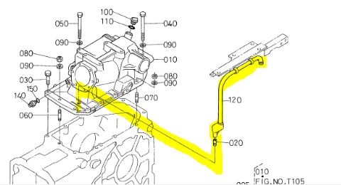

Ran my shredder on my M4700 a few hours, had hydraulic fluid come up from the gear shift cover. Thinking it’s the vent that may be clogged. I can’t find it and my repair manual never mentions it. Can anyone point me to where it is?

It's either in front or under the seat bracket.

Looks like it in just under the front edge of the seat on the left side then routed up to the seat mount rail and towards the rear of the tractor.
