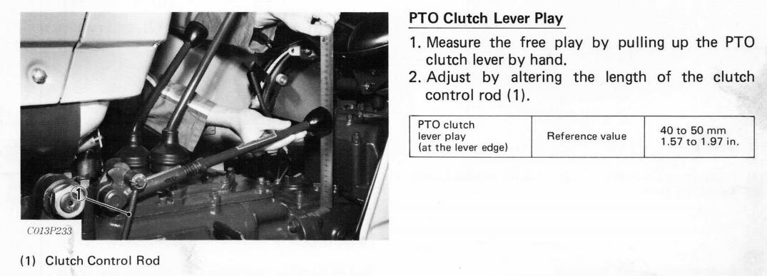

Welcome to the forum.
A neighbour has an M4050DT, and the PTO clutch lever/engagement system looks exactly the same as my M4500DT. Here's how the M4500DT manual says to do it.
Hope this works for you - let us know.
Sorry to resurrect such an old thread.
I just got a m4500dt and had a similar issue with some grinding when I'm shifting PTO lever into "Live". I tried it about 4 times. It did go into "Live" and the PTO started turning and there was no more grinding. There was no grinding when shifting it to "Ground".
My PTO clutch lever pulls up a LOT further than 40-50mm. Does that mean it needs adjusting to shorten the control rod?

The PTO clutch lever should have about 1" to 1 1/2" of free play. If it has too much or too little adjust the linkage. When the PTO is not in use you want to disengage the PTO shift lever. Put it in neutral and put the PTO clutch lever down.

I adjusted the PTO lever so the free play was within reference values. Unfortunately it still grinds briefly while pushing the PTO gear lever to "Live", after leaving the PTO clutch lever up for about a minute.
Does that mean the problem is elsewhere?
